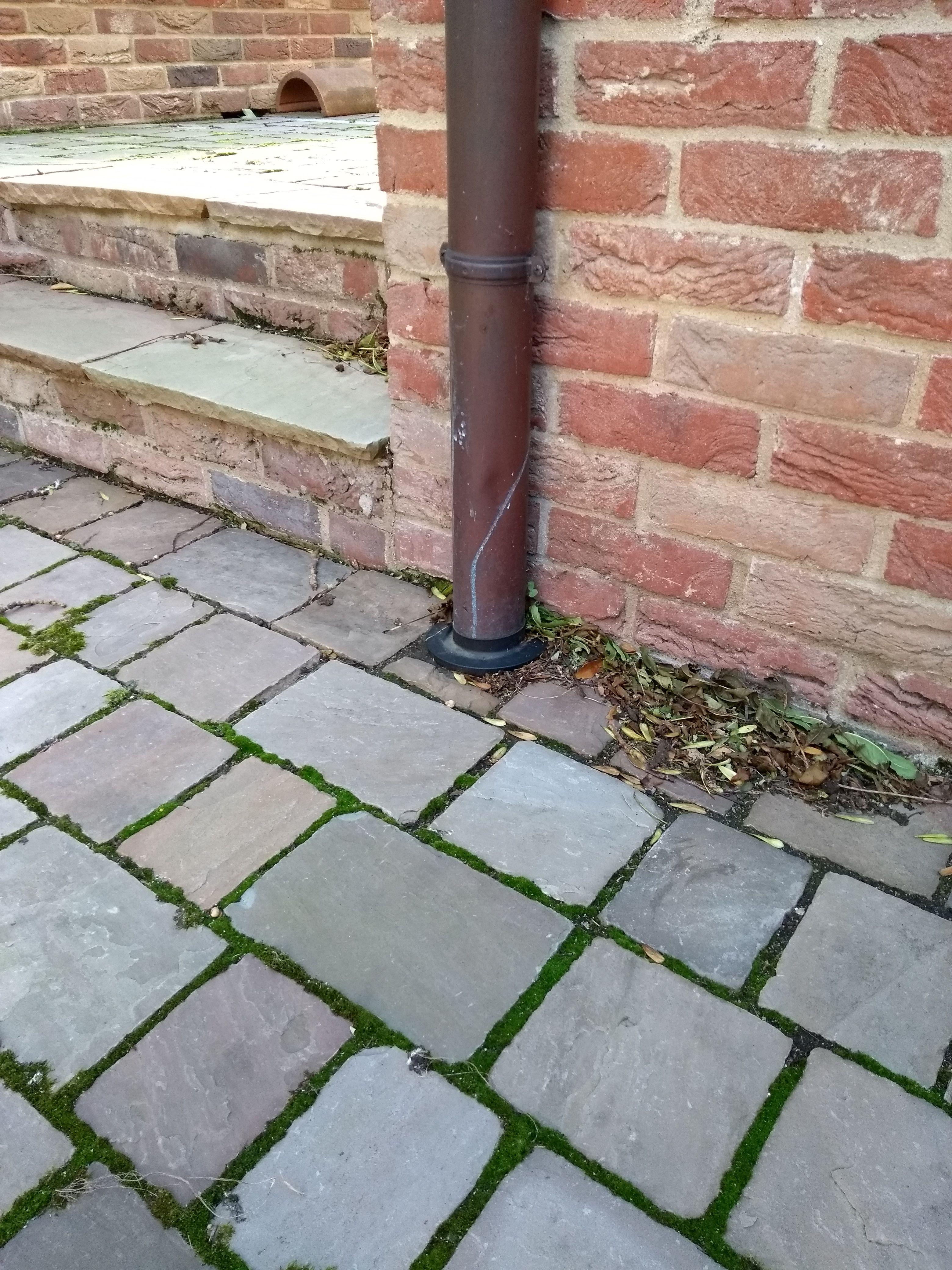

Triassic Posted August 26, 2020 Share Posted August 26, 2020 I need to fit down spouts and rainwater pipes. I’m running the 110mm rainwater pipes away from the building and into Soakaways, all straight forward and easy to install. What I’m not sure about is the gully the downspouts discharges into. Should these be a simple plastic grid type, with a shoe on the end of the down pipe, or should the downspout go directly into the gully? Thoughts, pictures, best practice ideas most welcome. Link to comment Share on other sites More sharing options...
Temp Posted August 26, 2020 Share Posted August 26, 2020 Our rainwater down pipes are 80mm and the drains 110mm. We didn't want gullies and ended up using rubber adaptors that connect the two and stop stones entering. We have never needed access for rodding but could remove the lower section of 80mm down pipe if necessary. Link to comment Share on other sites More sharing options...

Temp Posted August 26, 2020 Share Posted August 26, 2020 1 hour ago, LA3222 said: seeing @Temp post made me think why bother with gullys? Just put a 90 degree bend at the bottom? I'm running my rainwater to a harvesting tank which will have a silt trap and the gutters will have leaf protectors - food for thought. That's what we have, just 90 degree bends with a short length of 110mm up to ground level. 80mm down pipe fits inside with the rubber boot covering the gap. Needed to use plumbers lube to get the rubbers in place on the down pipes but seems to work fine for us. Sorry I can't remember where we got the rubbers. We do have a filter that stops leaves getting into the rainwater tank but no silt trap. The tank is just for garden and car use so not an issue. Quite a lot of silt in the tank after 13 years. Link to comment Share on other sites More sharing options...
Triassic Posted August 26, 2020 Author Share Posted August 26, 2020 Thanks all for the input. I’m going to pipe my downspouts directly into The 65mm twin wall pipe and run these to a dry brick constructed soak away chamber. I’ll cover each one with a small paving slab, if I then have problems with silt I can uncover the slab and clean the chamber. With the amount of rainwater we’re getting, sometimes in huge deluges, I’m considering a French drain around the house to keep the foundations dry. Is this something anyone else has done? Link to comment Share on other sites More sharing options...
