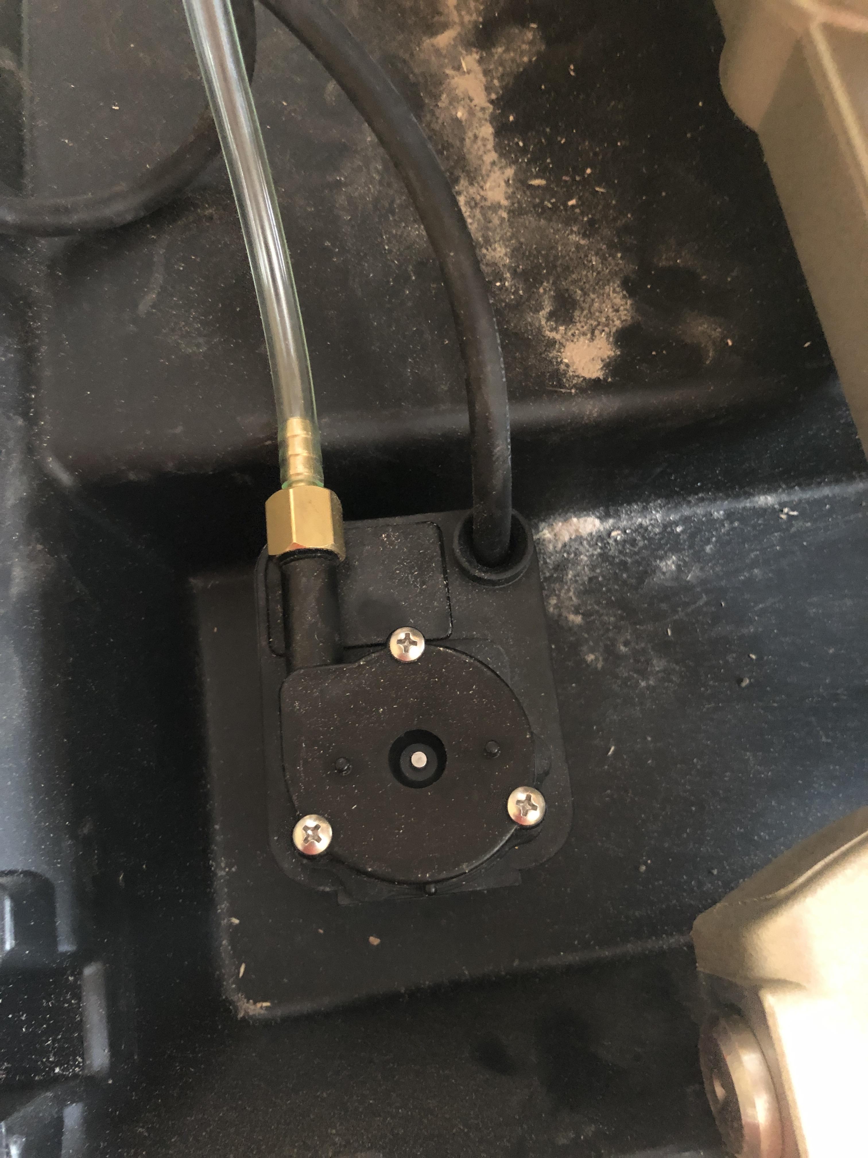

Pocster Posted August 25, 2020 Share Posted August 25, 2020 (edited) It’s a bloody beast !!! Some questions ! The pump unit does it really just sit in there ? some bits left over ... errrrm , they look important!! Edited August 25, 2020 by pocster Link to comment Share on other sites More sharing options...
Reiver Posted August 25, 2020 Share Posted August 25, 2020 They look like the clamping bits for the blade. And yes, on such things the pump does often just lurk in the bottom of the coolant sump - I presume it has a filter on it? Link to comment Share on other sites More sharing options...

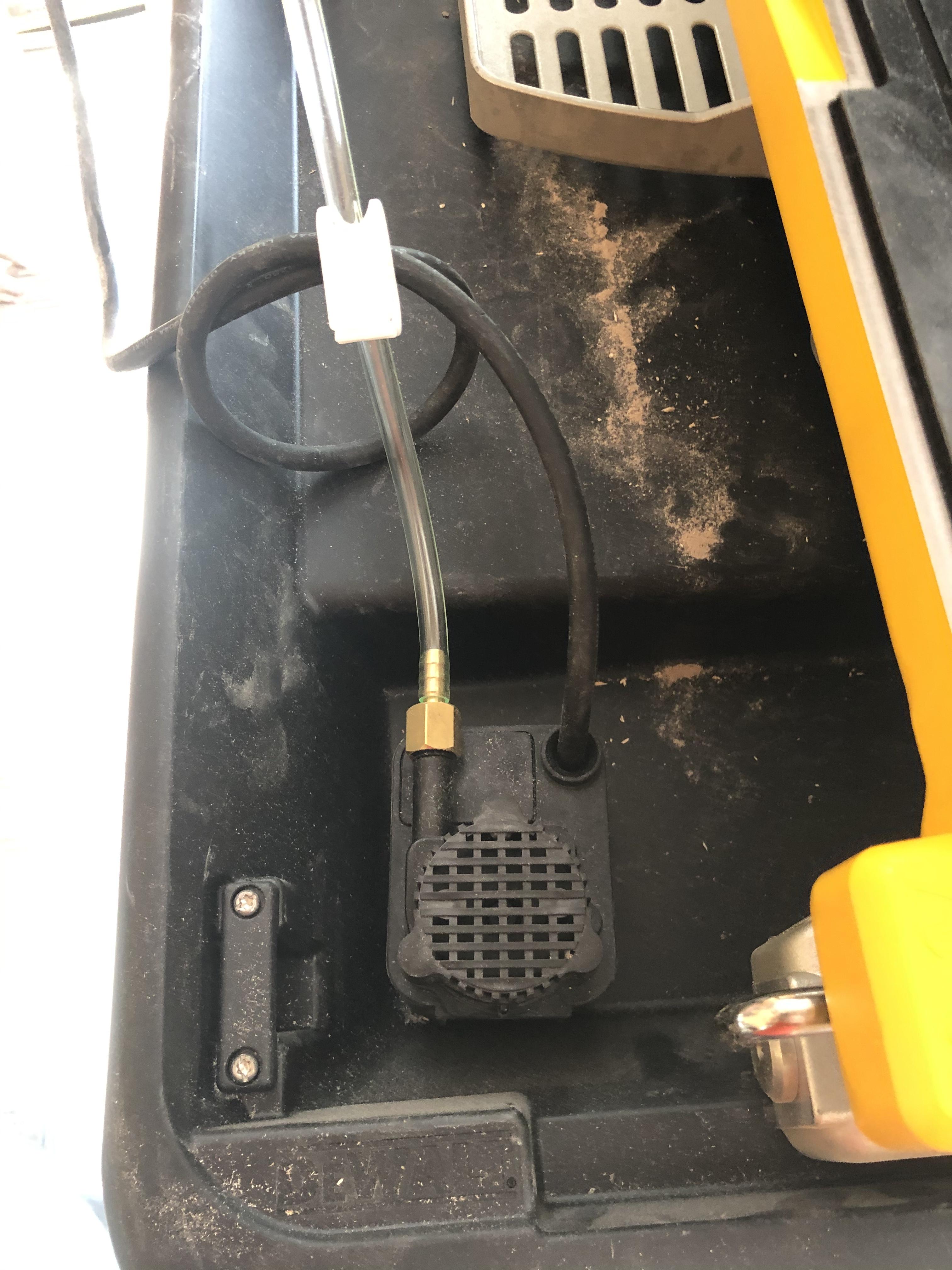

Pocster Posted August 25, 2020 Author Share Posted August 25, 2020 8 minutes ago, Reiver said: They look like the clamping bits for the blade. And yes, on such things the pump does often just lurk in the bottom of the coolant sump - I presume it has a filter on it? I checked various videos . There’s a clamp already on the blade so assume they are for a smaller blade . The pump confuses me - see photos ... The only holes appear to be those 2 tiny ones on the underside Link to comment Share on other sites More sharing options...
markc Posted August 25, 2020 Share Posted August 25, 2020 the pumps need to be removed and cleared regularly so they do just sit around loose in the bottom Link to comment Share on other sites More sharing options...
Pocster Posted August 25, 2020 Author Share Posted August 25, 2020 4 minutes ago, markc said: the pumps need to be removed and cleared regularly so they do just sit around loose in the bottom Just seems the holes are dead tiny . Any grit tile debris you can see blocking that easily ! Link to comment Share on other sites More sharing options...
markc Posted August 25, 2020 Share Posted August 25, 2020 Just now, pocster said: Just seems the holes are dead tiny . Any grit tile debris you can see blocking that easily ! The water must enter through the grill ... also makes sense for the impeller. I did find it odd looking that the cable came out from the same side preventing it sitting on the pipe and grill. I would sit it on its end and keep the grill under water level. Failing that, fold the cable over and tape down to allow the pump to sit impeller?pipe downwards. probably need a weight too ... i have a different machine with suckers on the pump but it still floats around like a deranged fish 1 Link to comment Share on other sites More sharing options...
PeterW Posted August 25, 2020 Share Posted August 25, 2020 Have you tried to RTFM..?? Pump needs to be covered by water - you fill the tank more than you think. Check there isn’t a sponge filter missing off the pump grille 2 Link to comment Share on other sites More sharing options...

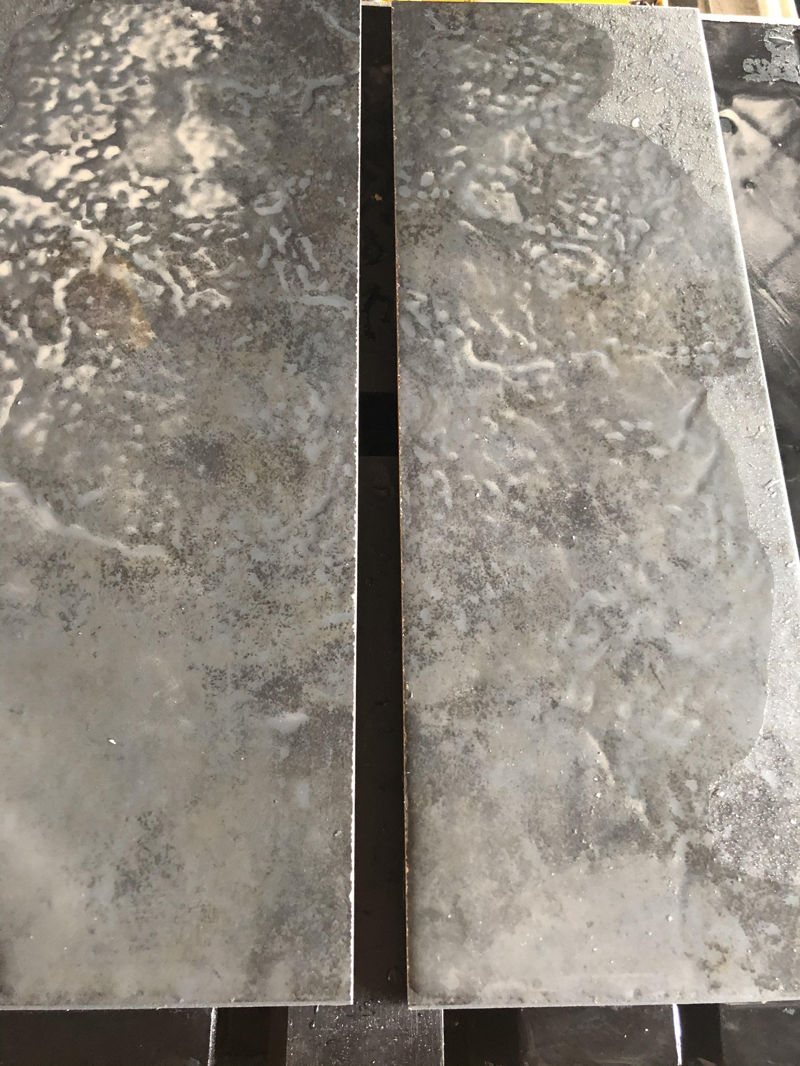

Pocster Posted August 25, 2020 Author Share Posted August 25, 2020 Placed pump face down Cuts seem good !! Link to comment Share on other sites More sharing options...

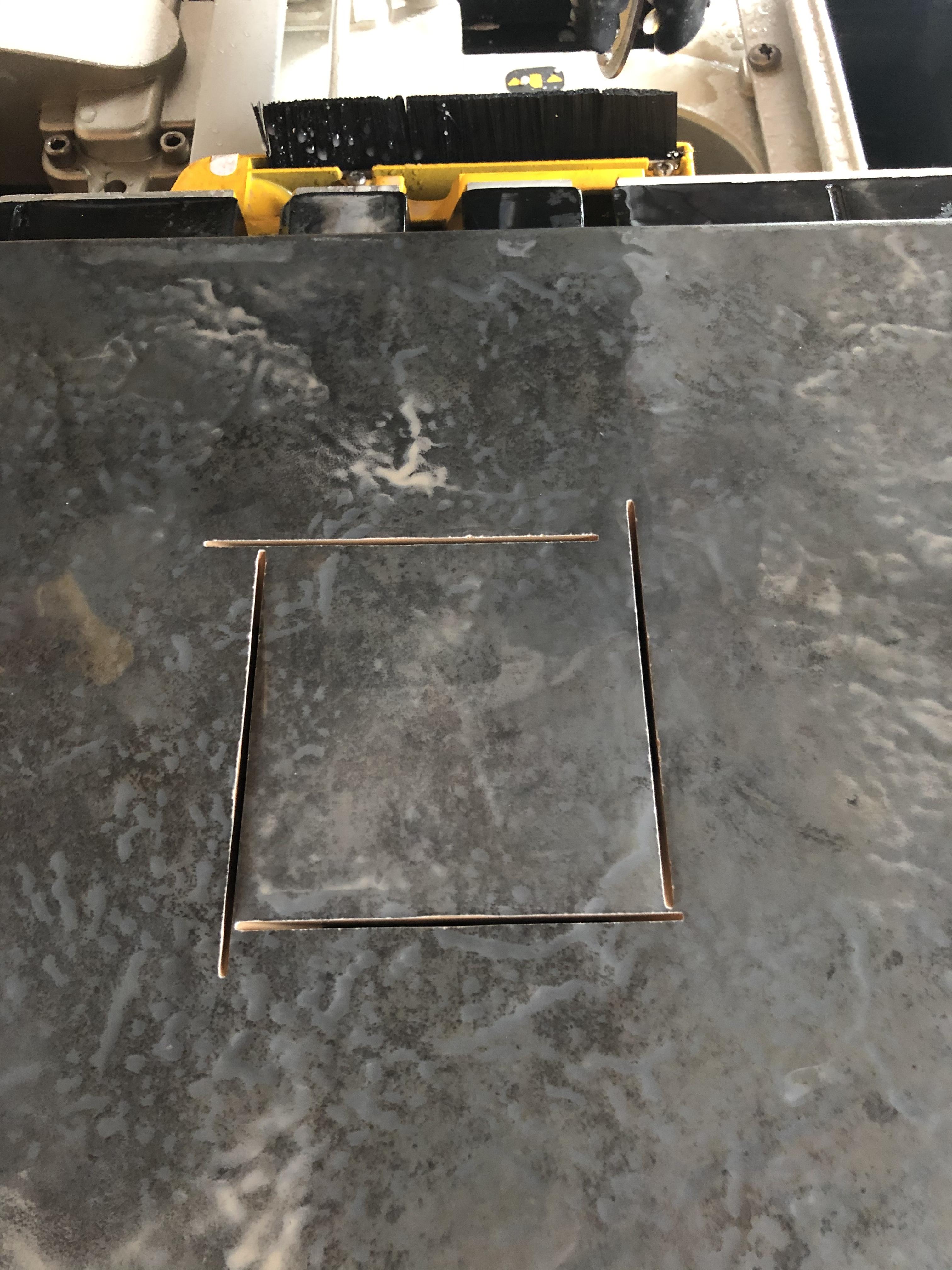

Pocster Posted August 25, 2020 Author Share Posted August 25, 2020 (edited) Sample plunge cut - yes I know I’ve over cut just checking the plunge . So much less mess than with a normal wet saw ! Edited August 25, 2020 by pocster Link to comment Share on other sites More sharing options...
Onoff Posted August 25, 2020 Share Posted August 25, 2020 10 minutes ago, pocster said: Placed pump face down Cuts seem good !! Chipped edges like that are always going to a problem with cheap ceramic tiles. Link to comment Share on other sites More sharing options...
Pocster Posted August 25, 2020 Author Share Posted August 25, 2020 Just now, Onoff said: Chipped edges like that are always going to a problem with cheap ceramic tiles. Yeah these are just some old b & q cheapy tiles . Find out with ‘real’ tiles later Link to comment Share on other sites More sharing options...

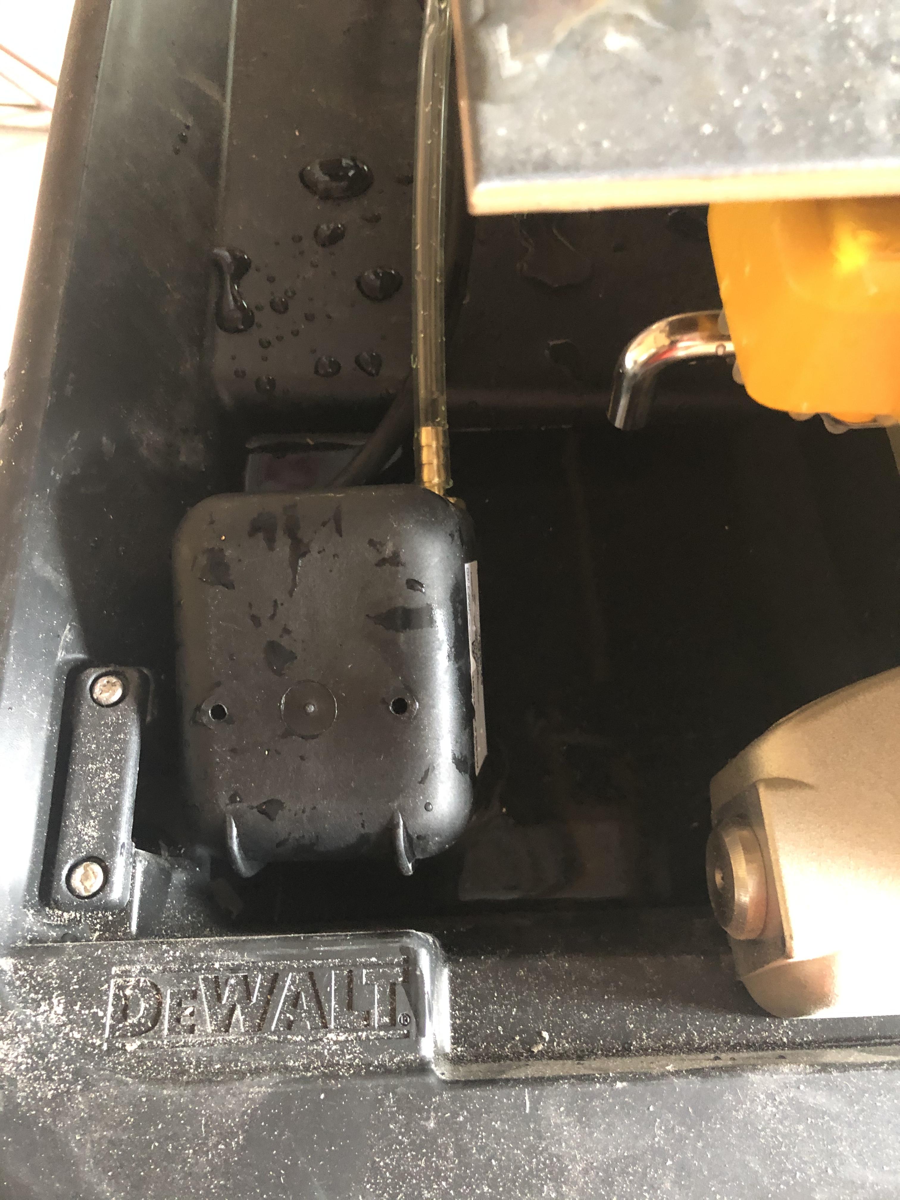

Reiver Posted August 26, 2020 Share Posted August 26, 2020 22 hours ago, pocster said: I checked various videos . There’s a clamp already on the blade so assume they are for a smaller blade . The pump confuses me - see photos ... The only holes appear to be those 2 tiny ones on the underside Yes, but the idea will be that the water enters the pump at the top (sump needs to be fairly full) to avoid picking up crap from the bottom. Link to comment Share on other sites More sharing options...

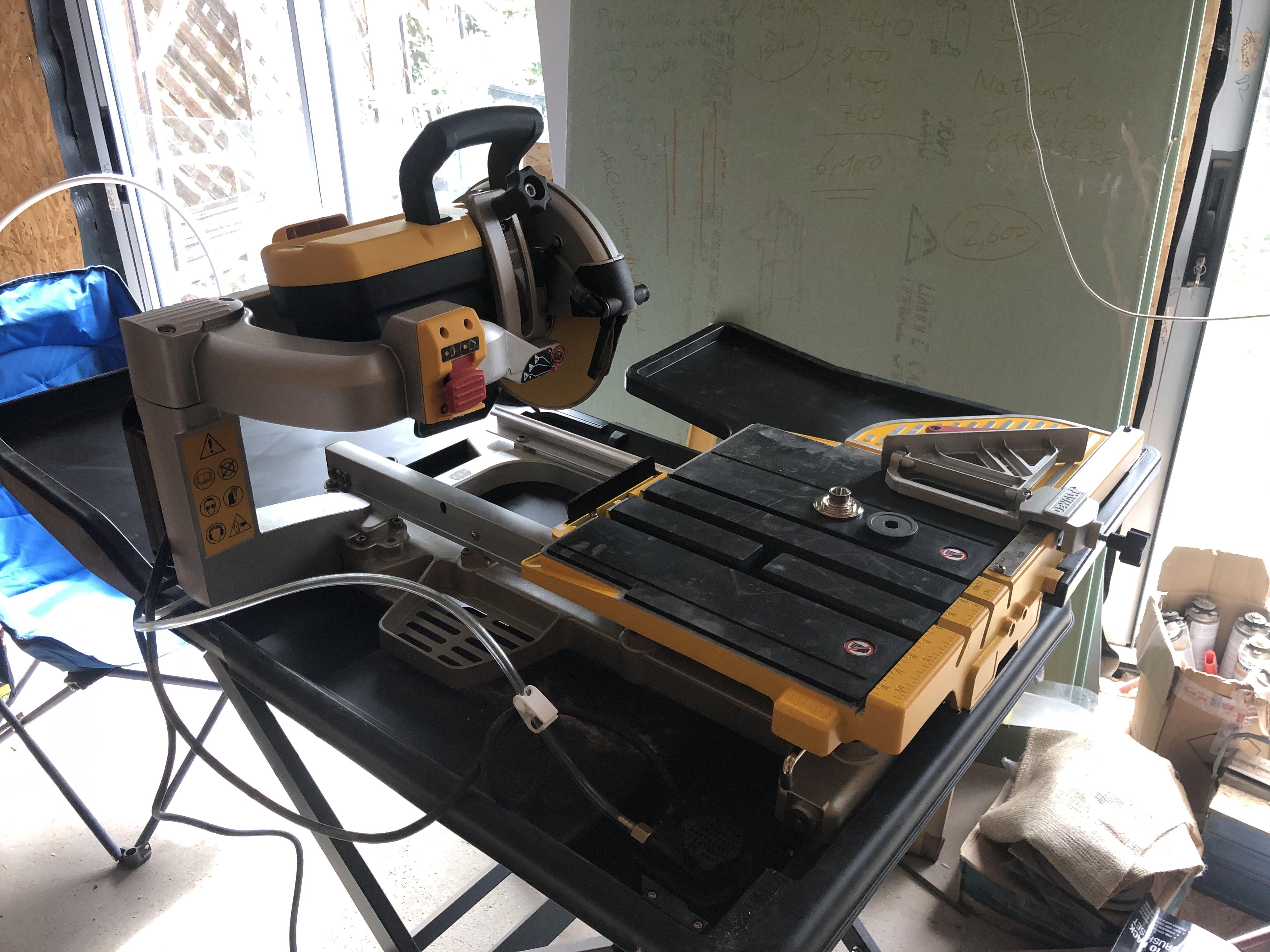

Pocster Posted August 27, 2020 Author Share Posted August 27, 2020 Ok , so done a few more cuts . The pump is funny - sometimes it wants to work standing up ; other times lying down . Strange there’s no proper ‘holder’ for it in the tray . So I always before a cut have to make sure I can see water at the blade . Things I do like . Almost zero mess . Zero wobble in the tray as you slide a tile in . I had to trim 2mm off a tile - it did it without breaking the off cut . Don’t think that would be possible on a ‘normal’ wet cutter . Nice big on/off button facing you - not hidden on the side . Sits nicely on the stand (d240001) - no back ache cutting . Good visibility as you cut - just look slightly off centre and can see blade cutting tile . Obviously I’m probably using about 10% of its ability . But it makes cutting less of a pita . Though it is a big beast - so only for big jobs ( like tiling an entire house ) . Tool for real men ?????? Link to comment Share on other sites More sharing options...
Mr Punter Posted August 27, 2020 Share Posted August 27, 2020 With the water pump you need to lie it sideways with the power cord upwards , similar to how you are holding it in the last picture. Link to comment Share on other sites More sharing options...
Pocster Posted August 27, 2020 Author Share Posted August 27, 2020 57 minutes ago, Mr Punter said: With the water pump you need to lie it sideways with the power cord upwards , similar to how you are holding it in the last picture. Yeah , sometimes it seems to like that . It’s like a woman . You can’t be quite sure what to do but you can bet it will be wrong . 2 Link to comment Share on other sites More sharing options...
