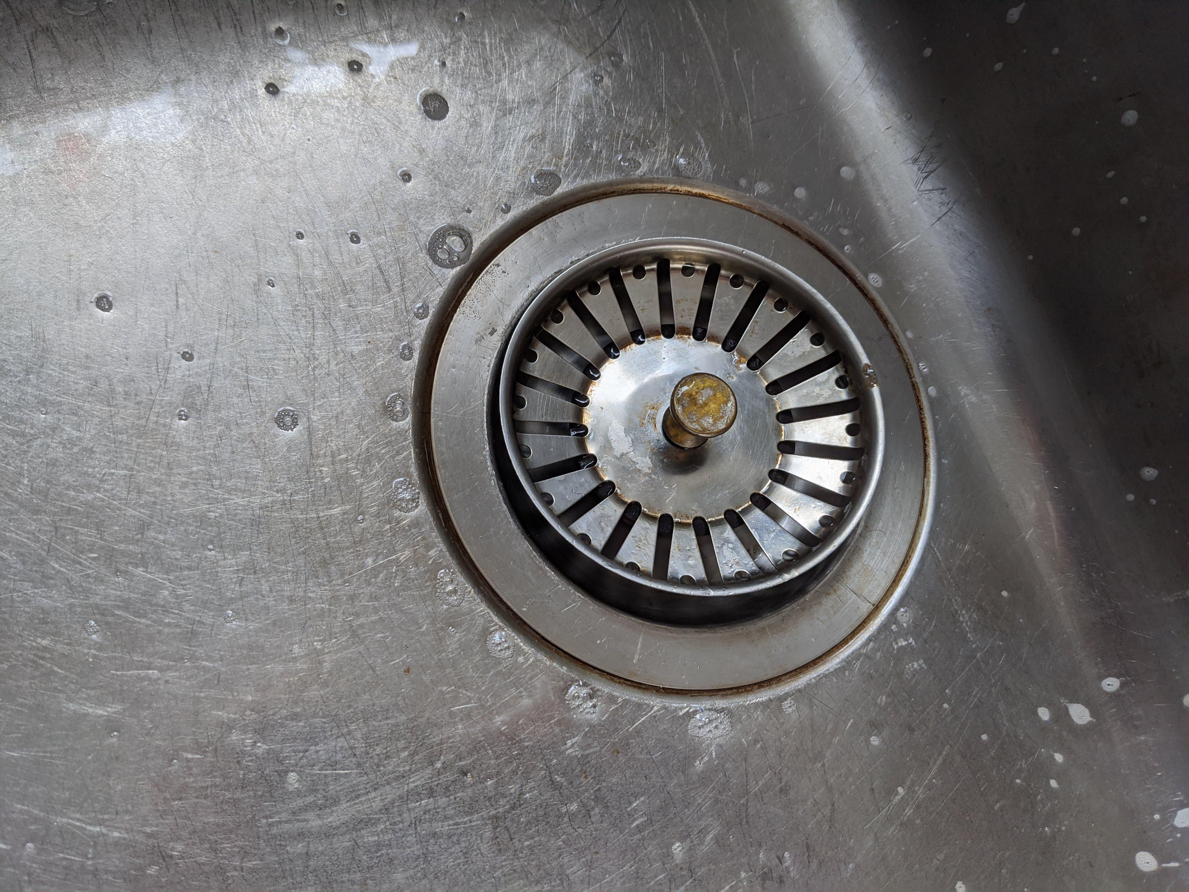

puntloos Posted August 23, 2020 Posted August 23, 2020 Vague title, sorry. TL;DR: Share your research on "common house components" in this sheet How many standard things have "good ones", where the "bad ones'" will only turn out bad when it's too late. Can we share the research? Tons of things have personal choice in there.. color of your kitchen doors, or features of your microwave. But in particular super common things, like e.g. "power sockets" probably have 200 brands, all roughly the same, but some are terrible (e.g. switches that die after 5x switching) and some are fine. Here's what prompted my question Can you tell this is a bad one? No? Well it is, it's in my new rental, the 'open' position is so elevated above the sink that it never actually drains water away from e.g. some vegetable scraps, it immediately gets pushed back in. And if you don't spot it this will bug you every time you clean your kitchen. (ok, well, it bugs me.) How about this - I've started a shared spreadsheet here I'd love to put things in here that "we all need at some point" when we're building. Simple stuff like power cable, sockets, faucets, downlights, hinges, windows, but if you're willing to share, please also tell us which ovens and hobs and fancier stuff you've chosen and why!
Temp Posted August 23, 2020 Posted August 23, 2020 (edited) Got one of those strainer plugs. They fall apart after a few years. As for the list: Dishwashers - Quite like Bosch appliances but our Bosch Dishwasher has had issues. The heating element is printed onto the outside of a steel cylinder. If just a little scale builds up on the inside the element overheats and fails right where the scale is. Had two go like this and our water is hard but not very hard. Problem is you can't just buy the element, got to buy a whole new pump assembly as well. Now we run weekly descaling cycles with vinegar to try and prevent it happening. Pocket Door - We also have an Eclisse pocket door which is ok. However I would avoid pocket doors in general where you intend to open and close it regularly (eg on a bathroom or WC). They are far too slow. Shower Door - I see its a bifold door. I would go with a standard door as there is one less gap and fewer hinges to go wrong. Network switch - Why such an expensive switch? Yes Cisco are good but 5 or 6 times the price? Edited August 23, 2020 by Temp
puntloos Posted August 23, 2020 Author Posted August 23, 2020 (edited) 1 hour ago, Temp said: Got one of those strainer plugs. They fall apart after a few years. We recently moved. A hassle, but it's been very helpful comparing and contrasting. Previous place's strainer plug worked pretty well, and much better than the current. And to be clear I don't think it's just the bit that you can pull out, it's also the hole it fits in. Current house's is very shallow. Not sure it matters. Quote As for the list: Dishwashers - Quite like Bosch appliances but our Bosch Dishwasher has had issues. The heating element is printed onto the outside of a steel cylinder. If just a little scale builds up on the inside the element overheats and fails right where the scale is. Had two go like this and our water is hard but not very hard. Problem is you can't just buy the element, got to buy a whole new pump assembly as well. Now we run weekly descaling cycles with vinegar to try and prevent it happening. Wow, that seems like poor design. Quote Pocket Door - We also have an Eclisse pocket door which is ok. However I would avoid pocket doors in general where you intend to open and close it regularly (eg on a bathroom or WC). They are far too slow. I was wondering about this. Another useful feature of new rental (to compare/eval) - it has pocket doors between living and kitchen. I must say I find it harder to open/close them than I expected, and they aren't even huge. maybe 1.7m wide. I was expecting a good system to allow opening and closing "with your pinky" so to speak, but especially the first 5cm takes a serious shove to get it going, not helped by the fact there are no good handles on it. There's one pocket door in my design that is probably going to be used daily - our master bedroom. (see here for a reminder) - the reason for it is that it 'effectively' adds the walk-in to the master bedroom, so master feels more spacious, yet when closed you can quietly, and with light, get dressed/undressed. Also, I hope/imagine the pocket door can be opened fairly quietly But indeed, I think I need to get the absolute best quality pocket door mechanism I can find. Elisse might be 'ok' but perhaps I need like fancy swiss engineering precision or somesuch.. Quote Shower Door - I see its a bifold door. I would go with a standard door as there is one less gap and fewer hinges to go wrong. Good point, this one is mainly intended for space saving. Quote Network switch - Why such an expensive switch? Yes Cisco are good but 5 or 6 times the price? You would think but on ebay, they go for 250-ish quid if you have some patience. And as the heart of a future-proof network, you'd want something that can really *sustain* gigabit from anywhere to anywhere. Most "gigabit switches" can connect one machine to another and maintain that gigabit, but add one more link (a second pair of devices starting to try and talk) and most cheap switches will drop to 500Mbps. Not to mention the power-over-ethernet part, which allows you to do wired cameras and other devices without a power socket Edited August 23, 2020 by puntloos
