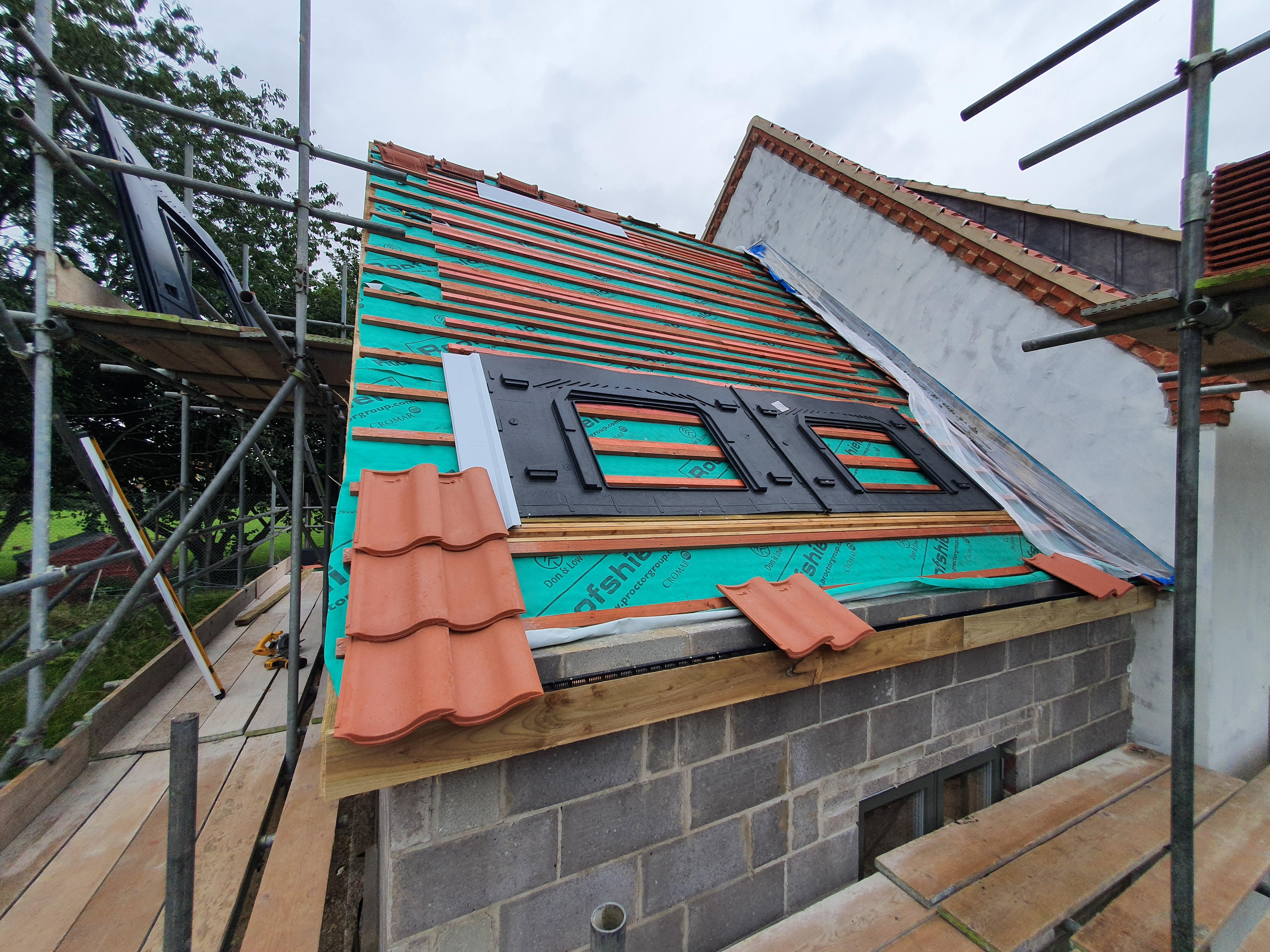

dnb Posted August 19, 2020 Share Posted August 19, 2020 I am curious as to what size battening people have used for their GSE in roof PV installations. I think mine needs to be 100x25 according to the GSE manual. But there is no further guidance on strength etc. Link to comment Share on other sites More sharing options...
LA3222 Posted August 19, 2020 Share Posted August 19, 2020 I used 38x50 - roofing battens!! 1 Link to comment Share on other sites More sharing options...
NSS Posted August 19, 2020 Share Posted August 19, 2020 56 minutes ago, LA3222 said: I used 38x50 - roofing battens!! Ditto, but doubled up (so 100 x 38). 1 Link to comment Share on other sites More sharing options...
willbish Posted August 19, 2020 Share Posted August 19, 2020 25x50 but doubled up where necessary. I found the GSE instructions unnecessarily complicated with regard to batten spacing. If I remember correctly, the only figure you really need is the 'additional line' which differs depending on which size panels you have. Lay down extra battens if the mount fixings are unlucky enough to miss a batten. 1 Link to comment Share on other sites More sharing options...
ToughButterCup Posted August 19, 2020 Share Posted August 19, 2020 25 by 50, doubled in one or two places.... The blue ones, not the knotty sort. 1 Link to comment Share on other sites More sharing options...
dpmiller Posted August 19, 2020 Share Posted August 19, 2020 4x1 treated. 1 Link to comment Share on other sites More sharing options...

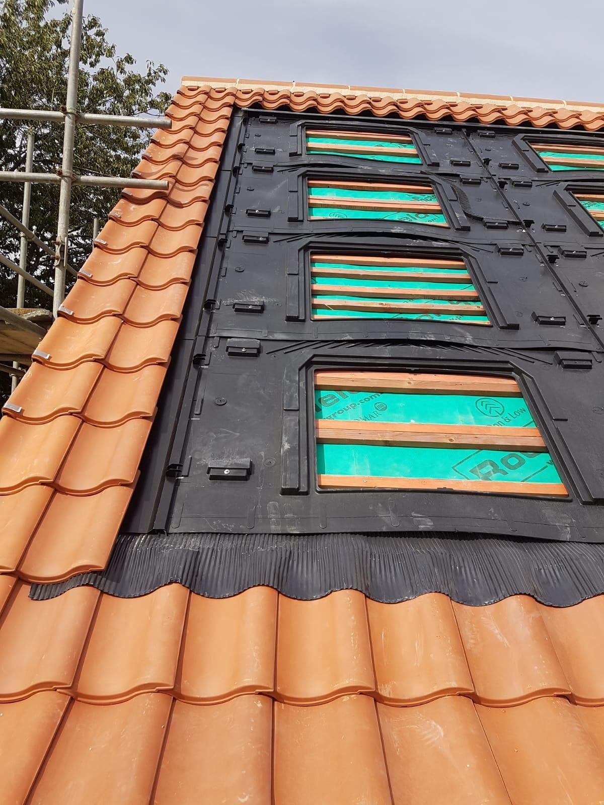

LA3222 Posted August 19, 2020 Share Posted August 19, 2020 This is how mine ended up looking: 1 Link to comment Share on other sites More sharing options...
dnb Posted August 19, 2020 Author Share Posted August 19, 2020 3 hours ago, willbish said: I found the GSE instructions unnecessarily complicated with regard to batten spacing. I thought it was me being thick! 3 hours ago, ToughButterCup said: The blue ones, not the knotty sort Good job I know where there is a big pile of those! 2 hours ago, dpmiller said: 4x1 treated. I assume that is in inches (unless it's a model house ? ) So 100x25mm - same as the GSE spec demands. Did you use any particular graded timber? 5 hours ago, NSS said: but doubled up Was hoping someone would say that! Thanks all. Looks like I can carry on with using my blue slate battens. Most of the time they are in more or less the right places. Link to comment Share on other sites More sharing options...
dpmiller Posted August 20, 2020 Share Posted August 20, 2020 6 hours ago, dnb said: I assume that is in inches (unless it's a model house ? ) So 100x25mm - same as the GSE spec demands. Did you use any particular graded timber? Nope, just the rough-sawn tanalised stuff from the local yard. While I *did* follow GSE's spec, it worth pointing out that a. the thickness needs to match your tiling battens and b. the wider the plank the easier it is to aim for... Link to comment Share on other sites More sharing options...
