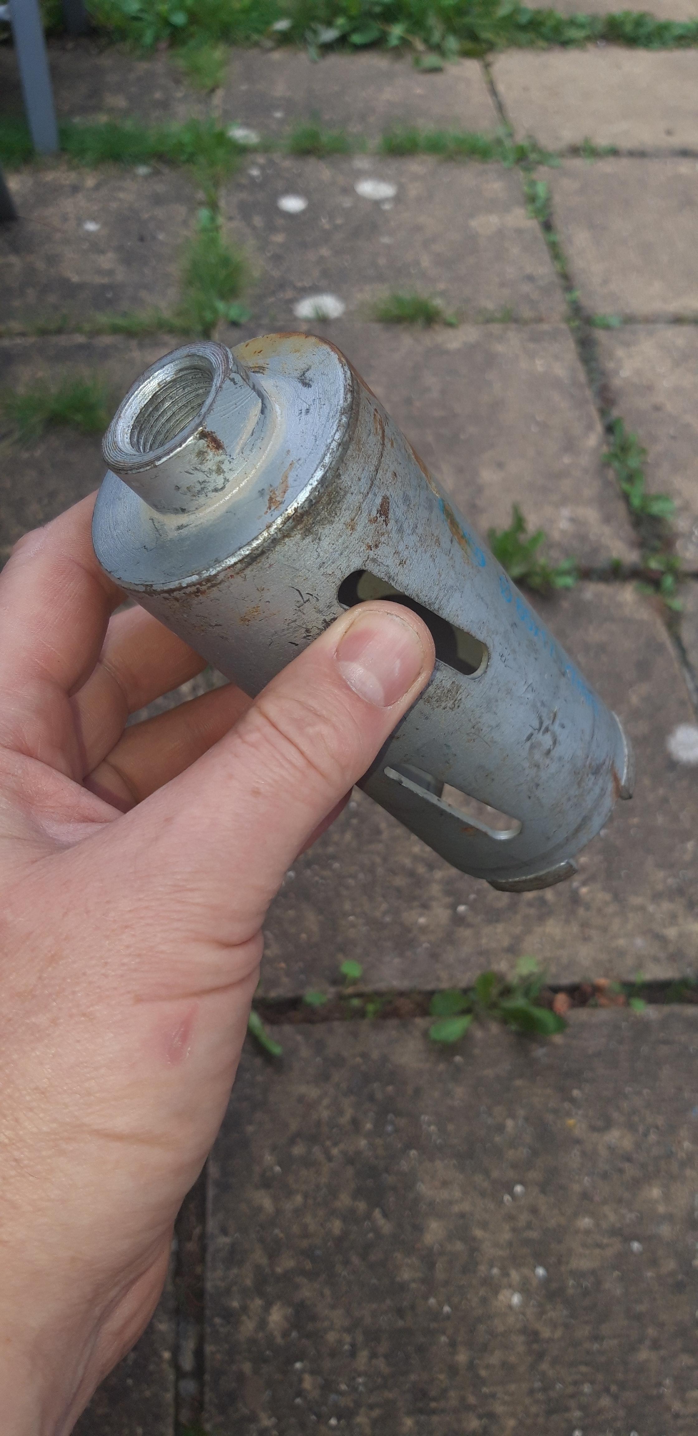

Onoff Posted August 16, 2020 Posted August 16, 2020 Anyone know what arbor will fit this Mexco core cutter. The thread is nom. M20 but finer than M20 coarse. I'm hoping it's one of these but there's no "try before you buy" now at TS / SF with this Covid thing! Take a chance I suppose https://www.toolstation.com/diamond-core-drill-sds-adaptor-pack/p79014?
Vijay Posted August 16, 2020 Posted August 16, 2020 you can just bring it back with Toolstation and get a refund or just bring the core cutter in store and try it, don't think the staff would care too much if you wanted to make sure it screwed in
Nickfromwales Posted August 16, 2020 Posted August 16, 2020 (edited) 42 minutes ago, Onoff said: Anyone know what arbor will fit this Mexco core cutter. The thread is nom. M20 but finer than M20 coarse. I'm hoping it's one of these but there's no "try before you buy" now at TS / SF with this Covid thing! Take a chance I suppose https://www.toolstation.com/diamond-core-drill-sds-adaptor-pack/p79014? Yup. It's the one that's compatible. Edited August 16, 2020 by Nickfromwales 1
Onoff Posted August 16, 2020 Author Posted August 16, 2020 14 minutes ago, Nickfromwales said: Yup. It's the one that's compatible. Ta. No.1 son has just surfaced so he can run me down to TS. First proper core cutter I've had this. Builders left it at a mates works along with a 125mm and another 65mm one.
Nickfromwales Posted August 16, 2020 Posted August 16, 2020 14 minutes ago, Onoff said: Ta. No.1 son has just surfaced so he can run me down to TS. First proper core cutter I've had this. Builders left it at a mates works along with a 125mm and another 65mm one. They’ll all use the same arbor.
Onoff Posted August 16, 2020 Author Posted August 16, 2020 That fits! ? Thinking I need a long extension though...

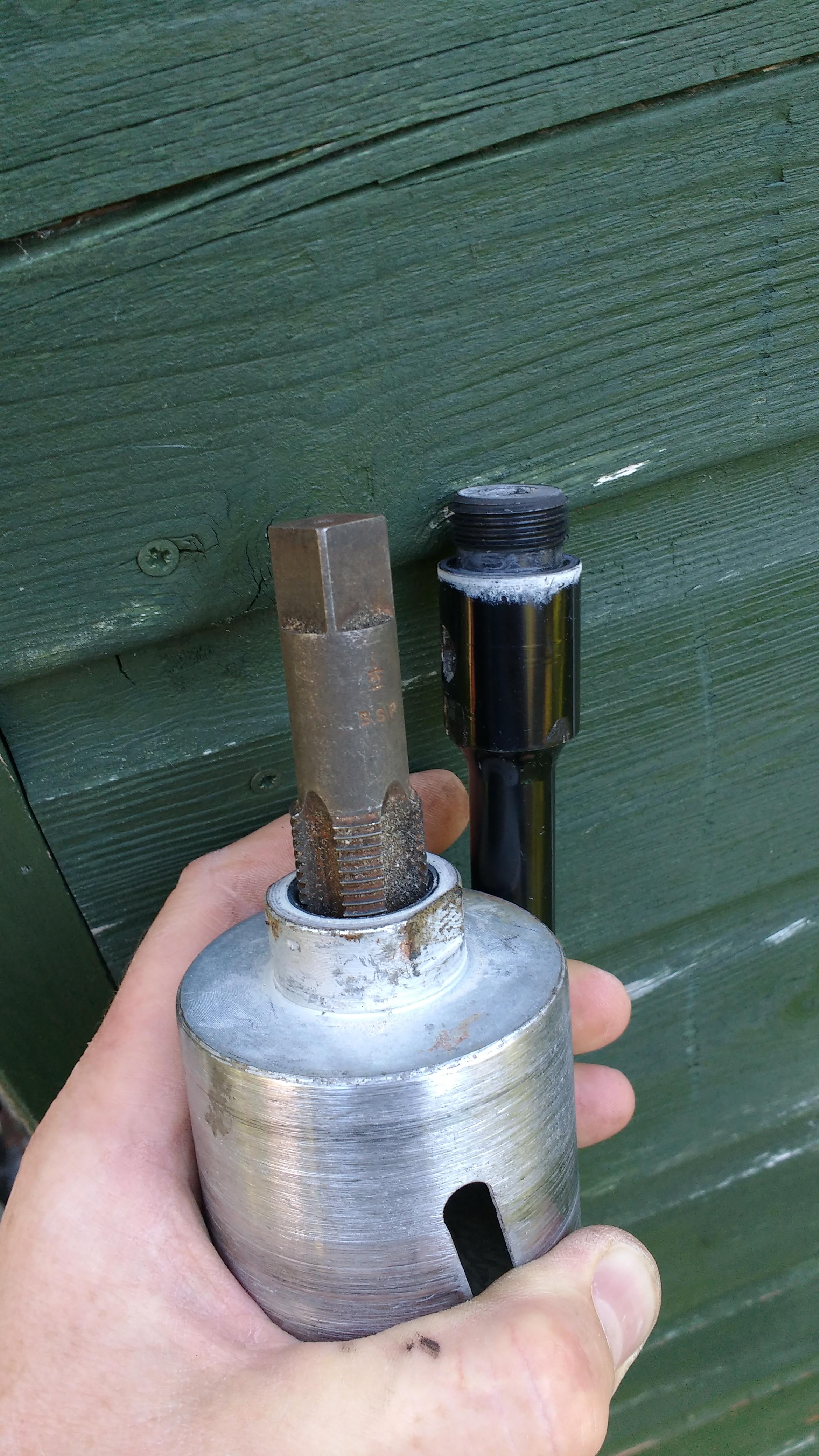

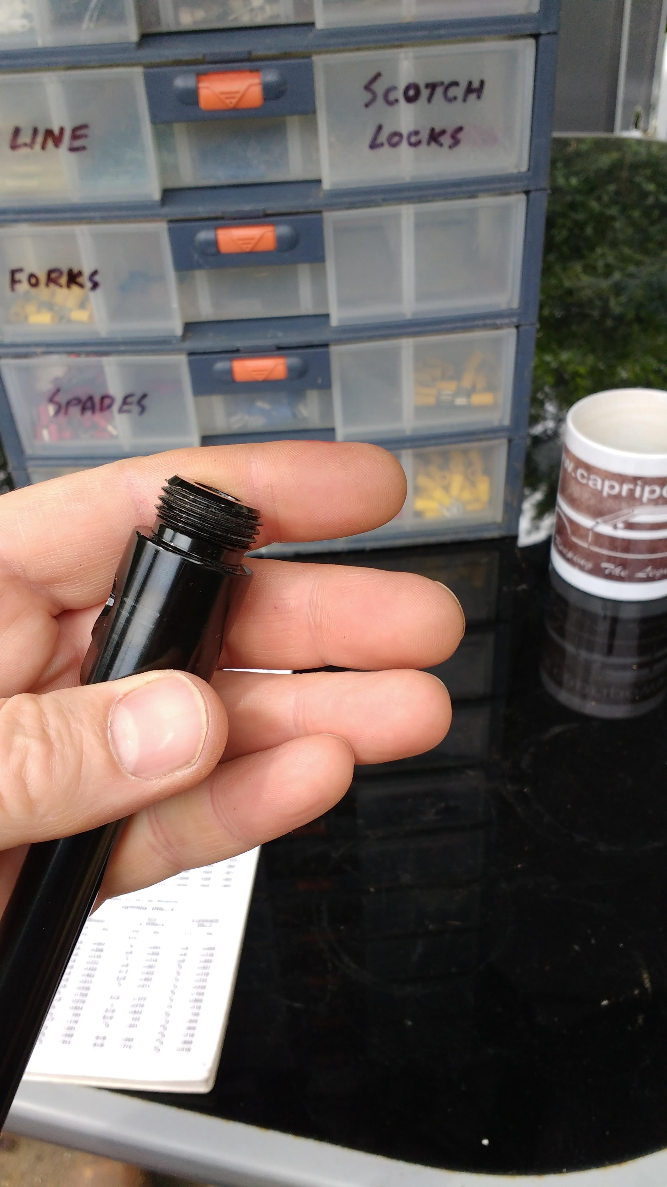

Onoff Posted August 18, 2020 Author Posted August 18, 2020 Trying to knock up a really long extension bar for this core cutter. in Outside dia of thread measures nom. 20.5mm. As for thread pitch, three threads cover nom. 5.5mm, 4 cover about 6.75mm. that's then about a 1.7 /. 1.8mm pitch. Can you get M20x1.75? M20 Metric coarse is 2.5mm, M20 electrical is 1.5mm pitch. Imperial maybe? 4 threads covering a 1/4" gives 16tpi and then the nom. 0.8' OD. I reckon 3/4-16 UNF. Sounds about right as Starrett arbours are UNF.

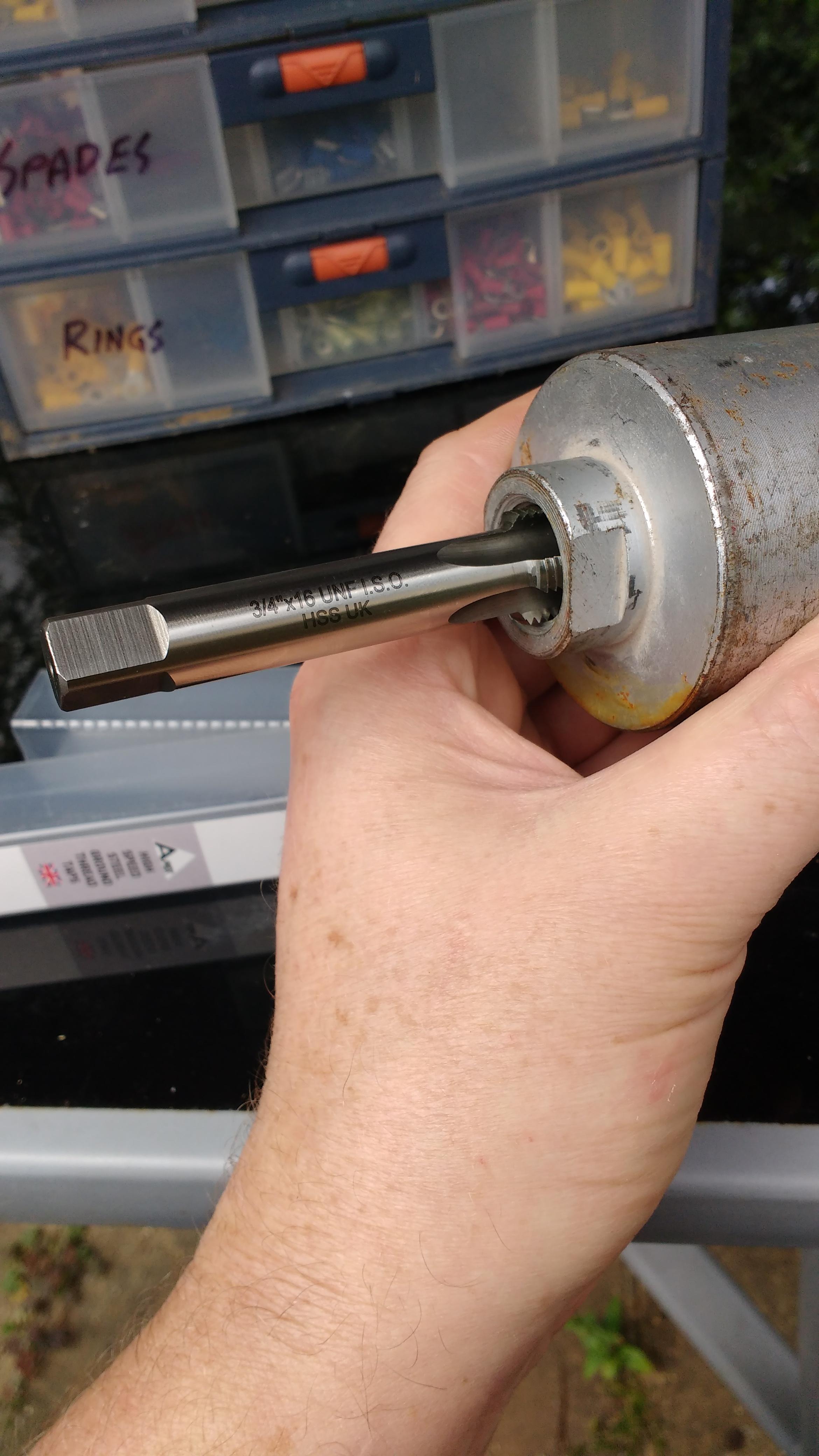

Onoff Posted August 18, 2020 Author Posted August 18, 2020 3/4"-16 UNF tap is a bit sloppy...or is it? Maybe it's meant to be to aid getting it apart on site? Looking down the bore of the core cutter and tbh the tap teeth don't seem to be lining up that well...

PeterW Posted August 18, 2020 Posted August 18, 2020 @Onoff1/2” BSP according to this which would match up with your dimensions as it’s 20.9mm and 14 TPI 1
Onoff Posted August 18, 2020 Author Posted August 18, 2020 1 hour ago, PeterW said: @Onoff1/2” BSP according to this which would match up with your dimensions as it’s 20.9mm and 14 TPI Cheers. I've a 1/2" BSP tap I think. Fingers crossed.

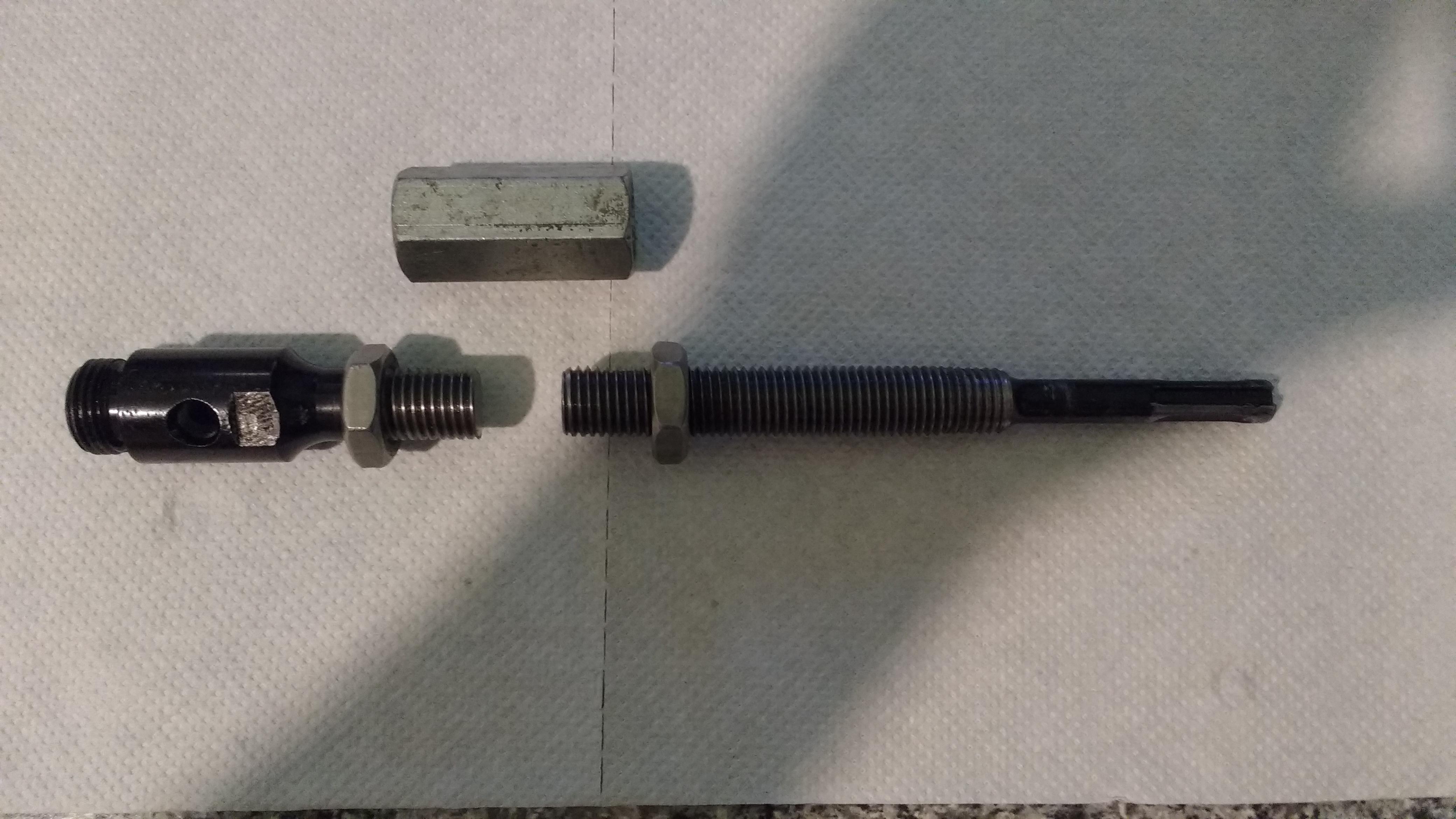

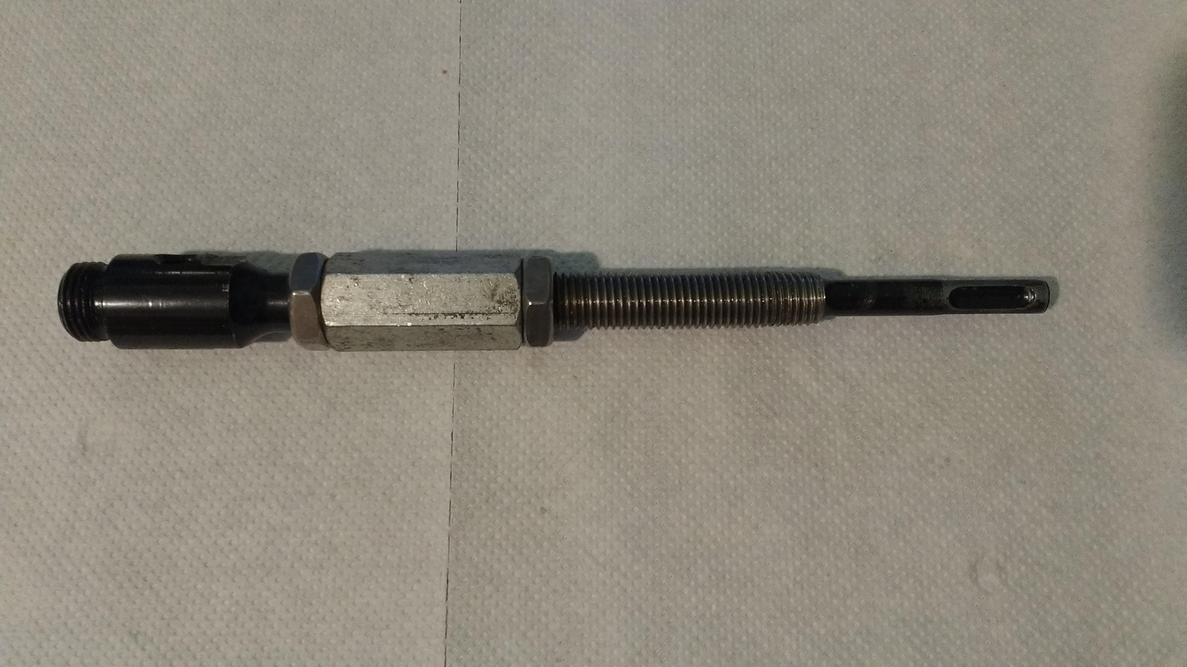

Onoff Posted August 18, 2020 Author Posted August 18, 2020 @PeterW wins tonight's (priceless) prize! It is indeed 1/2" BSP. I didn't even consider it as a possibility, I mean it's for "pipe"! I didn't even consider it with the Zeus book sat in front of me. Good to know. However, as the other adapter I made is M16 I did the same with this in the end. Fully threaded the arbour length & found a couple of stud extenders and half nuts:
