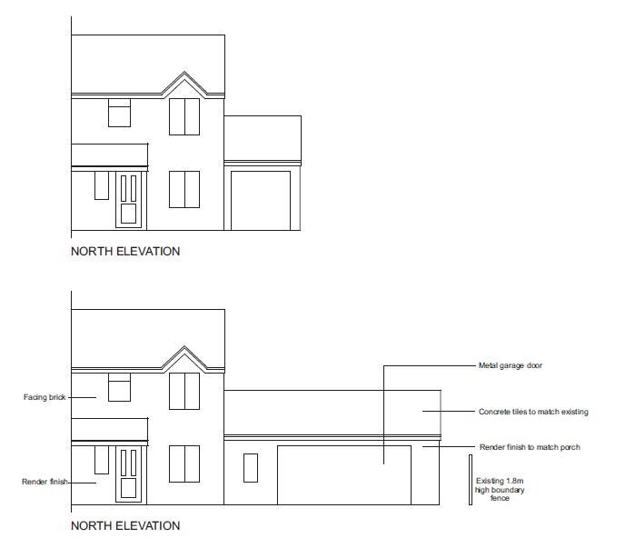

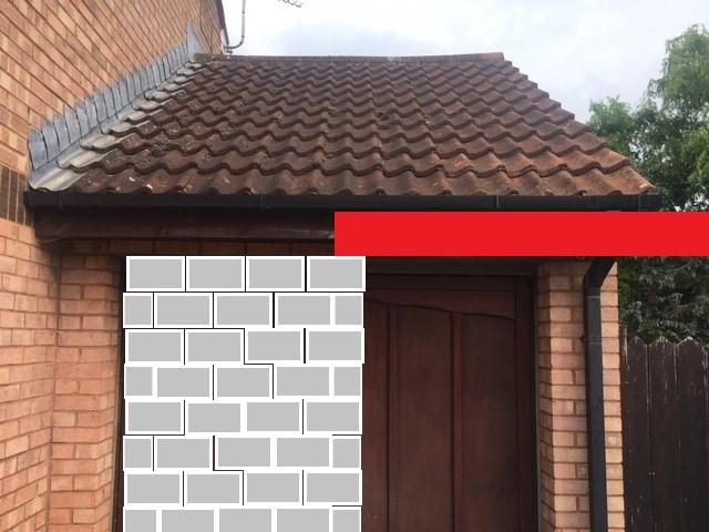

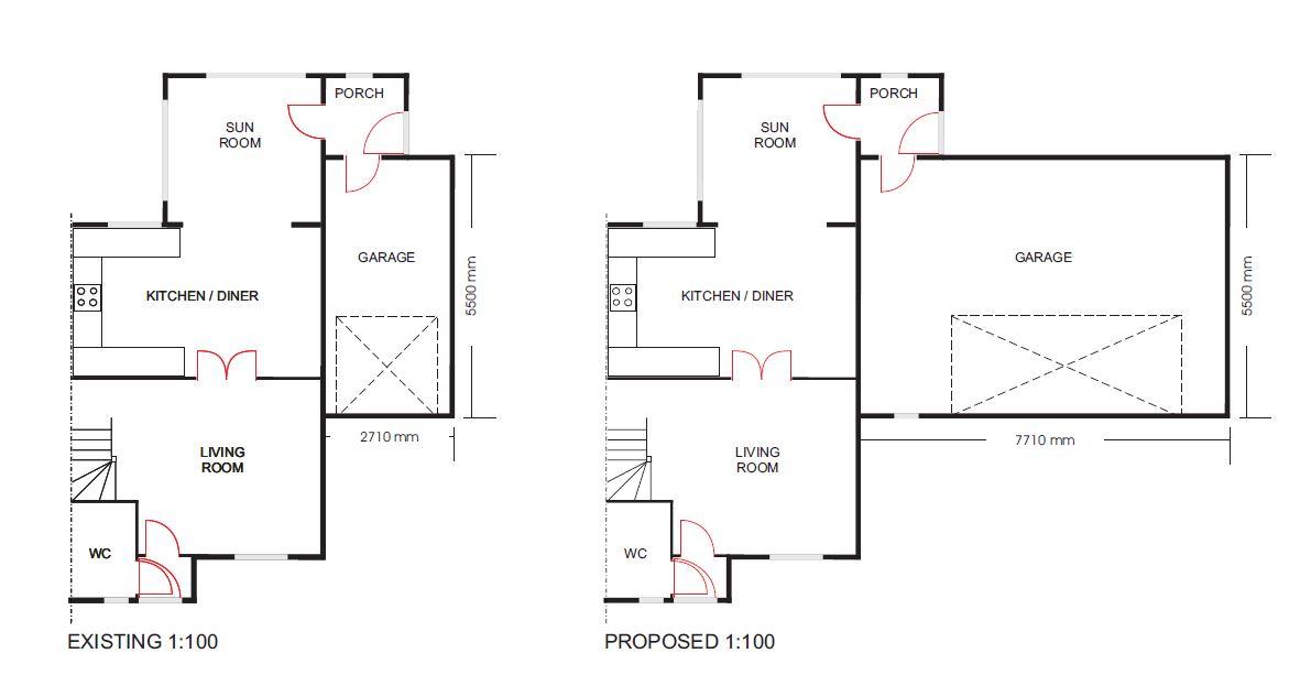

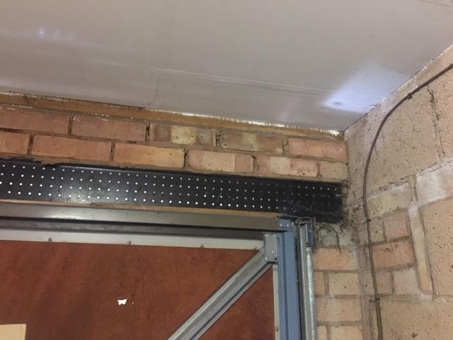

dangti6 Posted August 13, 2020 Posted August 13, 2020 I'm not even out of the ground yet, but it feels like this thing has been built several times over in my head. Essentially I am trying to be several steps ahead of myself to ensure things can run as smoothly as possible. I am looking at having a beam calculated in advance of the walls going up, and want to make sure I have enough info/detail to make it clear to others what I am trying to achieve - especially if there's no site survey, they could misenturpete my requirement. Project is a 100mm single skin, single garage which is to be extended width ways to a large double with a 16ft door opening. Beam length approx 5100mm (4800 + 150mm each end) so off the shelf catnics and similar become cost prohibitive. One pier of the new opening falls within the existing opening so this opening will be paritally bricked up to in effect move the opening over. Currently, externally there is a single course of facing brick on top of the steel strip attached to the catnic lintel. I am looking to render the outside of this garage when complete, so my intention is to have a steel beam with a plate welded to the bottom to take it out to ~215mm in width to sit on the piers and allow a course of brick to run flush along the front of it which can be rendered over. Would others recommend this approach or try to hide the beam up behind the fascia? The wall that will be built within the existing door opening will replace the old catnic or sit under it. Footings will be dug to the same depth as other trenches - I am under the impression this footing doesn't need to be calculated. Reason being, I am not showing any calculations for the rear wall which will also hold the roof and assume the depth check to solid ground in advance of pouring the concrete would suffice here? For Building Control, I am doing this under a notice rather than full plans. Would I require more than just a beam calcuation to satisfy building control for this lintel? Will they require additional Building Regulation drawings that I don't currently have? I guess what I am trying to avoid is having a calcuation that doesn't satisfy the BCO, or paying more than neccesary obtaining drawings that aren't neccesary. Attached images should hopefully help visualise.
