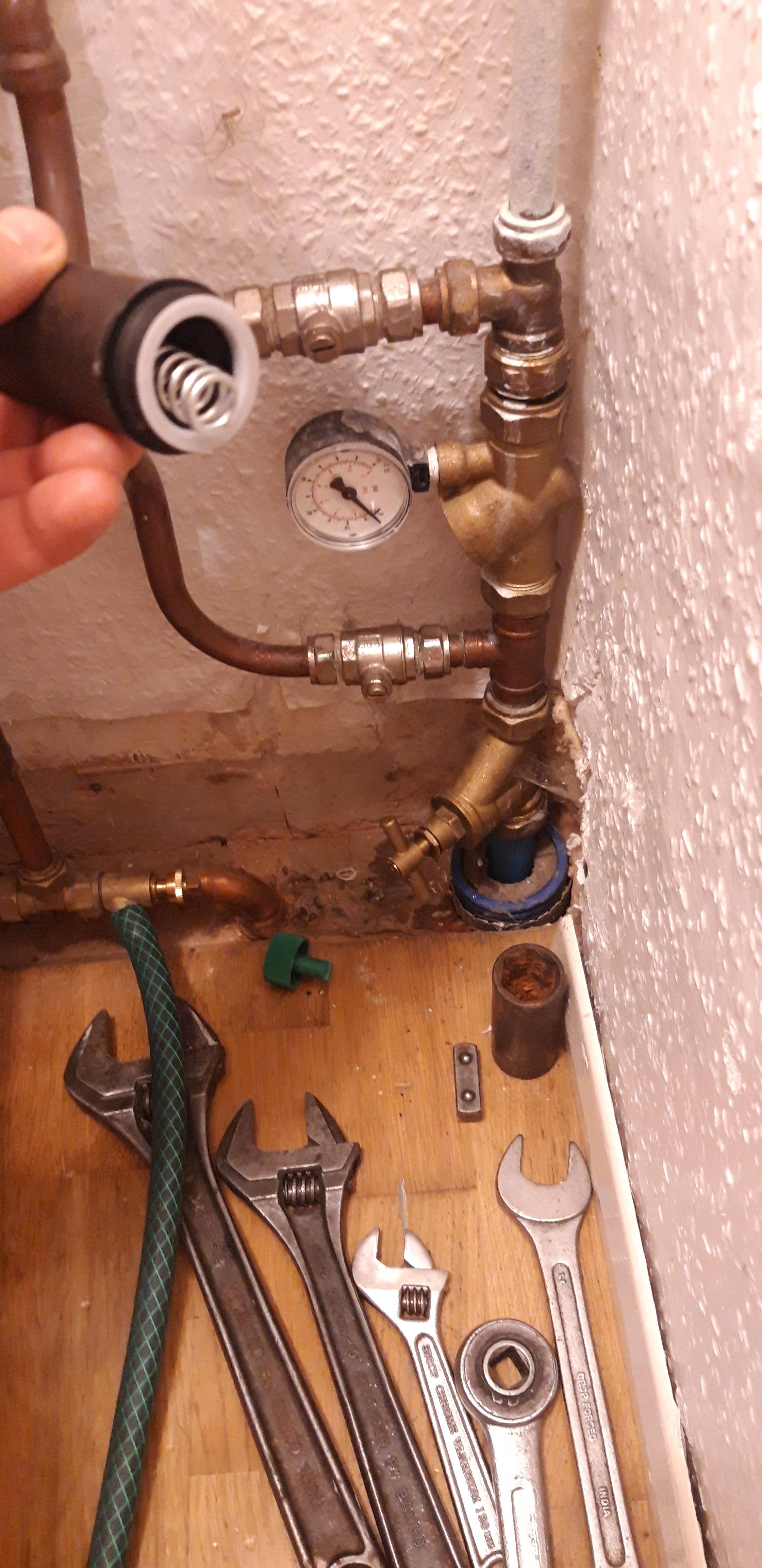

Onoff Posted August 13, 2020 Author Posted August 13, 2020 6 hours ago, Nickfromwales said: Turn the PRedV up to 3.5 or 4 bar and enjoy the benefits. Yes, shite can block the fine gauze filter in the cartridge of the PRedV but that should all be worked out by now so a clean up should see you enjoy trouble-free motoring for a good number of years. 3 bar strangles the flow to death BTW, especially if fighting that ridiculous primary pressure. Ta. Can it really be 4 years since I did the water meter? ? I'll strip the PRV tonight and report. Dead easy tbh as I can isolate at the stopcock in the picture and there's then a 15mm ball valve on the mains up in the loft. I can drain to under the suspended floor. Only thing I recall from this is I should have put the PRV in horizontal according to the manufacturer's instructions.....which I just skimmed.....and missed that point.

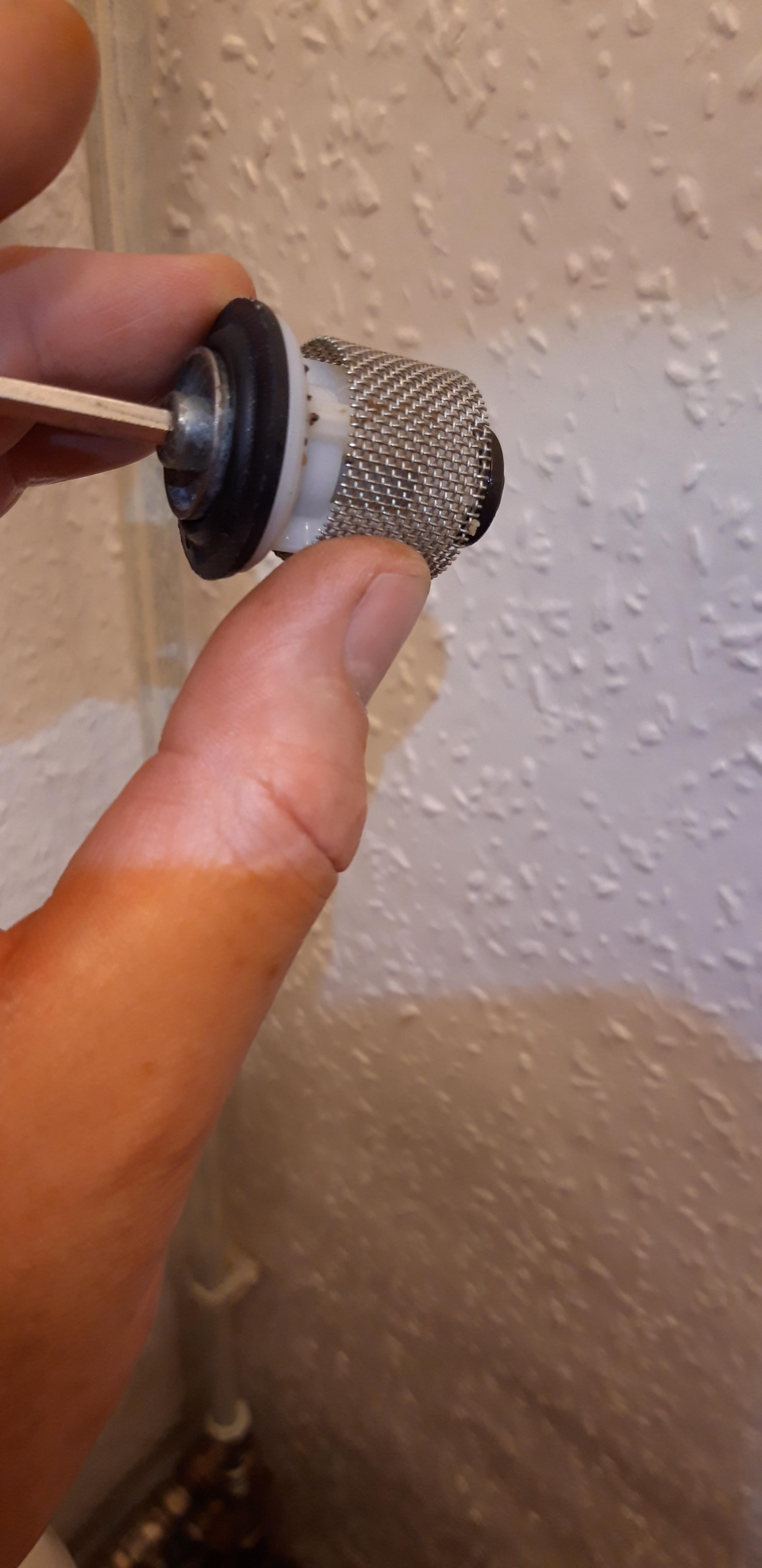

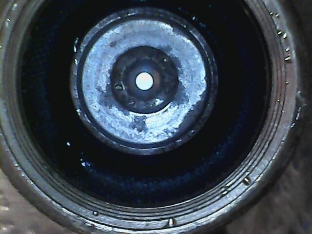

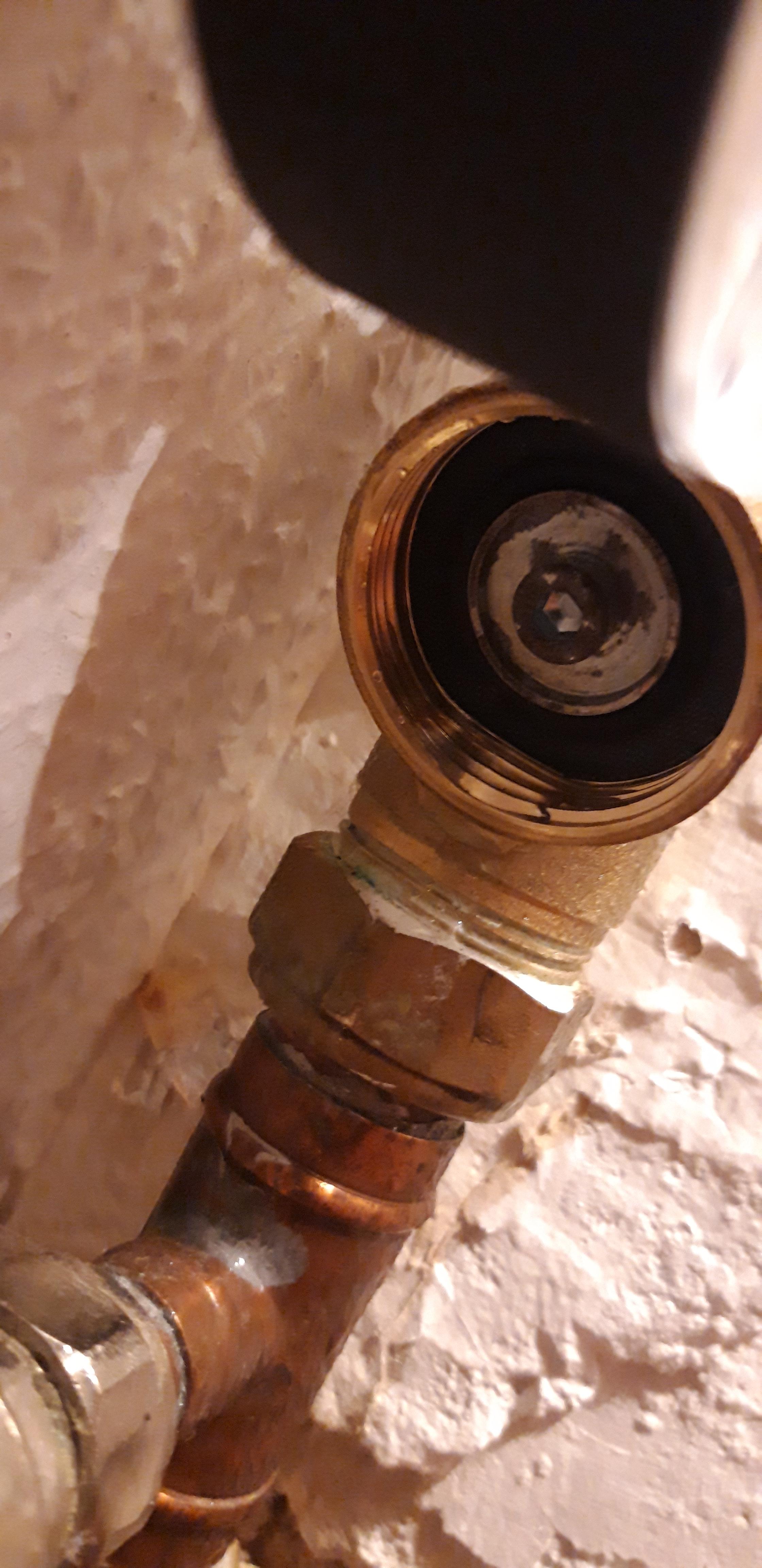

Onoff Posted August 13, 2020 Author Posted August 13, 2020 Can't find any of my 24mm spanners FFS! With a deep impact socket managed to get the first bit of the PRV off: Looking up inside: & with the endoscope cam: No mesh filter that I can see. Looks like a hex socket in there. Do I carry on with an Allen key to get the next bit out? Cheers
Nickfromwales Posted August 13, 2020 Posted August 13, 2020 6 minutes ago, Onoff said: Do I carry on with an Allen key to get the next bit out? Cheers Yes, but if it all goes horribly wrong then, no.......
Onoff Posted August 13, 2020 Author Posted August 13, 2020 (edited) The 4mm Allen key fits but it just goes around and around not coming out or screwing in? & I'm not sure if a) I can or b) I want to squeeze my ample frame in here to get a close up look! Edited August 13, 2020 by Onoff
Onoff Posted August 13, 2020 Author Posted August 13, 2020 Well it just pulls out. A few tiny, weeney bits of grit in there. A rinse off and try and get it back in now. Wish I was slimmer! 1

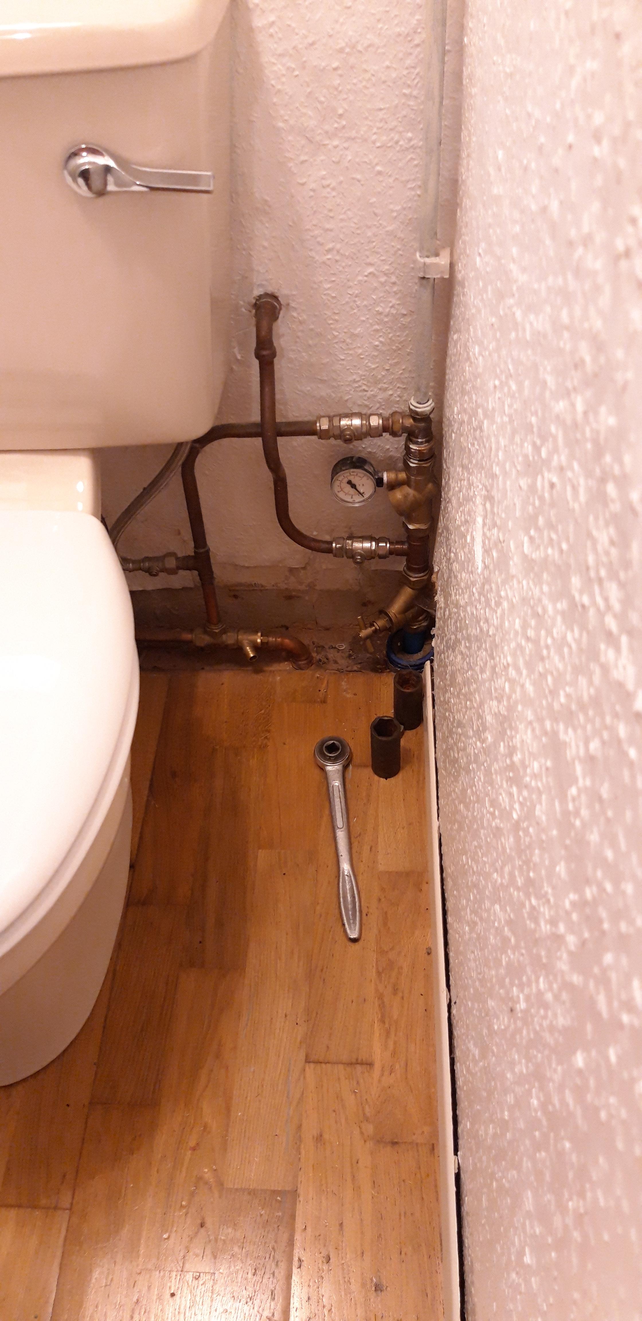

Onoff Posted August 13, 2020 Author Posted August 13, 2020 Had to take the bloody loo seat off to get in there and screw it back! 1 1

Onoff Posted August 13, 2020 Author Posted August 13, 2020 Oddly enough I think those little bits of grit might have been the issue. The PRV seems to adjust OK now. Might put a gauge on the furthest outside tap and see what I've got but it's certainly "better".
