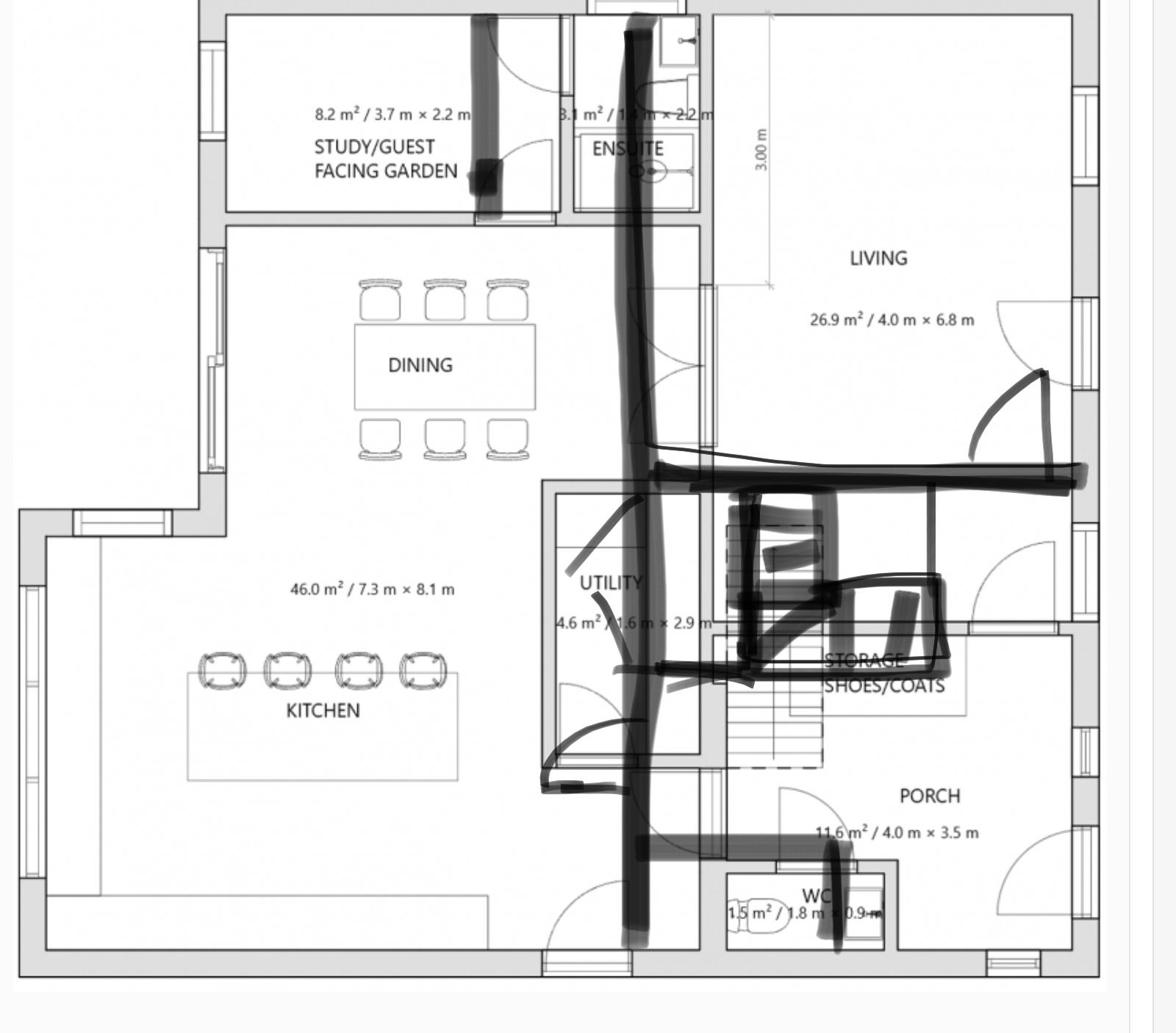

Floor Plan Design

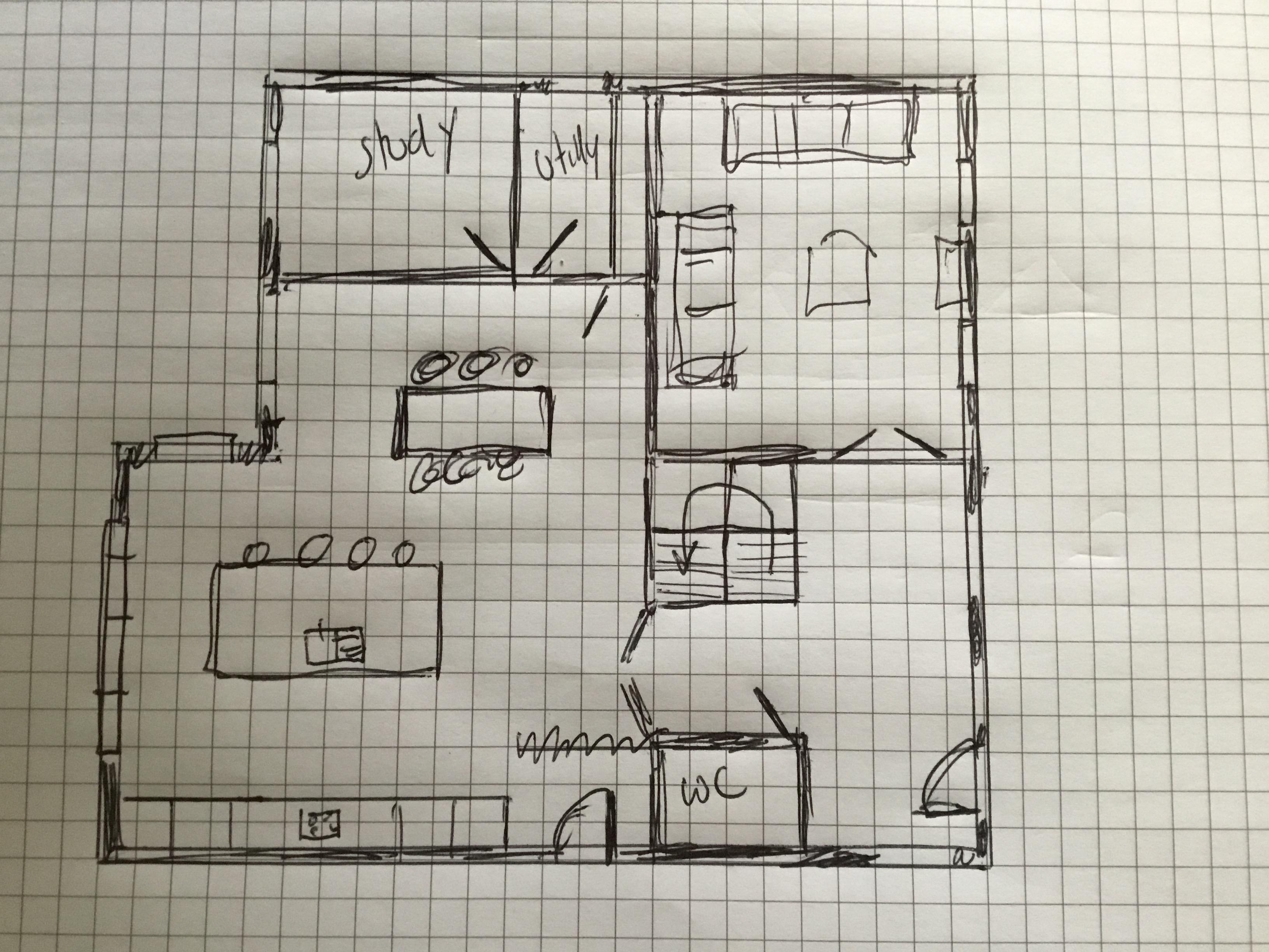

just an idea for you. Not to scale.  If it was me....
this provides feature staircase up to similar central area upstairs.
spacious entrance hallway with WC.  Glazed doors to living room, and tempting through to diner kitchen.  Bank of units down one wall with oversize feature island with seating.  You could make the kitchen windows full height flooding this main room with light.  Put utility area far side, include second dishwasher for easy loading from dining table.   Study give window to rear.  If you wanted to link living to dining use pocket doors but this would reduce the wall space for sofas.
i personally would still prefer the larger hall option.
I would have suggested moving the utility room also, but I am assuming that you cannot move the door so it has to stay where it s.

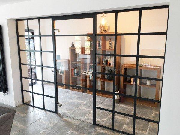

for the study area a couple of options.  One is leave it entirely open plan, or have an internal glazed partition (Per image).  Again so if you need this area as a future room you can easily put up an internal wall.

Saucepan, downstairs.  Try this.  It might work for your needs.
move the lounge/porch dividing wall maybes 1 metre up into the lounge to where the stairs end. Approx in line with where the kitchen and dining areas dividing line is.  Then Move the lounge/dining dividing wall left maybes 0.5-1m left (squaring off the study to make it maybes 3-3.2 m wide something like that).  This will make your lounge squarer approx 4.5 x 5.5 something like that.  If you need doors between lounge and dining use pocket doors.
The porch area will then be big.  push your utility to the right and Into the now bigger porch space, partially under the stair, with access from kitchen or porch if you prefer.  You may need to change your stairs to an L shape to land upstairs in the same place.
the result will be your kitchen diner shouldn’t have the utility area stuck midway.    If this new utility space partially under the stairs isn’t quite big enough your doors could be double doors from kitchen to access sort of a deep but wide utility cupboard / laundry, galley area as opposed to a walk in room.
the island does look far better than the breakfast bar.  The utility block as is does spoil that feature room,  but I think you’re moving in the right direction,
