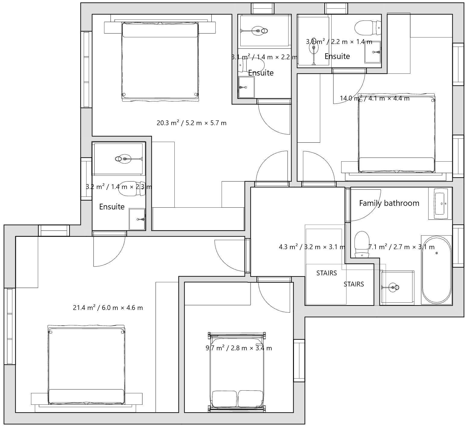

  1. With the current stair location the en-suite locations could be changed to this alternative.

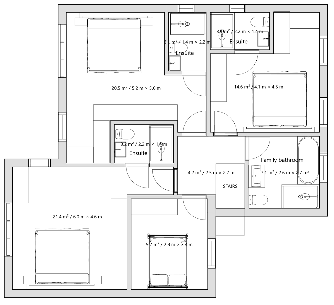

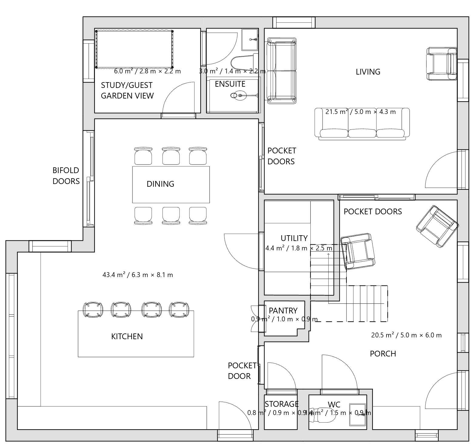

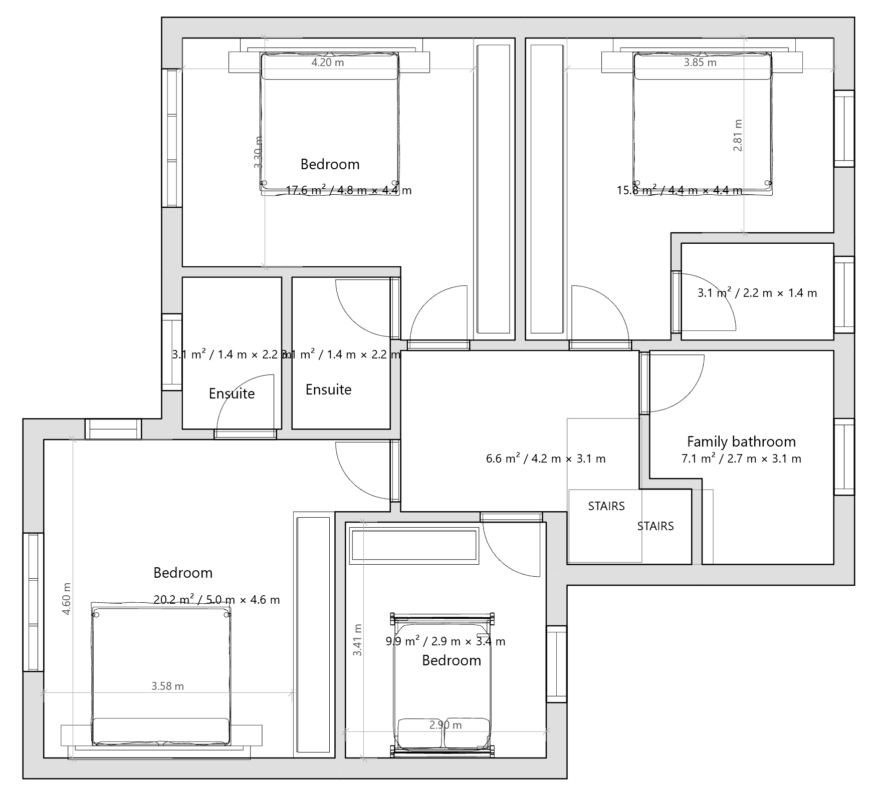

  2. Pocket doors is one we'll have a good think over and probably go and try them out somewhere or see them in action in a house if we can find one that has them to view. Yes we will mock up the complete kitchen details with all the units we would want. That way we can make sure we are happy with the amount of units in the kitchen area and makes it easier to decide if we need units under the kitchen window. I'll do a version with and without full kitchen windows. You are right that it would look amazing. Would bifolds be better then full windows there too as then we could open up the whole area? If you ignore the upstairs layout (aside from stairs being excluded from porch area) roughly where and what style of stairs would you place? I can have a go at making a layout upstairs that takes into account alternative stair placement. We are pretty open to changing upstairs as we haven't spent much time on there aside from making sure we could fit in everything. The preference is 3 en-suite but maybe we would go with 2 en-suite if the layout proves challenging with 3. Very useful to know about things like carpet size limits.
  3. Thanks everyone for all the suggestions. The floor plan has come a long way in a week. We'll probably just make minor tweaks around some of the storage/door openings when we work with our architect. But we think that the below plans provide us with everything we would need as well as looking great..
  4. After looking at the upstairs it became easier to create a nicer layout if the stairs were oriented differently. So there's no need for the WC under the stairs. Here is the latest idea with the upstairs floor plan as well.

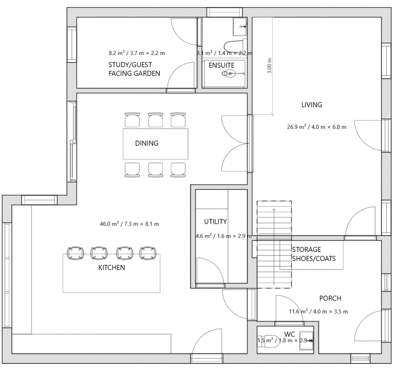

  5. We've had an idea to put a utility room without needing to pass through it from the porch to kitchen area. The kitchen island also becomes possible in this design. And it leaves a fairly large porch area which is nice to enter to. What are peoples views on the WC under the stairs?

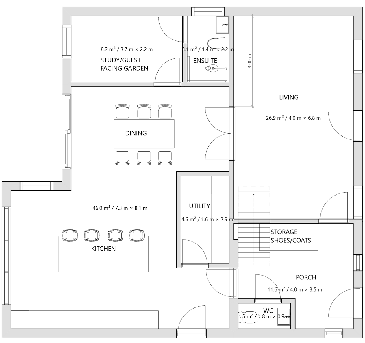

  7. Thanks. It should be possible to adjust the lengths of the flights of the stairs to avoid headroom issues with the help of an architect/arch technician. The roof on the porch is reasonably high on the side where the stair would be so we expect it to be possible. Between the 2 plans of a corridor to the kitchen through the utility and the hallway option do you have a preference yourself? I've put them side by side below for easy reference.

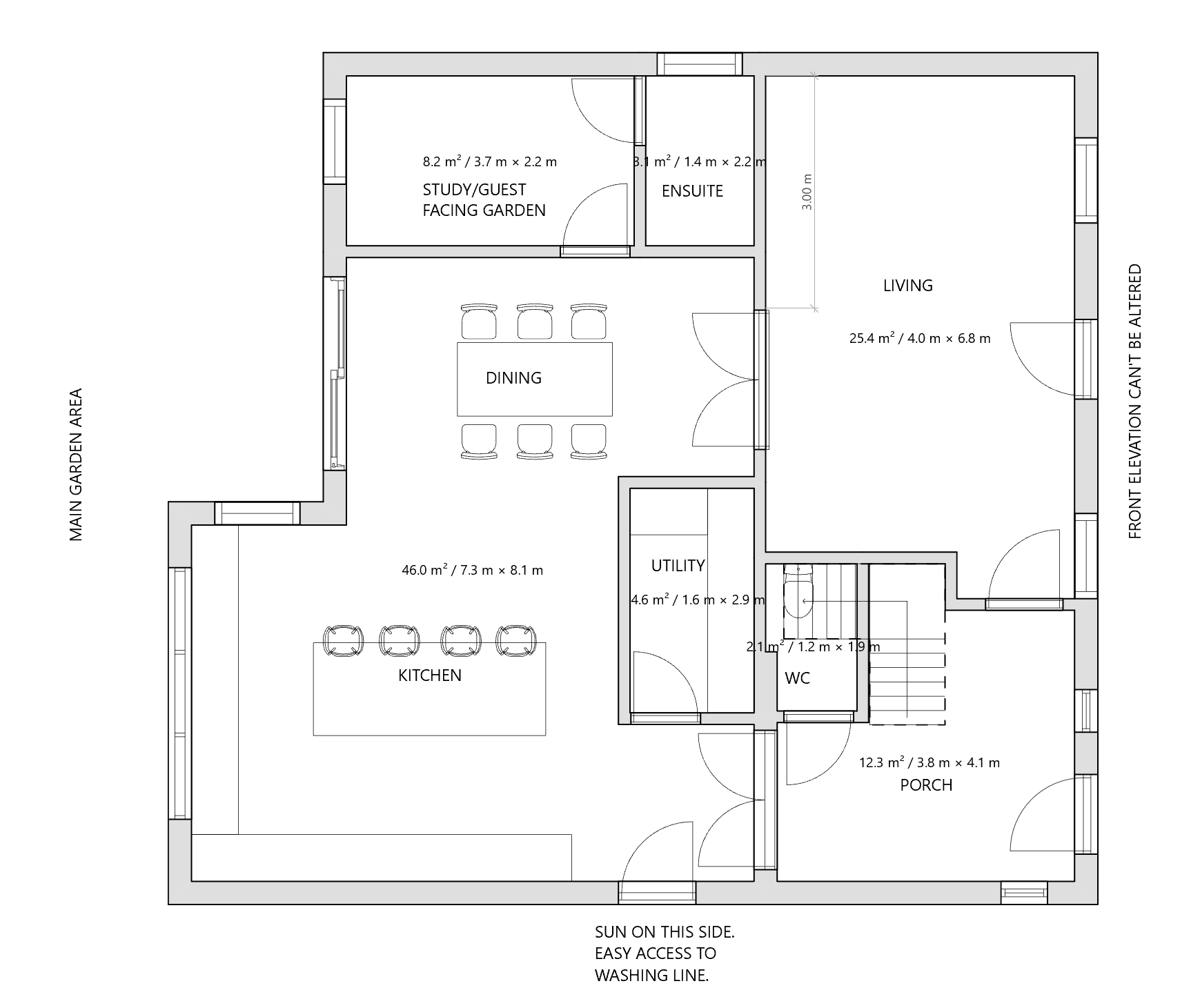

  8. Thanks for the feedback. Some very valid issues raised. It's helped us come up with a potential alternative layout. There could be access through the utility room to the kitchen. This stair layout is better for the room shapes in the upstairs too. Would be interested to hear your thoughts on something like this?
  9. I've followed up and all possibilities for the positions of the house were thoroughly looked at. The site is heavily constrained by the neighbouring properties and the orientation maximises the build footprint. Any other orientation would result in a significantly smaller house. So back to the floor plan. Does anyone have any further suggestions on the ground floor layout or an alternative location for the stairs to consider? Partially open plan with making a feature of the stairs is what we are leaning towards.

  15. Hi, We have been going through some floor plan options and just wanted to get some feedback in case anyone spots anything obvious that could be changed or should be avoided. We are also not sure if we should make a 5th bedroom or go with a large master bedroom. Thanks, Alex
