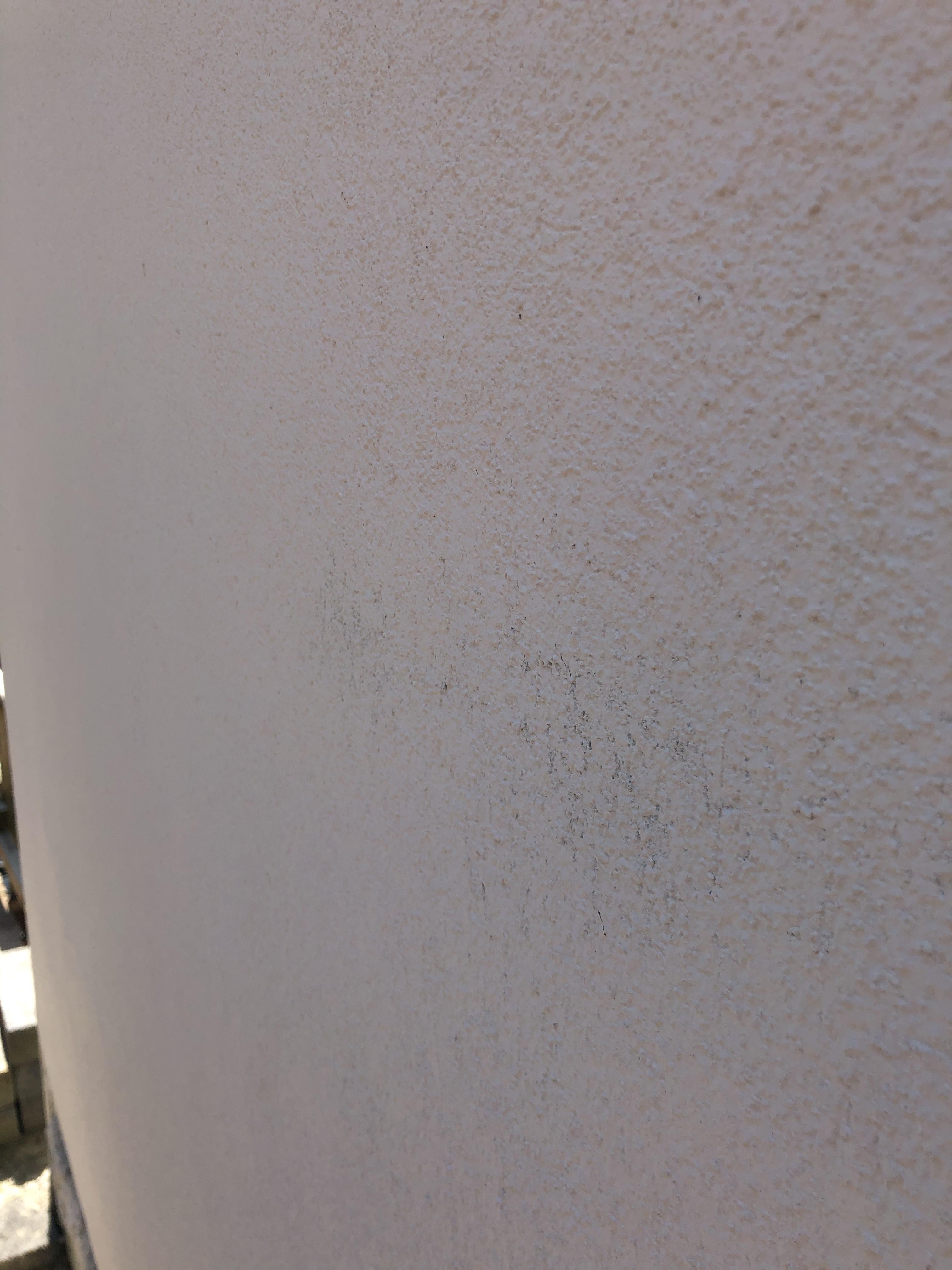

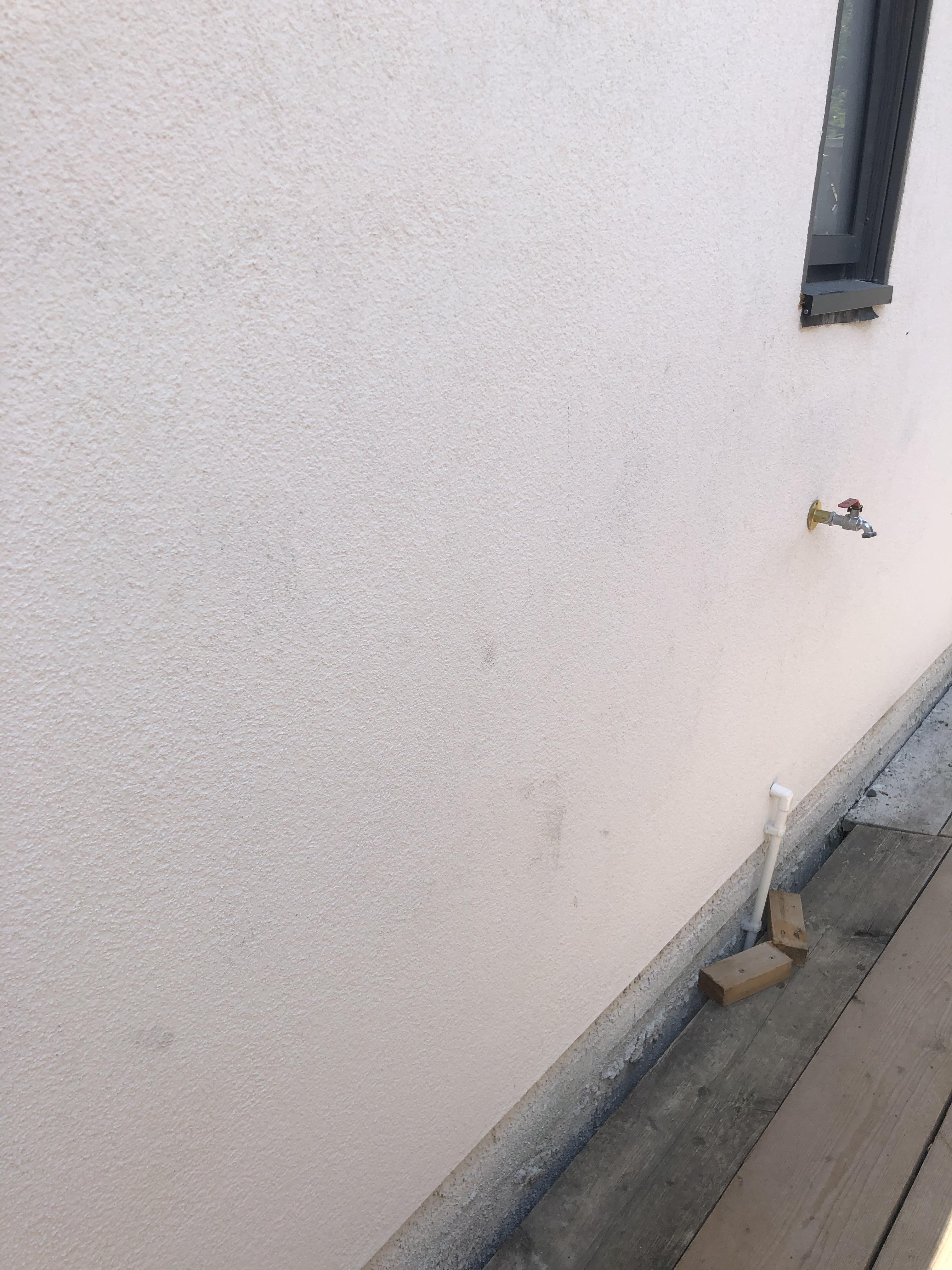

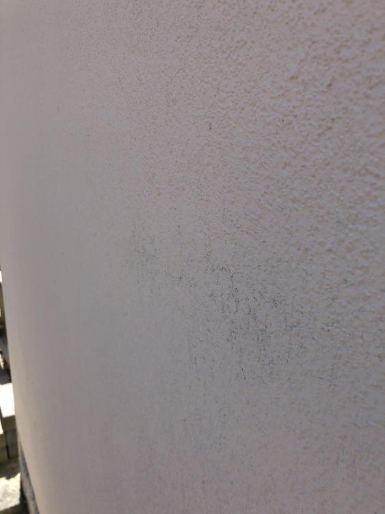

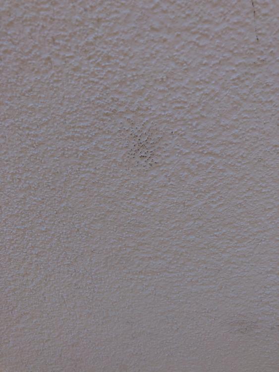

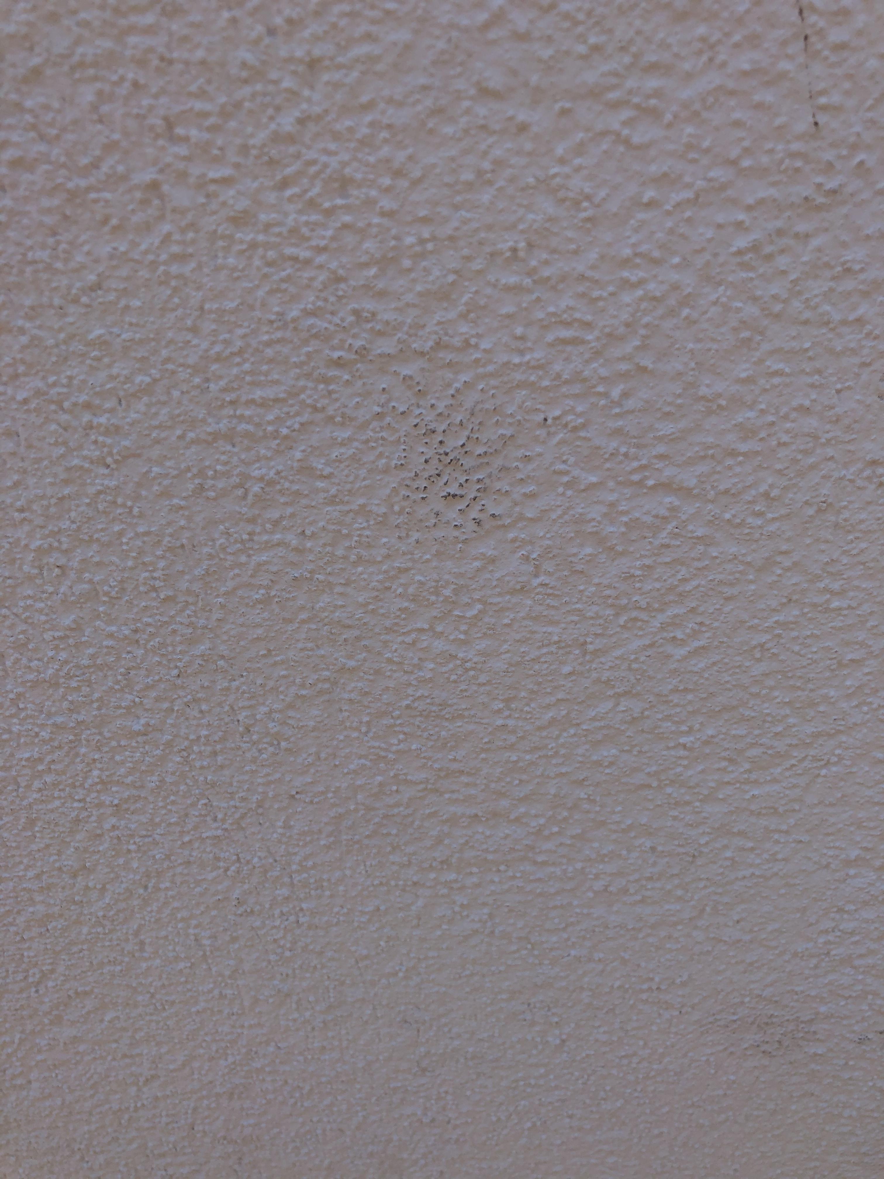

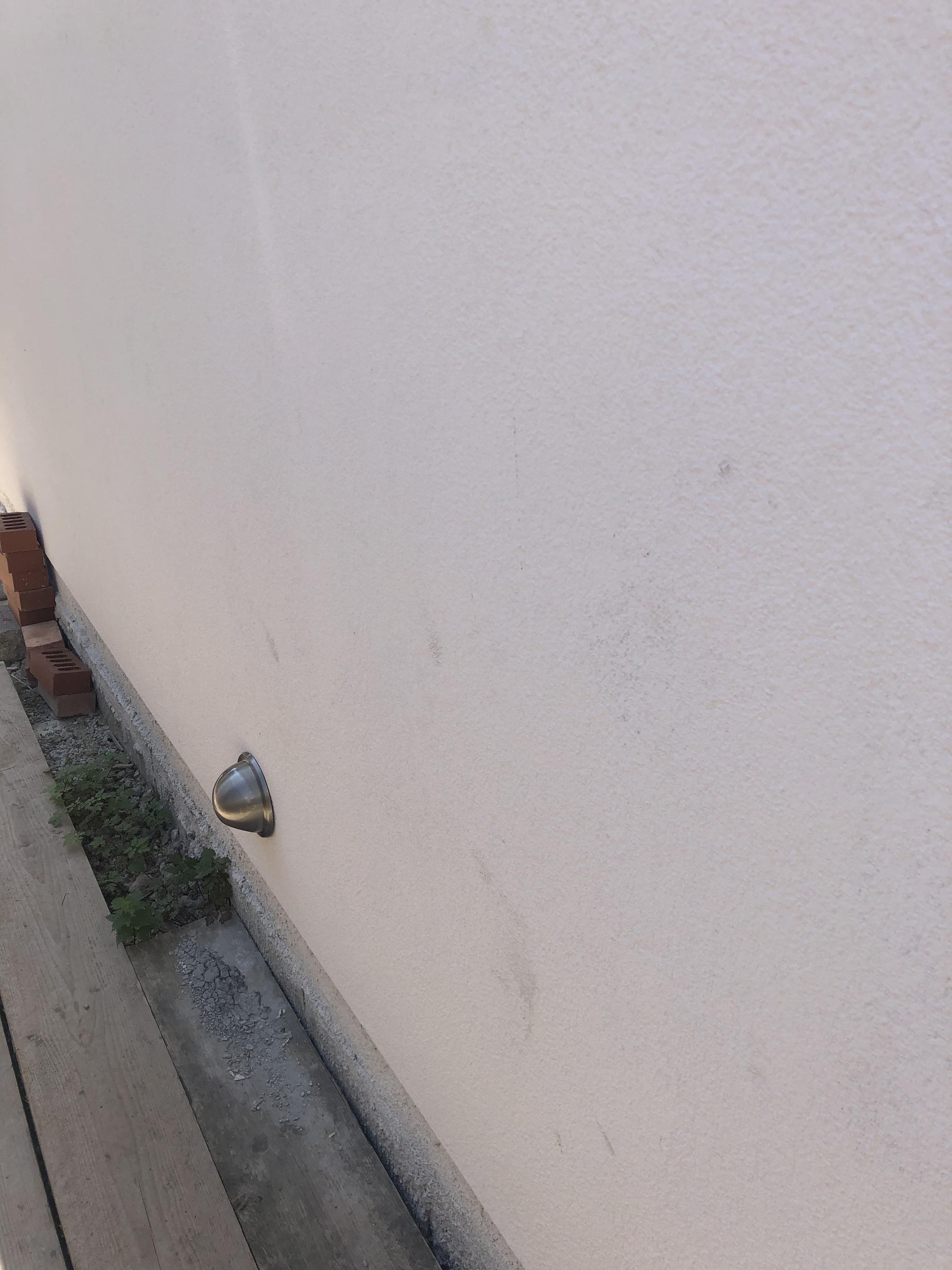

Pocster Posted August 7, 2020 Posted August 7, 2020 My exterior was K rendered about a year ago . I’ve noticed a few scuffs and assumed it’s where I’ve hit the wall . I no longer think this . Not sure it shows up in the photos . Obviously I could re paint at a later date just surprised how soon it seems to be losing its colour
Pocster Posted August 7, 2020 Author Posted August 7, 2020 (edited) On 07/08/2020 at 11:22, Onoff said: Needs to all come off and be redone imo. ? Expand Should it lose its colour so quick though ? Always thought k rend should last for years - not 1 year . That wall is on a sheltered side aswell .... ? Edited August 7, 2020 by pocster

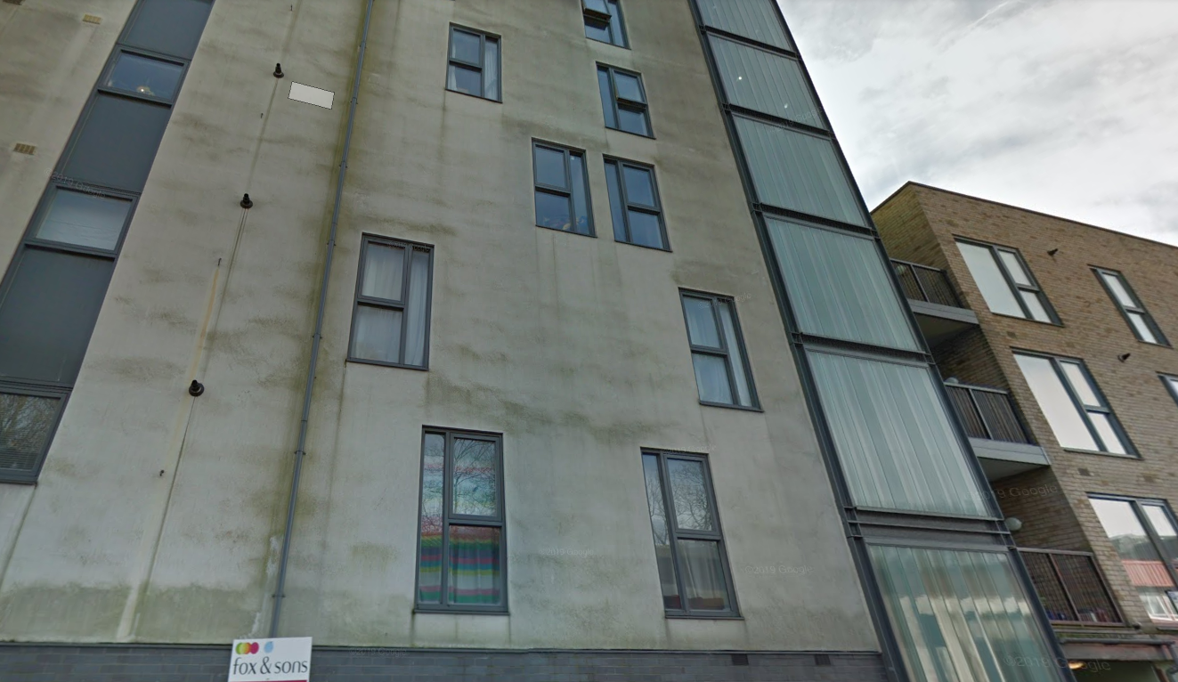

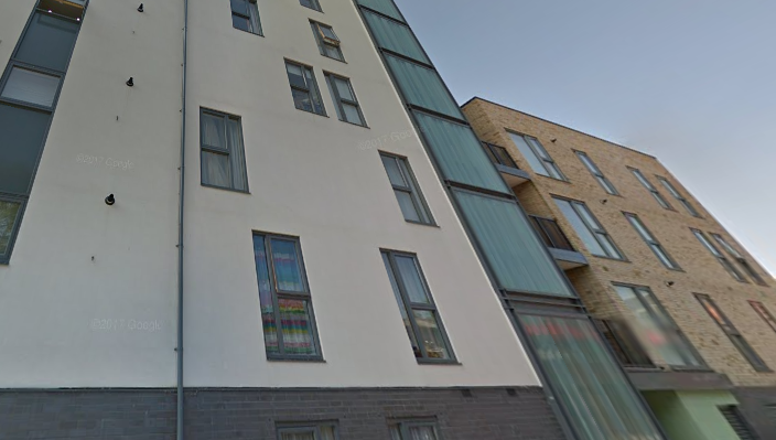

Mr Punter Posted August 7, 2020 Posted August 7, 2020 Most of the through colour render I have seen does this. Here is some in Brighton 7 years old Here it is newly done 1
Pocster Posted August 7, 2020 Author Posted August 7, 2020 On 07/08/2020 at 11:46, Mr Punter said: Most of the through colour render I have seen does this. Here is some in Brighton 7 years old Here it is newly done Expand Ouch ! . Mines only 1 year old ! . Just repaint then with the appropriate silicon breathable paint ??
Mr Punter Posted August 7, 2020 Posted August 7, 2020 The brickwork on the right looks OK though, so you could rebuild in brick.
A_L Posted August 7, 2020 Posted August 7, 2020 The worst scuffing on the tower blocks seems to correspond with possible thermal bridges and little around boiler vents (warm-spots).
nod Posted August 7, 2020 Posted August 7, 2020 Contact K Rend This is exactly what your guarantee is for The k Paint is good You have to do the full panel and also loose the silicone sparkle
Pocster Posted August 7, 2020 Author Posted August 7, 2020 On 07/08/2020 at 13:33, nod said: Contact K Rend This is exactly what your guarantee is for The k Paint is good You have to do the full panel and also loose the silicone sparkle Expand So I can simply over paint it with the appropriate paint? . Do I need to prep the surface?
nod Posted August 7, 2020 Posted August 7, 2020 We’ve done a few that have just wanted to change the colour we normally spray ten days before with an anti algae Let the rain to the rest 1
