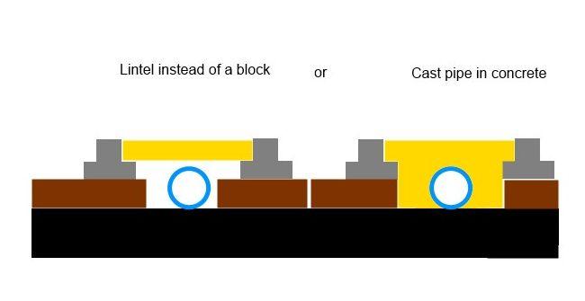

JulianB Posted August 6, 2020 Posted August 6, 2020 Afternoon All, We've finally managed to lay the foundations after having excavated the best part of 500 tons to clear site together with the challenging underpinning and retaining walls. We're now onto the build to the underside of the beam and block floor / DPC and things are looking pretty tight in terms of underground drainage. Due to us not having a great deal of space under the floor (150mm), we do not have the luxury of installing a concrete lintel above the openings for the soil pipes. As a result I've been thinking if a galvanised single leaf angled lintel would do the job or if this is a 'no no' being under external ground level, however not in direct contact.Not really sure what other low profile lintels are out there, and the exits are perpendicular to the direction of the beams and hence would require the flooring blockwork and slip bricks to rest on these sections. Would anyone have any suggestions? Thanks! Julian
Temp Posted August 6, 2020 Posted August 6, 2020 I think I would wrap short lengths of pipe in insualtion and lay them cross the top of the foundations. At some point cast them in concrete. If the beams of the B&B floor go either side of the pipe your cast concrete can replace a block and form a lintel.

JulianB Posted August 7, 2020 Author Posted August 7, 2020 On 06/08/2020 at 18:57, Temp said: I think I would wrap short lengths of pipe in insualtion and lay them cross the top of the foundations. At some point cast them in concrete. If the beams of the B&B floor go either side of the pipe your cast concrete can replace a block and form a lintel. Hmmm I don't think I quite understand this approach. Are you saying to use a pipe wrapped in insulation as a form to cast some concrete which would then carry the weight of the block floor? On 06/08/2020 at 19:23, Brickie said: If your pipes are tight to the floor can you not lay two courses of engineering bricks (so 150mm high) either side as your lintol bearing,and bed a standard 100mm x 65mm concrete lintol level with your first course of blocks? (225mm to top of lintol.) The problem with that approach is I would no longer be level for the last block coming off the beam, to the perimeter of the inner leaf if that makes sense
Temp Posted August 8, 2020 Posted August 8, 2020 8 hours ago, JulianB said: Hmmm I don't think I quite understand this approach. Are you saying to use a pipe wrapped in insulation as a form to cast some concrete which would then carry the weight of the block floor? Yes but not as a form. Actually use the pipes cast into the concrete block. Its quite common to run pipes through the foundation pour. The insulation allows a bit of movement due to settling but that is really only important when using clay pipes that can crack. You might also be able to put the beams of the b&b floor either side of the pipe and replace a block with a lintel. I'll try and make a drawing in a moment.

JulianB Posted August 8, 2020 Author Posted August 8, 2020 3 hours ago, Temp said: Thanks for that, now it makes a lot more sense! Unfortunately I'm exiting the underfloor space perpendicular to the beam direction and hence the blocks would be spanning the final section and resting on the inner leaf. I think if I had a block bigger than 440, then I could happily span across the underground drainage opening in the inner leaf, not sure what other options I've got... 2 hours ago, Russell griffiths said: There’s normally lots of room for the rest bend as you have the depth of the beam to play with. I'm hoping that if it is very close I could get away with the rest bend protruding through the beam and block floor seeing as we've then got the insulation and screed, and live with the bigger opening in the block... which would then be covered by the insulation and screeded over?
Russell griffiths Posted August 8, 2020 Posted August 8, 2020 Having the bend collar protruding above the beams is exactly what you do, you will have at least 150mm of insulation above the beams so plenty of room to adjust to what you need poking up. You should ideally have the beams design done so that a beam doesn’t sit directly over a pipe. In the grand scheme of things a 110mm opening doesn’t even need a lintel as long as there is no direct load over it.
Temp Posted August 8, 2020 Posted August 8, 2020 4 hours ago, JulianB said: I'm exiting the underfloor space perpendicular to the beam direction and hence the blocks would be spanning the final section and resting on the inner leaf. I I think you might still be able to cast your own block/lintel.
Russell griffiths Posted August 8, 2020 Posted August 8, 2020 If you go and get a length of pipe 150mm and cut it into 600mm bits you can do a sleeve over your pipe and surround in concrete.
