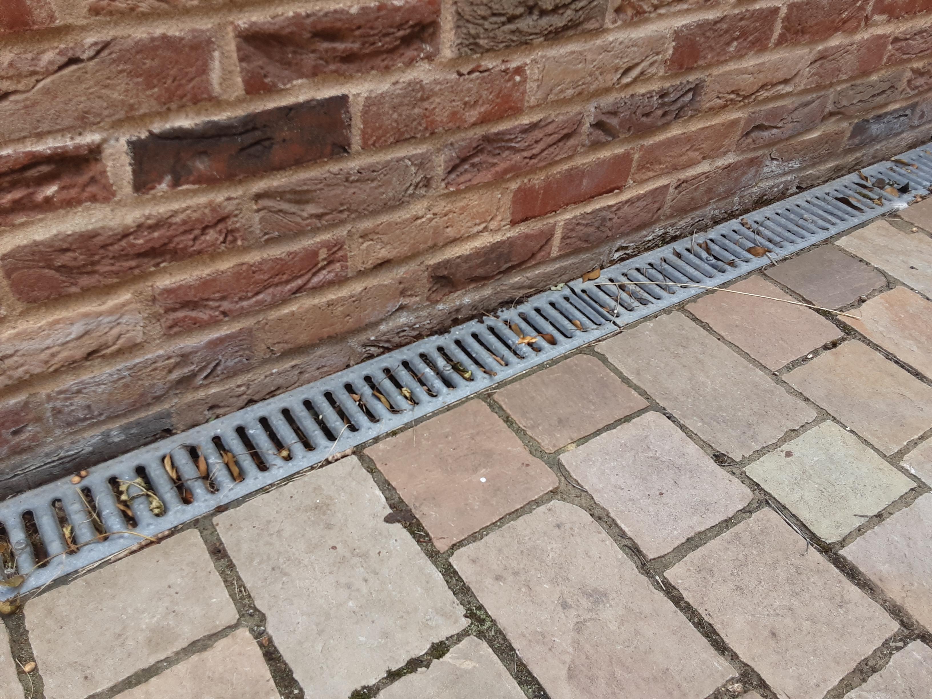

Willow23 Posted August 2, 2020 Share Posted August 2, 2020 I am a full-time wheelchair user and we are building our own single storey property to suit my needs. All through the build I have insisted on level or just a slight gradient access and definitely not ramped access, in line with part M1 43. However, the contractor has inserted air bricks below the damp course and both him and Building Control are telling me I cannot have level access now and must have a ramp, just as if it’s to visitability standards and not full access. The planning approval was for level access. I know they should have used telescopic extenders to put the air bricks higher, but they keep dismissing this. We have a site meeting tomorrow with Building Control (it’s an external company who don’t seem to have a clue about wheelchair user’s needs) and our builder who also doesn’t seem to understand why I don’t want a ramp. Can anyone advise me please? We will have spent getting on for £900,000 on this property and it’s tearing us apart knowing that it will not be fully accessible for me. Link to comment Share on other sites More sharing options...
Russell griffiths Posted August 2, 2020 Share Posted August 2, 2020 I think you install a trough type arrangement, so path heights come up level but stay back from the vents so you get your airflow. You will have to have a small slope to ensure water flows away from this trough and not to it. Link to comment Share on other sites More sharing options...
pdf27 Posted August 2, 2020 Share Posted August 2, 2020 What does it say in the contract and the drawings the builder is working to? If it's a key design requirement then it should be clearly marked up on the drawings, for instance the floor level and external ground levels being shown relative to OS datum: in this case it's a simple case that they've built it wrongly and need to fix it at their expense. If it doesn't then you may have more of a headache and there is a risk you will end up paying for the remedial work. Given your requirements you should not just accept it however. http://www.nhbc.co.uk/Builders/ProductsandServices/TechZone/NHBCStandards/TechnicalGuidanceDocuments/61/filedownload,65368,en.pdf is very relevant here - a trough is possible but needs to be 600mm wide which may be an issue for you and your site (if it's anywhere near a path there is presumably the risk of you falling into it!). How far above the air bricks has the build gone? If it's only just above then knocking a hole in the outer leaf to fit the telescopic air brick extenders shouldn't be very expensive. Essentially you'd take out the 4 bricks shown, attach a telescopic vent to the inside part of the existing air brick, and then make good with the vent in the new (upper) position. If they need to do the inside part of the current air brick as well they might need a slightly bigger hole, but not much. Link to comment Share on other sites More sharing options...
MikeSharp01 Posted August 2, 2020 Share Posted August 2, 2020 So is the access plan a very shallow ramp or do you want the ground everywhere to be at the level of the threshold. In either case there is nothing to stop you providing a trough as @Russell griffiths & pdf27 suggests and even if it is 600 wide there is nothing to stop you (them if its they who have to fix it) putting a grill on top of the trough so you can wheel across it although it will still fill with debris, leaves etc, and need regular cleaning so if you can get the telescopes that will be the better solution. As @pdf27 says if level access is in the spec then that is what the contractor should provide. Link to comment Share on other sites More sharing options...
Temp Posted August 2, 2020 Share Posted August 2, 2020 6 hours ago, Willow23 said: I am a full-time wheelchair user and we are building our own single storey property to suit my needs. All through the build I have insisted on level or just a slight gradient access and definitely not ramped access, in line with part M1 43. However, the contractor has inserted air bricks below the damp course and both him and Building Control are telling me I cannot have level access now and must have a ramp, just as if it’s to visitability standards and not full access. The planning approval was for level access. I know they should have used telescopic extenders to put the air bricks higher, but they keep dismissing this. Can you post a photo? So as I understand the problem is if it was level immediately adjacent to the house the vents would be blocked. The answer might be to move the level area 6" away from the house to leave a "trough" or gap for air to get to the vents as others have suggested. This gap could be covered with something like a removable linear drain cover to prevent the wheels of your chair falling into it... Link to comment Share on other sites More sharing options...
Willow23 Posted August 3, 2020 Author Share Posted August 3, 2020 Thank you everyone - the contract is for level access with a very slight gradient for water. The Architect we had unfortunately did a late drawing when the BC inspector said we needed air bricks, which we were unaware of and the contractor built it like this without checking with us. It wasn’t until we looked at the bricks under the covers that we saw that air bricks had been put below the damp course. It’s a timber framed bungalow with a brick wall, with a block wall behind, so a bit tricky now to get the telescopic vents in. We met the BC inspector today and he, like several of you are suggesting, the drainage channels with gravel, but I didn’t really want this, but looks like I’ve not got any choice now. So frustrating when this house was meant to be built for my needs and is costing us so much money, yet not how I wanted it. Thanks for all your kind help Link to comment Share on other sites More sharing options...

Temp Posted August 3, 2020 Share Posted August 3, 2020 My level access area outside the front door extends far enough out from the house that we could put steps down off the sides for able-bodied people and coincidentally expose the vents. We also have beam and block floor. I'm away from home or I would post photo. Link to comment Share on other sites More sharing options...
Willow23 Posted August 4, 2020 Author Share Posted August 4, 2020 Thanks Temp - yes a photo would be great when you are next home Link to comment Share on other sites More sharing options...
Temp Posted August 5, 2020 Share Posted August 5, 2020 Not sure if this will work... https://www.instantstreetview.com/@52.370122,-0.428756,282.1h,2.85p,2.4z The top step is level with the front door. There is a gap in the wall to the left of the steps and you can drive up to that level. Link to comment Share on other sites More sharing options...
