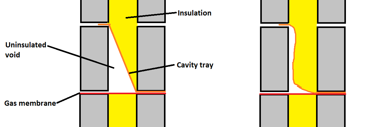

MortarThePoint Posted August 1, 2020 Posted August 1, 2020 Cavity trays made using DPC roll are often shown simplistically crossing the cavity at an angle from their top on the inner leaf to bottom on the outer leaf. In reality, even if you try to run the DPC material down the inner leaf before crossing the cavity, you will still create a void behind the cavity tray that will end up uninsulated: Is there a way to insulate this void or is it a matter of trying to keep it as small as possible? Preformed corners and stop ends all seem to adopt the shape on the left and so will create quite a significant cold bridge. I'm using blown bead insulation. There is no route for the beads to get between the gas membrane and cavity tray. Also I wouldn't want the pressure of the bead blowing to dislodge the cavity tray.

MortarThePoint Posted August 2, 2020 Author Posted August 2, 2020 There is a company that makes some insulation for use with cavity trays: https://www.jackon-insulation.co.uk/products/detail/jackodur-cavity-tray-insulation/ I wouldn't be able to get these in time. I wondered about using polystyrene coving and pinning the cavity tray to the face of the inner leaf as then there would only be the curve as it makes a single transition from vertical to horizontal. Then I saw the coving is hollow so wouldn't help much. I'll have to make sure the cavity tray is installed loose enough for the blown beads to push it down onto the face of the inner leaf without applying a tension to the cavity tray and risking dislodging it. With a bit of care, it should be possible to have a radius of curvature of about 25mm or less at both the top and the bottom of the vertical portion of the cavity tray (as shown on the right side of my sketch) and so the missing amount of insulation will be small (about 10% over a height of 25mm). If the DPC material can actually be convinced to fold then it will be a lot less. 450mm is a standard width for DPC but that is a bit tight to make this out of. 102mm outer leaf, 100mm cavity, and 225mm up inner leaf leaves only 23mm stuck in to the inner leaf blockwork bed. Is that enough? If tight and crossing at an angle making maximum cold bridge, it would have about 100mm available for the inner leaf bed. I think I'll get my scissors out and trim down a load of 600mm wide DPC to 500mm.
MortarThePoint Posted August 2, 2020 Author Posted August 2, 2020 On 01/08/2020 at 11:11, nod said: Ah I see the membrane must be above dpc then I might be missing something here. The gas membrane is at DPC level of the outer leaf and I am forming the DPC using the cavity tray that is on the surface of the membrane.
