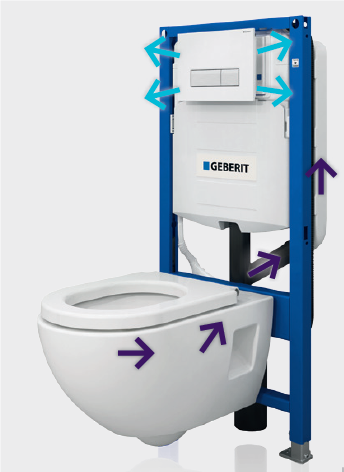

Onoff Posted January 21, 2017 Posted January 21, 2017 So the concept of this is: - The flush pipe has a Y branch. - Once flushed, there's no more water coming down that pipe. - You extract via the Y branch and the smell gets sucked in under the rim of the wc. What's the pipe back to the cistern do? @Auchlossen, have you got a picture of where it connects to the cistern.
le-cerveau Posted January 22, 2017 Posted January 22, 2017 (edited) @Onoff, the pipe back to the cistern is for the Geberit odour extract system, that draws air through a charcoal filter, see picture below. I enquired with Geberit about getting the Y- branch on its own but apparently they are solvent welded into the cisterns, however the cistern with the pipework arrangement below is only £10 more than a standard one, just don't buy the electronic gubbins that goes in the flush plate. Edited January 22, 2017 by le-cerveau Picture inserted

le-cerveau Posted February 20, 2017 Posted February 20, 2017 I looked at this and researched it extensively, including numerous enquires with Geberit. They don't sell the Y pipe separately, and as you say the current down pipe is welded in, however the cistern with the Y pipe in is only £10 dearer than the standard on, so if you plan ahead and fit the odour extract cistern without the electronic gubbins and then retrofit later. I know this doesn't solve your problem so I suspect the best (and safest) solution is to take the air out of the cistern, above the fill level (aka JSH) so as to not compromise the cistern.
