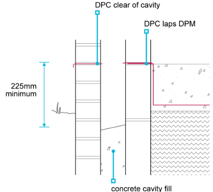

My brickie and BCO both say that the DPC/cavity tray at the bottom of wall (above splash) can stop just short of the edge of the mortar so that it isn't visible, but my warranty inspector says that he would require it remediated if that was the case. He says it needs to stick out by 10mm so that capillary action doesn't allow water to bypass the DPC. I think that's going to make things much worse as rain could collect on the surface of the part sticking out and then get sucked into the wall at a much greater rate than any rising damp could possibly bypass the DPC.
Here's how NHBC draw it in their guidance:

10mm seems excessive and may look crappy.  As long as it is just visible it will be OK.  Could see no mention of 10mm projection in NHBC.  The drawing shows a slight downstand, which will not happen with the stuff on a roll.

I found this LABC guidance:
"The bottom of the tray should be taken across the external leaf and preferably just visible at the external mortar joint."
That's preferably just visible, possibly not, and definitely not sticking out 10mm.
This LABC guidance on the other hand is perhaps clearer:
"5. Ensure the external edge of the DPC is visible and not bridged by mortar when completing pointing of the mortar joint."
