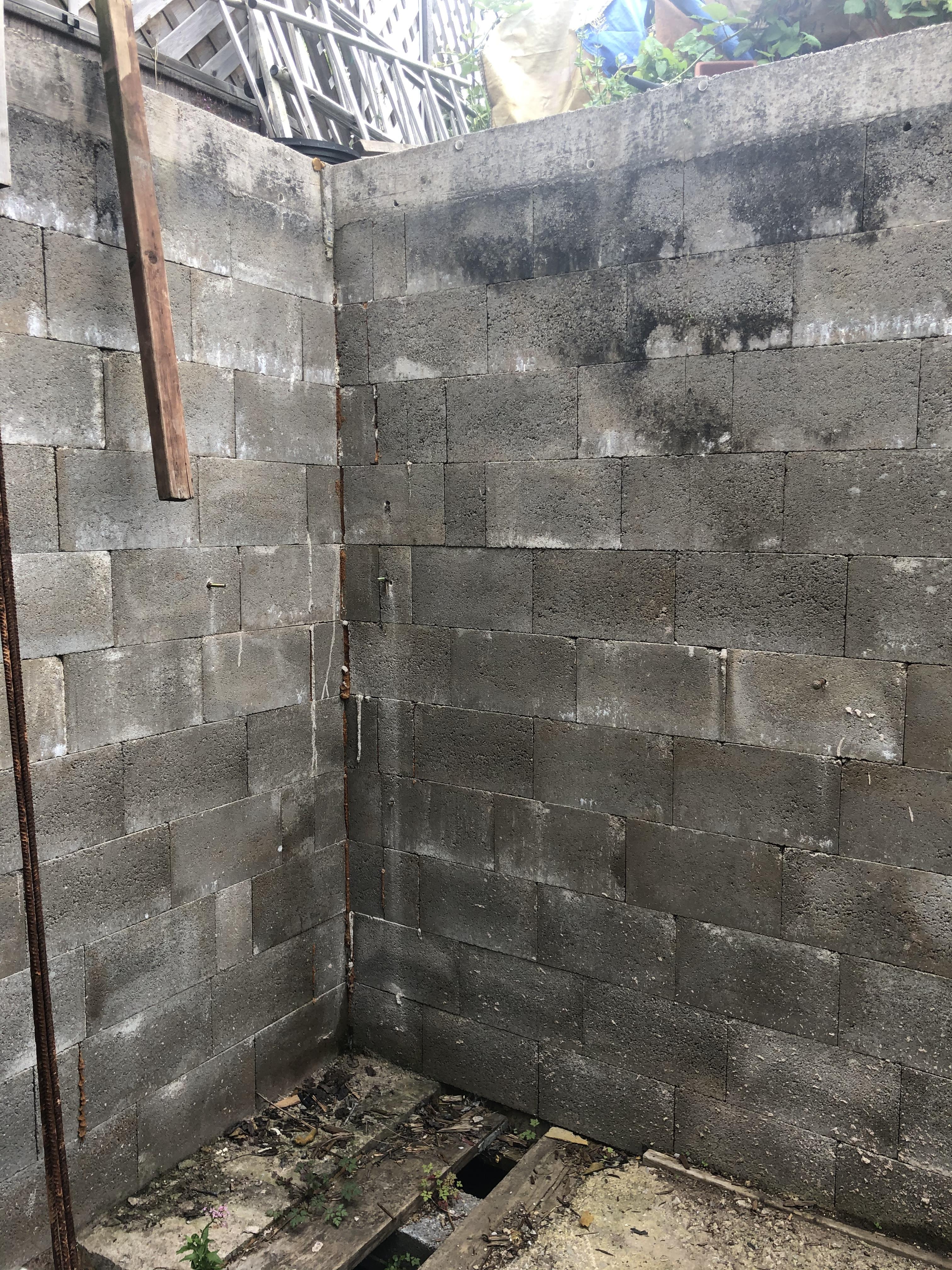

Pocster Posted July 23, 2020 Author Share Posted July 23, 2020 Here’s a better view of the corner . So 4 5m vertical Scaf poles for the corners ( 3 bolted somehow to the wall ) . I guess some kind of metal ‘tray’ for the lift floor . Not sure how to fix that cage together then to winch . Link to comment Share on other sites More sharing options...

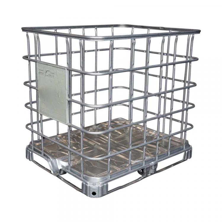

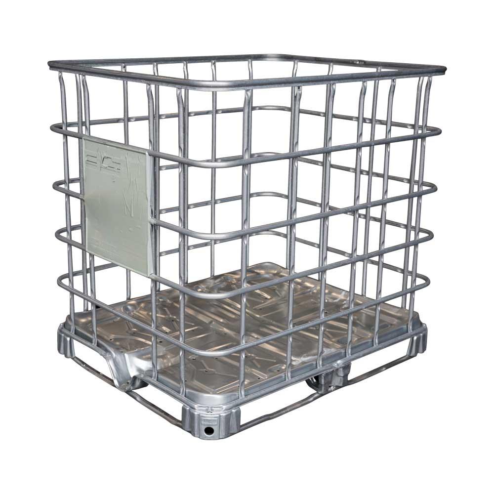

Onoff Posted July 23, 2020 Share Posted July 23, 2020 (edited) IBC cage with a few mods? Ply floor, cut the front out etc. https://hambleys.co.uk/product/1000-ltr-ibc-cage-steel-frame-and-steel-or-plastic-pallet-base/ Edited July 23, 2020 by Onoff 1 Link to comment Share on other sites More sharing options...

Pocster Posted July 23, 2020 Author Share Posted July 23, 2020 59 minutes ago, Onoff said: IBC cage with a few mods? Ply floor, cut the front out etc. https://hambleys.co.uk/product/1000-ltr-ibc-cage-steel-frame-and-steel-or-plastic-pallet-base/ Ooooo ! That looks promising . Have to bolt Scaf poles vertical to each corner to gain the height ... Link to comment Share on other sites More sharing options...

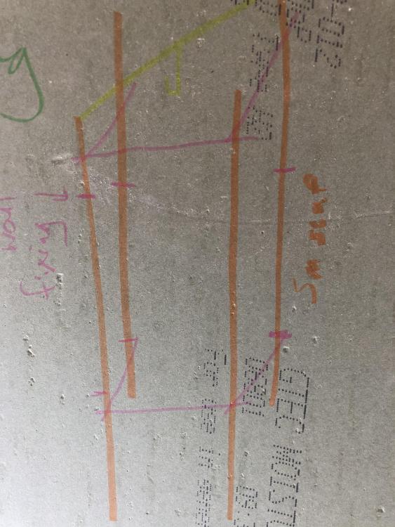

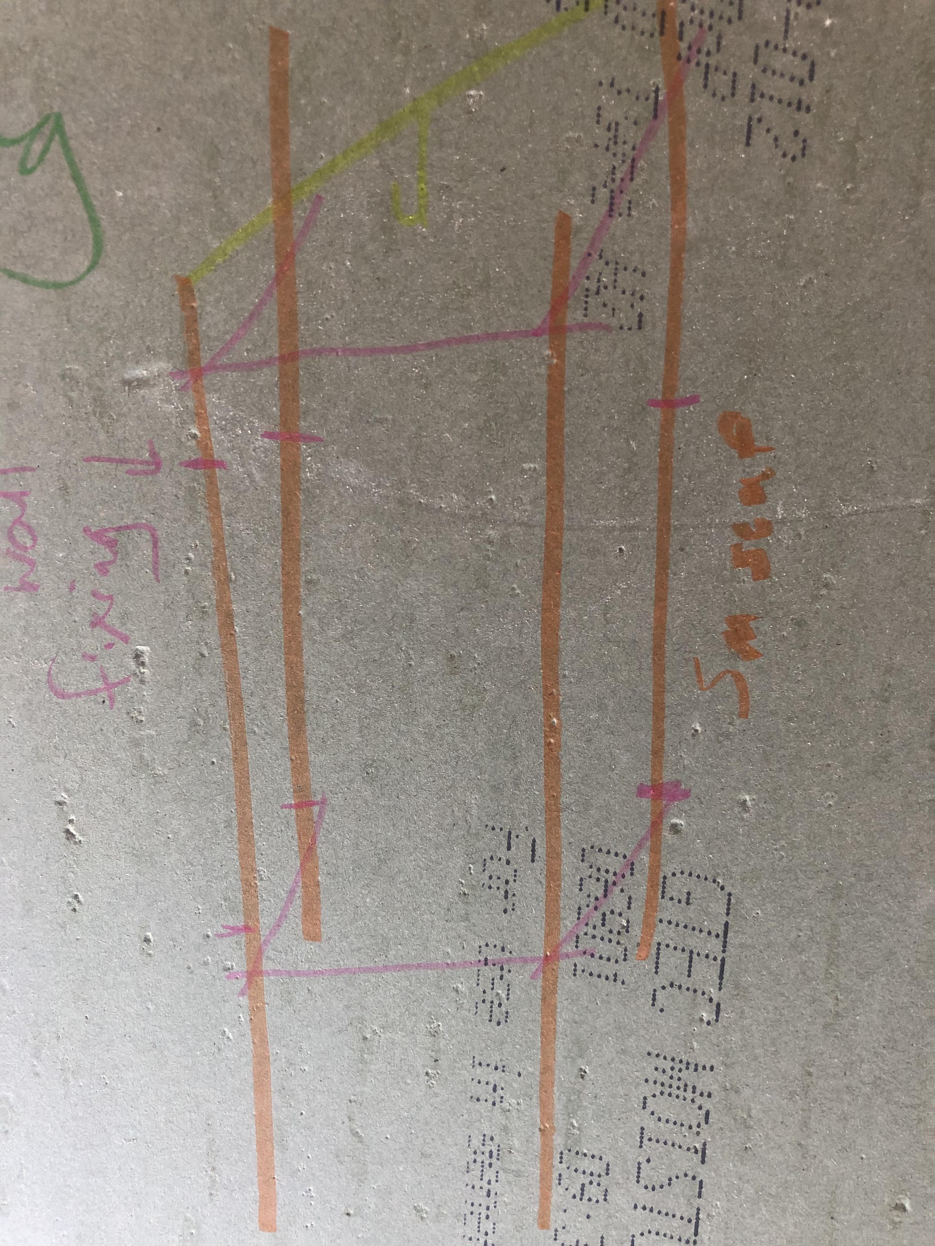

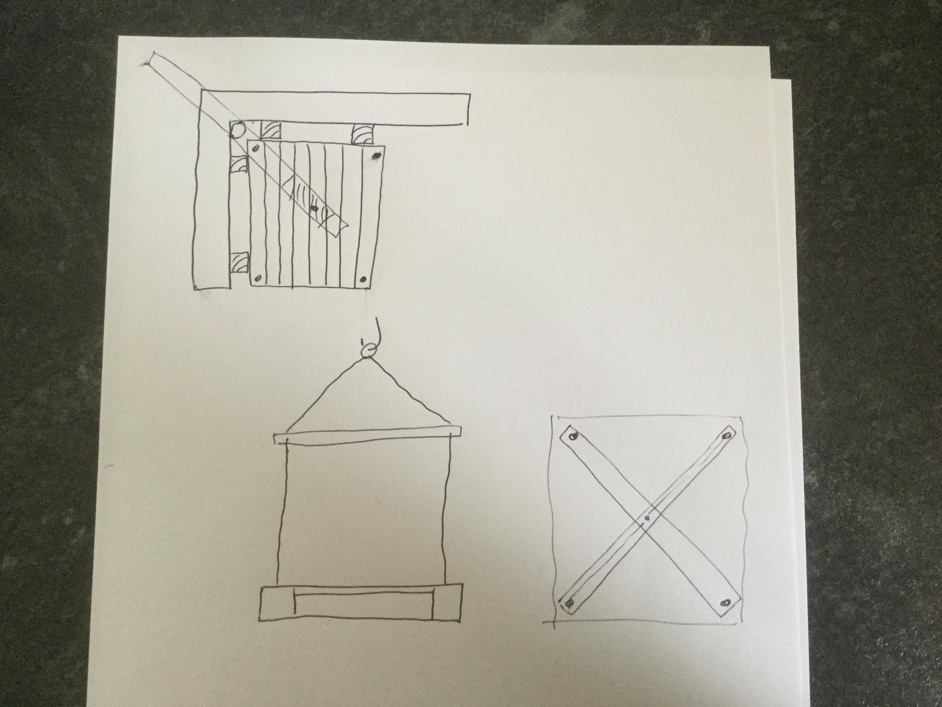

Pocster Posted July 23, 2020 Author Share Posted July 23, 2020 Hmmmmm So let me simplify See excellent drawing . ( my sparky hasn’t turned up today so thinking about a hoist / lift I think is time well spent ) Orange verticals are 4 5m Scaf poles - 3 can be bolted to the wall in the corner Pink horizontal are Scaff for support Yellow is effectively the gantry going from 1 corner to the other . Scaff pole again . This strong enough if the winch was mounted on that ? My issue then is the ‘cage’ - sure I can add timber to ‘guide’ it - so it doesn’t twist etc. Is this basic gantry strong enough ?? Link to comment Share on other sites More sharing options...

Onoff Posted July 23, 2020 Share Posted July 23, 2020 1 minute ago, pocster said: Hmmmmm So let me simplify See excellent drawing . ( my sparky hasn’t turned up today so thinking about a hoist / lift I think is time well spent ) Orange verticals are 4 5m Scaf poles - 3 can be bolted to the wall in the corner Pink horizontal are Scaff for support Yellow is effectively the gantry going from 1 corner to the other . Scaff pole again . This strong enough if the winch was mounted on that ? My issue then is the ‘cage’ - sure I can add timber to ‘guide’ it - so it doesn’t twist etc. Is this basic gantry strong enough ?? What does your SE say? 1 Link to comment Share on other sites More sharing options...

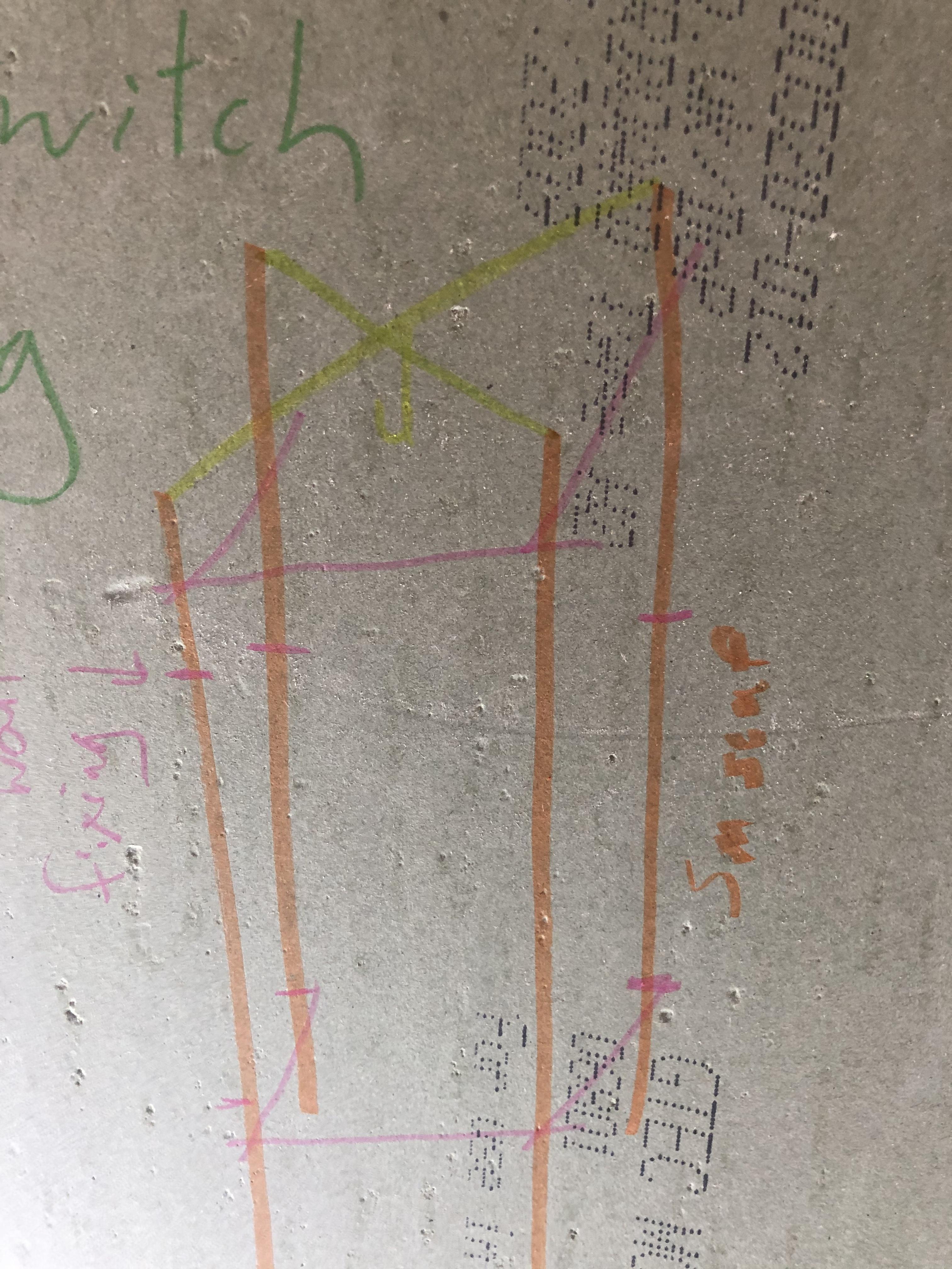

Pocster Posted July 23, 2020 Author Share Posted July 23, 2020 Modification Link to comment Share on other sites More sharing options...
joe90 Posted July 23, 2020 Share Posted July 23, 2020 (edited) 12 minutes ago, Onoff said: What does your SE say? WTF!!!! I don’t see why you need 4 vertical poles, one up the corner bolted to the wall (mostly at the top). Triangulated gubbins at the top like I said before, 4” square timbers up both walls to guide the sides of the pallet (and keep it away from the pole). See crap drawing below regarding spreader bars. Perhaps a scaffold clamp in the corner to stop the platform swinging whilst loading it. Edited July 23, 2020 by joe90 1 Link to comment Share on other sites More sharing options...

Pocster Posted July 23, 2020 Author Share Posted July 23, 2020 (edited) 10 minutes ago, joe90 said: WTF!!!! I don’t see why you need 4 vertical poles, one up the corner bolted to the wall (mostly at the top). Triangulated gubbins at the top like I said before, 4” square timbers up both walls to guide the sides of the pallet (and keep it away from the pole). See crap drawing below regarding spreader bars. Perhaps a scaffold clamp in the corner to stop the platform swinging whilst loading it. I guess spreader bars should be scaf poles? @joe90 I think @Onoff was joking about the SE Was looking at this website for scaf bits. Which clamps etc. should I use??? https://www.scaffolding-direct.co.uk Edited July 23, 2020 by pocster being a twat Link to comment Share on other sites More sharing options...
joe90 Posted July 23, 2020 Share Posted July 23, 2020 2 minutes ago, pocster said: I guess spreader bars should be scaf poles? @joe90 I think @Onoff was joking about the SE Was looking at this website for scaf bits. Which clamps etc. should I use??? Probably best but because they are in compression timber might do. I can just imagine what an SE or health and safety bod would say (but would not stop me doing it!!!,,, swivel clamps like these (swivel clamps allow you to clamp poles that are not at 90’ to each other) https://www.ebay.co.uk/itm/15-x-Scaffolding-Scaffold-Fittings-SWIVEL-DOUBLE-Couplers-Clamps-FREE-DELIVERY/224085486430?hash=item342c892b5e:g:w2cAAOSwKG1fCHBR shame I am so far away, I would love to help build this. Just make sure no building inspectors see it as they will have a fit 1 Link to comment Share on other sites More sharing options...
Pocster Posted July 23, 2020 Author Share Posted July 23, 2020 3 minutes ago, joe90 said: Probably best but because they are in compression timber might do. I can just imagine what an SE or health and safety bod would say (but would not stop me doing it!!!,,, swivel clamps like these (swivel clamps allow you to clamp poles that are not at 90’ to each other) https://www.ebay.co.uk/itm/15-x-Scaffolding-Scaffold-Fittings-SWIVEL-DOUBLE-Couplers-Clamps-FREE-DELIVERY/224085486430?hash=item342c892b5e:g:w2cAAOSwKG1fCHBR shame I am so far away, I would love to help build this. Just make sure no building inspectors see it as they will have a fit I'd love someone who knows what they are doing to build this! ? So! Lets assume I go with https://www.screwfix.com/p/hilka-pro-craft-250kg-electric-hoist/49927?tc=MT8&ds_kid=92700046638549236&ds_rl=1243318&ds_rl=1241687&ds_rl=1245250&ds_rl=1245250&gclid=CjwKCAjwx9_4BRAHEiwApAt0zmiYhGkryHs6GUYHjZoU9BYpvOnVSZZQWLSoE0dtcI2WdEHl1XMm9xoCLmwQAvD_BwE&gclsrc=aw.ds and https://www.screwfix.com/p/hilka-pro-craft-hoist-support-arm-600kg/2240r as you suggest. 48mm scaf pole vertical. I'll buy a few shorter ones ( or perhaps just 1 long one so I can angle grind to suit? ) I then need to make that triangle to counter balance the weight. Not sure what I can / should use for that. Maybe a tank of some sort I can fill with water???? So @joe90 the winch hanging off 1 pole with the hoist support is strong enough on it's own for 100kg? Link to comment Share on other sites More sharing options...
Onoff Posted July 23, 2020 Share Posted July 23, 2020 I think it's more usual to lift from a scaffold "ladder beam". Link to comment Share on other sites More sharing options...
Pocster Posted July 23, 2020 Author Share Posted July 23, 2020 2 minutes ago, Onoff said: I think it's more usual to lift from a scaffold "ladder beam". So this type of thing? https://www.scaffolding-direct.co.uk/alloy-steel-beams/ Provides better strength I assume? Link to comment Share on other sites More sharing options...
Onoff Posted July 23, 2020 Share Posted July 23, 2020 Just now, pocster said: So this type of thing? https://www.scaffolding-direct.co.uk/alloy-steel-beams/ Provides better strength I assume? Yep. Still need to guard against twisting. A local scaffold co would likely knock you something up quite cheap. Link to comment Share on other sites More sharing options...
