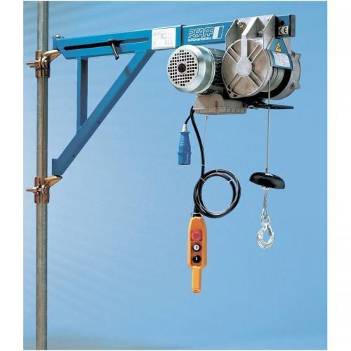

joe90 Posted July 22, 2020 Posted July 22, 2020 1 hour ago, pocster said: Now we're cooking. Any photo's of your creation? sorry, no but I just bought one of those I posted and put a couple of scaffold poles sticking out the side to winch stuff up.. 1
Pocster Posted July 22, 2020 Author Posted July 22, 2020 4 minutes ago, joe90 said: sorry, no but I just bought one of those I posted and put a couple of scaffold poles sticking out the side to winch stuff up.. ok . So how do you fix the winch to the scaffolding?
Reiver Posted July 22, 2020 Posted July 22, 2020 6 minutes ago, pocster said: ok . So how do you fix the winch to the scaffolding? From @joe90 's pic it appears to have a couple of clamps on the top. Good price for a unit like that, might just buy myself one for the workshop. 1
Pocster Posted July 22, 2020 Author Posted July 22, 2020 1 minute ago, joe90 said: Stupid question but shouldn't the gantry be supported the otherwise?. I've no idea how strong a scaff pole is taking any weight like that.
joe90 Posted July 22, 2020 Posted July 22, 2020 https://www.screwfix.com/p/hilka-pro-craft-250kg-electric-hoist/49927?tc=MT8&ds_kid=92700046638549236&ds_rl=1243318&ds_rl=1241687&ds_rl=1245250&ds_rl=1245250&gclid=CjwKCAjwx9_4BRAHEiwApAt0zmiYhGkryHs6GUYHjZoU9BYpvOnVSZZQWLSoE0dtcI2WdEHl1XMm9xoCLmwQAvD_BwE&gclsrc=aw.ds and https://www.screwfix.com/p/hilka-pro-craft-hoist-support-arm-600kg/2240r depends what weight you want to lift, I think the above is rated at 250kg. that other one in the picture is about £1400 ? 1
Pocster Posted July 22, 2020 Author Posted July 22, 2020 1 minute ago, joe90 said: https://www.screwfix.com/p/hilka-pro-craft-250kg-electric-hoist/49927?tc=MT8&ds_kid=92700046638549236&ds_rl=1243318&ds_rl=1241687&ds_rl=1245250&ds_rl=1245250&gclid=CjwKCAjwx9_4BRAHEiwApAt0zmiYhGkryHs6GUYHjZoU9BYpvOnVSZZQWLSoE0dtcI2WdEHl1XMm9xoCLmwQAvD_BwE&gclsrc=aw.ds and https://www.screwfix.com/p/hilka-pro-craft-hoist-support-arm-600kg/2240r depends what weight you want to lift, I think the above is rated at 250kg. that other one in the picture is about £1400 ? STAR!. I want to go up and down on it
joe90 Posted July 22, 2020 Posted July 22, 2020 Just now, pocster said: Stupid question but shouldn't the gantry be supported the otherwise?. I've no idea how strong a scaff pole is taking any weight like that. we didn’t winch much weight but we triangulated poles to stop the poles bending. What weight are you looking to lift?

joe90 Posted July 22, 2020 Posted July 22, 2020 Found this in the screwfix reviews " Purchased this hoist for loft conversions, lifted 2 steels with no problem, use with a sheet clamp it shifted ply and plasterboard without a problem Wished id bought it sooner " ?. I should be on commission 1
Pocster Posted July 22, 2020 Author Posted July 22, 2020 Just now, joe90 said: Found this in the screwfix reviews " Purchased this hoist for loft conversions, lifted 2 steels with no problem, use with a sheet clamp it shifted ply and plasterboard without a problem Wished id bought it sooner " ?. I should be on commission I think this is the way to go. I'll contact a scaff seller and propose what I'm planning to do - see how helpful ( or comical ) they are.

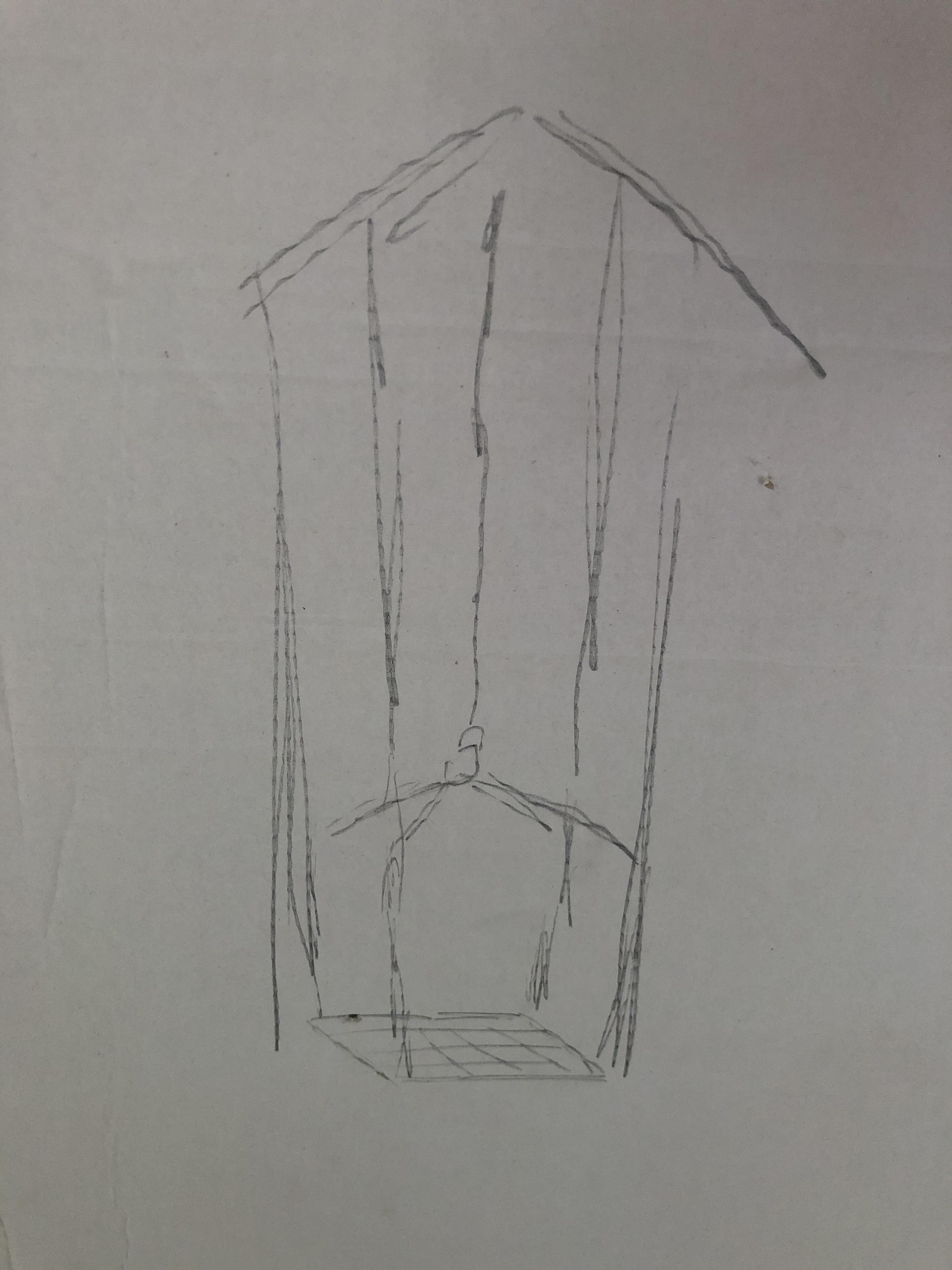

joe90 Posted July 22, 2020 Posted July 22, 2020 (edited) How about this, pole in corner of basement fixed to walls, then this above (excuse the drawing). Duh, can’t rotate it! Edited July 22, 2020 by joe90 1

Pocster Posted July 23, 2020 Author Posted July 23, 2020 12 hours ago, joe90 said: How about this, pole in corner of basement fixed to walls, then this above (excuse the drawing). Duh, can’t rotate it! Rotating it won't be an issue if I have a platform and have the winch much higher - literally like a lift. I need to think how the winch connects to the platform ; otherwise I'll have steel cable going from each corner of the platform to a point above causing a much smaller area.
