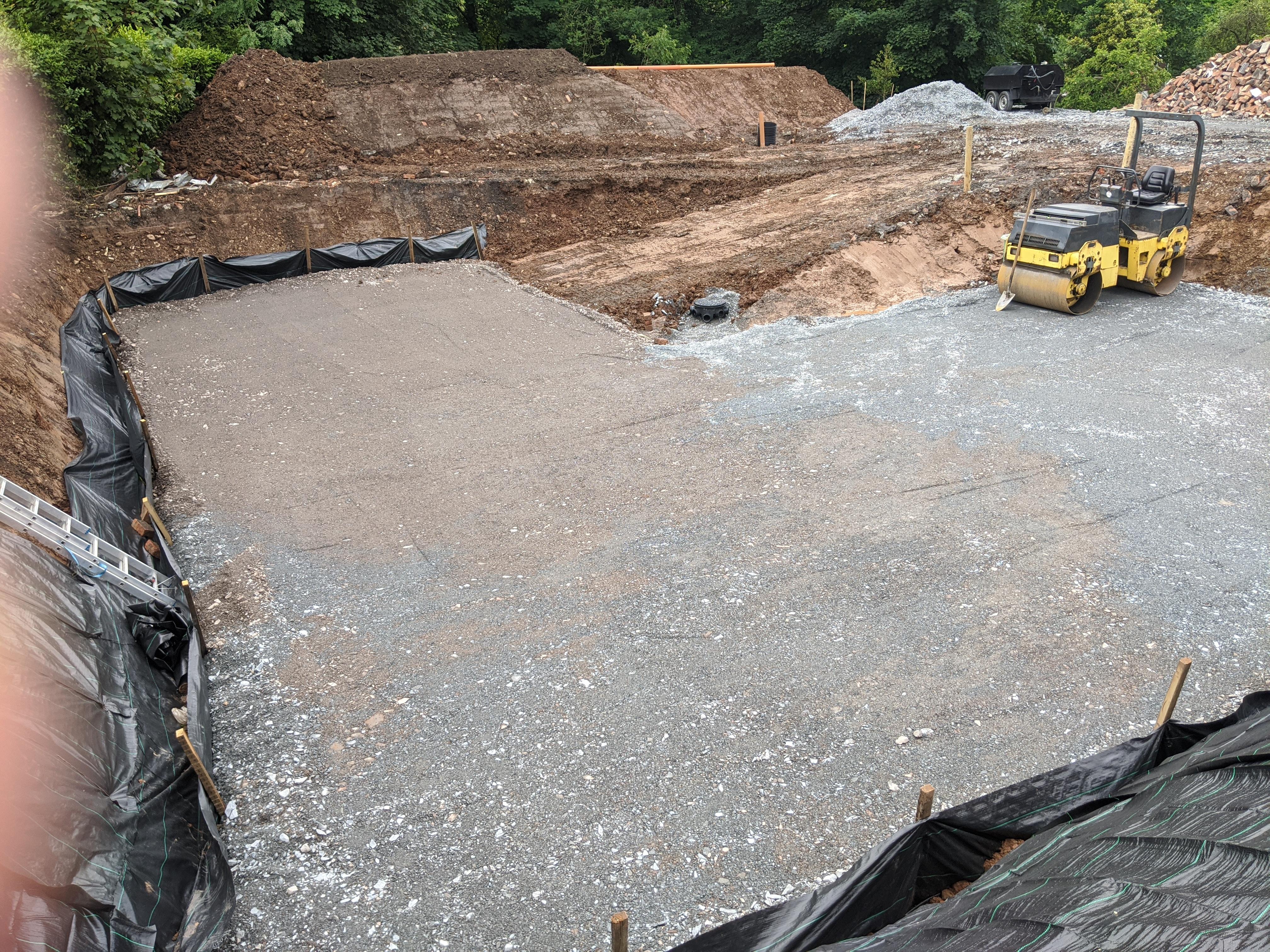

So, we got final tenders in last week. The winning tender has £39,500 for a 100m² basement. That includes:
200mm ground bearing slab and tanking (ground works done and compacted stones laid already)
All steel reinforcement
ICF walls up to ground level
Tanking for ICF
Perimeter drain, backfilling with clean stone
Fyi our ground works: site clearance, excavation, main drainage works, muckaway, under slab stoned with 150mm type 3, access road and working areas stoned, is coming in at about £14k. Still waiting for the final bill. That was basically a man with a digger @ £40/hr + materials.
Tanking for ICF
Fyi our ground works: site clearance, excavation, main drainage works, muckaway, foot printed stones with 150mm type 3, access road and working areas stones, is coming in at about £14k. Still waiting for the final bill.
Just make sure what is included in your quote, but sounds pretty good.

Quick update, I received a ballpark groundworks quote for 14,000 to effectively prep a 130sqm site and dig the hole of the basement. Demo of the previous house not included since they need to see the site. Seems fairly reasonable.
So.. that gives me "100,000" for effectively everything that's underground.
When it comes to the famous 'rule of thumb' - 1500-3000 per sqm, let's say 2250 for now - how much does that drop if the entire foundation can be assumed to be there? Putting it differently- how much would 'just groundworks+foundation' normally cost for 130sqm?
(very much in general, yes I'm aware this can all change based on what SE finds etc..)
