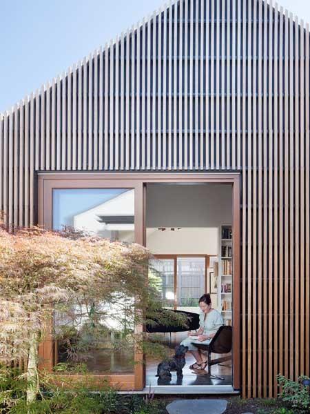

GaryM Posted July 9, 2020 Posted July 9, 2020 Hi All, I'm just starting a project of remodelling our house, which includes lifting the roof and adding a second story. My intention is to clad the first floor with Siberian larch vertical 44mm x 44mm battens similar to the attached. To test the idea out I will use it on some outbuildings, However I'm finding it very hard to find details in the technique. The outbuildings are brick so I will not use UV membrane, ( i will on the house). I will use chamfered horizontal battens attached to the wall with masonry screws, for the houses I will use thin vertical battens, then chamfered horizontal battens. Then the vertical cladding battens will be fixed via cladding screws to the horizontal battens. All the information I'm finding on line is mainly standard closed joint cladding and does not seem appropriate, i.e. use mesh to stop vermin or details around openings. Can anyone point me to any appropriate information. Thanks Gary

the_r_sole Posted July 9, 2020 Posted July 9, 2020 you might get some technical info from a supplier like Russwood who seem to do a fair bit of rainscreen cladding - the one you've posted there, worries me a bit, I'd always want a capping piece rather than having the end of the battens exposed to the weather... (I've actually just done something similar on bits of my house, where I used siberian larch cladding under windows (to cover a bizarre 60's brick detail!) - I used the rawl masonry screws for the battens and then the proper cladding screws for the battens, I tried to leave 10mm gaps, but each section was slightly different. Very painful measuring it out. With a rainscreen, the membrane is really doing the heavy lifting but I've seen various details for window heads/reveals etc - try and find one you like and post it up, can probably work it backwards! (I've seen one before where they had put a bugscreen over the entire wall (over horizontal battens and under the cladding) I didn't bother with mine as it's superficial anyway!

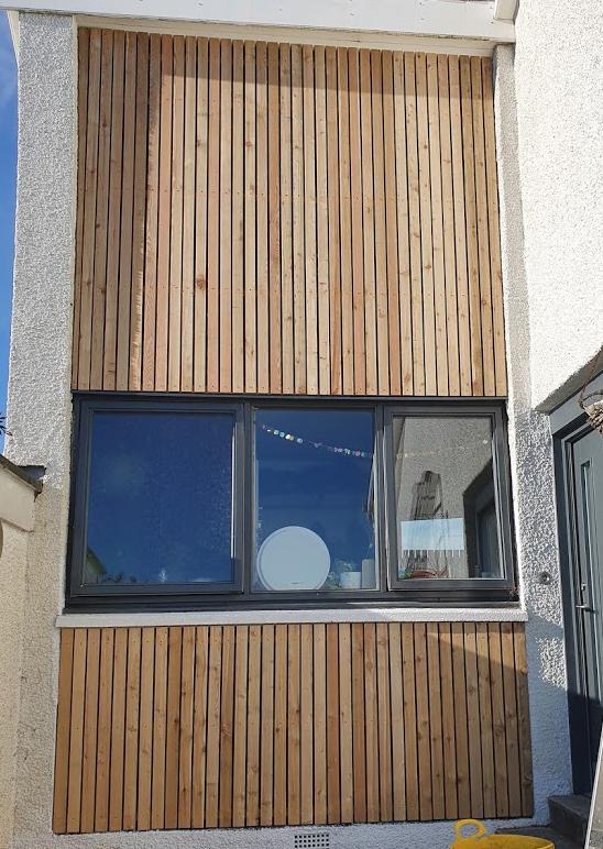

the_r_sole Posted July 10, 2020 Posted July 10, 2020 always good to overthink it ? I'll tell you how I did it... not quite as scientific. Put batten on either end, measure from outside edge of one side to inside edge of the other - divide by the width of the batten plus gap (so for me it was 70mm - 60mm battens +10mm) And that gives you an approximate number of battens you'll need, so then take the whole number and divide the gap by that... I was generally getting figures like 70.3mm for the gaps, so what I did was measure it in 10s (much easier to measure 703mm than 70.3...) then I had a piece of wood marked with the 70.3 on it and marked that along the top counter batten (so it gives you the outside edge of all the battens) and by the time you've marked 10 you can see how far out you are!! I was also only marking spacing at the top, then trying to make them level but I didn't have huge lengths to deal with. Probably better to take some professional advice on it, mine was very much having a stab! I also believe you can get an app which will work out your spacing for you... have you got windows close together, you'd be amazed at how you can adjust the gaps very slightly to accomodate, I only scribed one length where the top of the wall was 30mm out from the bottom ? but everywhere else we managed full boards

the_r_sole Posted July 10, 2020 Posted July 10, 2020 that's a bit of mine, you can see the interesting wall lean on the left... but the gaps are all over the place if you look close up, but you get away with it (just about) over the full width - as I said, if you measure then 10 at a time, you can make sure you're not too far out overall!
ToughButterCup Posted July 10, 2020 Posted July 10, 2020 That leaning left wall... relaxing to look at, that. But illustrates the principle that as @Ferdinand says, God is the bloody details. He puts it more politely .
