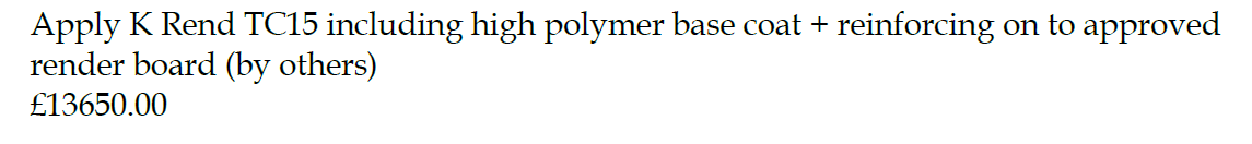

SuperJohnG Posted July 29, 2020 Posted July 29, 2020 @LA3222 how did you finally get on with this in the end? I'm just getting some prices back and seems I might have underestimated heavily. I'm getting quoted 70/m2 for rendering. see here for doing 195m2: I'd (likely wrongly!) used 23 for material and 26 for labour for Monocouche render on cement board. I assumed this was supply of board, mounting, and then render finish. Does this seem stupid now? @nod would you be able to help shed any light if I'm miles off. Slowly bit by but my budget seems to be getting blown to pieces.

SuperJohnG Posted July 29, 2020 Posted July 29, 2020 (edited) Thanks @LA3222 I'm Glasgow area. That figure ties in with what the local render supplier estimates for my job (10k for 200m2), for Labour and material for K rend TC15, so my price may be somewhat overpriced. However I seem to have omitted to add the actual cost of the render board itself in my budget. Edited July 29, 2020 by SuperJohnG
SuperJohnG Posted June 28, 2021 Posted June 28, 2021 Just an update on this...I have just been quoted 90 per sqm for TC15 on renderboard. Materials and labour. Seems someone is pulling leg maybe?

SuperJohnG Posted June 28, 2021 Posted June 28, 2021 54 minutes ago, nod said: Be wary of cash for render You will need a guarantee This is the bit that worries me. Although 90 sqm seems excessive. Do you think? (Scotland btw. Central belt).

nod Posted June 29, 2021 Posted June 29, 2021 5 hours ago, SuperJohnG said: This is the bit that worries me. Although 90 sqm seems excessive. Do you think? (Scotland btw. Central belt). 90 is double what I’m charging building companies But contractors no self builders options are limited at the moment 1
SuperJohnG Posted September 2, 2021 Posted September 2, 2021 I've just had an updated quote. £8841 for labour only applying K rend TC15. This includes fitting all beads etc. Thats for around 195sqm including the windows area as that. Thats £45 per sqm the work looks good. But is he ripping the pish? Also wants 25% deposit up front 8 weeks before he even starts? I'm desperate to get it done before winter. If I don't I'll need the scaffold for an extra 3-4 months at maybe 2500 extra.
AliG Posted September 6, 2021 Posted September 6, 2021 If you cannot get someone cheaper then it is tough. But really a 25% deposit on a labour only job. What does he need that for?
SuperJohnG Posted September 7, 2021 Posted September 7, 2021 On 06/09/2021 at 16:14, AliG said: If you cannot get someone cheaper then it is tough. But really a 25% deposit on a labour only job. What does he need that for? The deposit was a red herring. That was if he was buying material so sorted now. I've booked him and seen his work now that looks excellent. K rend rep reckons he'd only recommend this guy ans one other in Scotland to do the work so here's hoping it's good.
