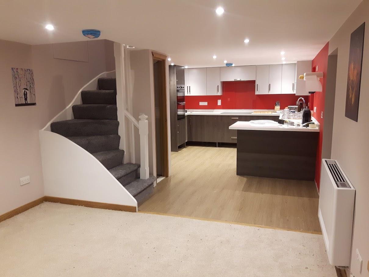

Hobbiniho Posted June 24, 2020 Posted June 24, 2020 i bought a large access panel from a company in lithuania, i found them for sale in the uk but only the smaller sizes, the postage was very fast it depends on what you want as i went for the plasterboard hatch but they have many other types of hatches availiable https://www.el-vent.com/en/alustar-mega-large-dimensions-access-doors. you can see the hatch that i bought half way up the stairs, this covers my consumer unit, broadband router etc
