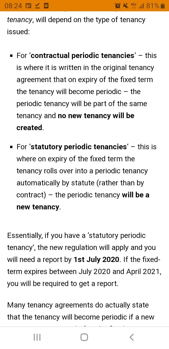

Onoff Posted June 23, 2020 Share Posted June 23, 2020 @Ferdinand, @pocster I've a long term tenant in a property who should have moved out by now into social housing but it keeps getting delayed due to this Covid thing. I'm aware that any new tenancy from 1st July 2020 this year requires an EICR. The property in question had an EICR within the last 5 years. However, my existing tenant has in effect gone onto a statutory periodic tenancy as I see it, the fixed term having expired. I really don't want to be having an EICR done now then in 2 or 3 months time when they move out, another one done for the new tenant. Thoughts please! This from some random landlord blog: Link to comment Share on other sites More sharing options...

Pocster Posted June 23, 2020 Share Posted June 23, 2020 39 minutes ago, Onoff said: @Ferdinand, @pocster I've a long term tenant in a property who should have moved out by now into social housing but it keeps getting delayed due to this Covid thing. I'm aware that any new tenancy from 1st July 2020 this year requires an EICR. The property in question had an EICR within the last 5 years. However, my existing tenant has in effect gone onto a statutory periodic tenancy as I see it, the fixed term having expired. I really don't want to be having an EICR done now then in 2 or 3 months time when they move out, another one done for the new tenant. Thoughts please! This from some random landlord blog: Why do you think you might need 2 checks ? Every 5 years . Any new tenancy from July needs one if it doesn’t exist . This is my understanding. As @nod says you are allowed to use common sense . If in doubt or worried put something in writing to the tenant . Because it does happen that the tenant might try to leverage you for ‘breach of law’ for not having one done . Link to comment Share on other sites More sharing options...
ProDave Posted June 23, 2020 Share Posted June 23, 2020 Up here it is every 5 years or change of tenancy. You could be in the ludicrous position of re doing one after the tenant has been in 5 years, then they leave the next week so you have to do it again for the next tenant (I would just change the date ) BUT at the moment, due to Covid-19 and restrictions on work and movement, I believe all statutory checks have been suspended / extended so check the exact rules, that will probably give you the grace you need and get it done after this tenant has eventually moved on Link to comment Share on other sites More sharing options...

Pocster Posted June 23, 2020 Share Posted June 23, 2020 25 minutes ago, nod said: We are through a nationwide agent and every 5 years per property seems to be the norm While we don’t have much of a turnover of tenants We wouldn’t have more than one test in 5 years Our Electrian normally says allow an afternoon and will need access to every room I think it would be reasonable for a tenant to refuse access for this Certainly this side of Christmas This is my interpretation; as I’ve always done with HMO’s one every 5 years . Not one every time a tenant changes . I would check with your local council or ring a letting agent and pretend you are interested in using them - and see what they say . Otherwise with that logic if a tenants contract is min 6 months and they leave then throughout 5 years you could in theory have 10 tenants - 10 eicr ? I don’t think so . Link to comment Share on other sites More sharing options...

Onoff Posted June 23, 2020 Author Share Posted June 23, 2020 59 minutes ago, pocster said: Why do you think you might need 2 checks ? Just the oddity that in this case the tenancy has ended and gone onto a periodic even though it's the same tenant. This as I undersatnd it is considered a new tenancy albeit with the same tenant. I can't even get my tame NAPIT mate to do the EICR now as he's peed off with the whole requirement he has a specific EICR ticket now and refusing to pay the £600 p/a fee it'll now cost him. Even though he has his 2391 etc. He's busy enough with commercial stuff anyway. Link to comment Share on other sites More sharing options...

Pocster Posted June 23, 2020 Share Posted June 23, 2020 1 minute ago, Onoff said: Just the oddity that in this case the tenancy has ended and gone onto a periodic even though it's the same tenant. This as I undersatnd it is considered a new tenancy albeit with the same tenant. I can't even get my tame NAPIT mate to do the EICR now as he's peed off with the whole requirement he has a specific EICR ticket now and refusing to pay the £600 p/a fee it'll now cost him. Even though he has his 2391 etc. He's busy enough with commercial stuff anyway. When was the last eicr done ? Link to comment Share on other sites More sharing options...
Onoff Posted June 23, 2020 Author Share Posted June 23, 2020 4 minutes ago, pocster said: When was the last eicr done ? 2018. He did the original Electrical Installation Certificate for the new cu back in 2013. Seems madness he can't now do the EICR again without a new bit of paper. Link to comment Share on other sites More sharing options...
