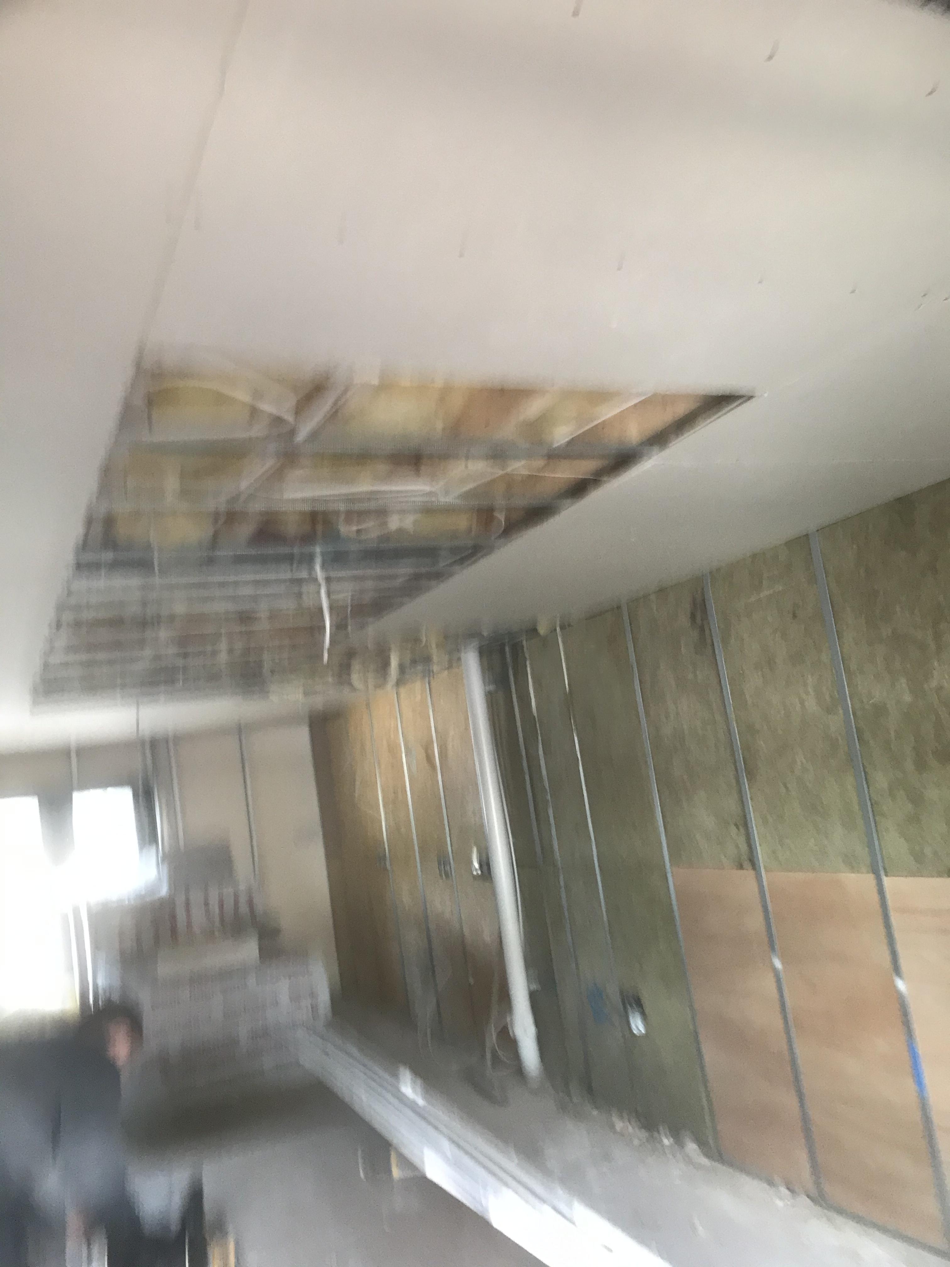

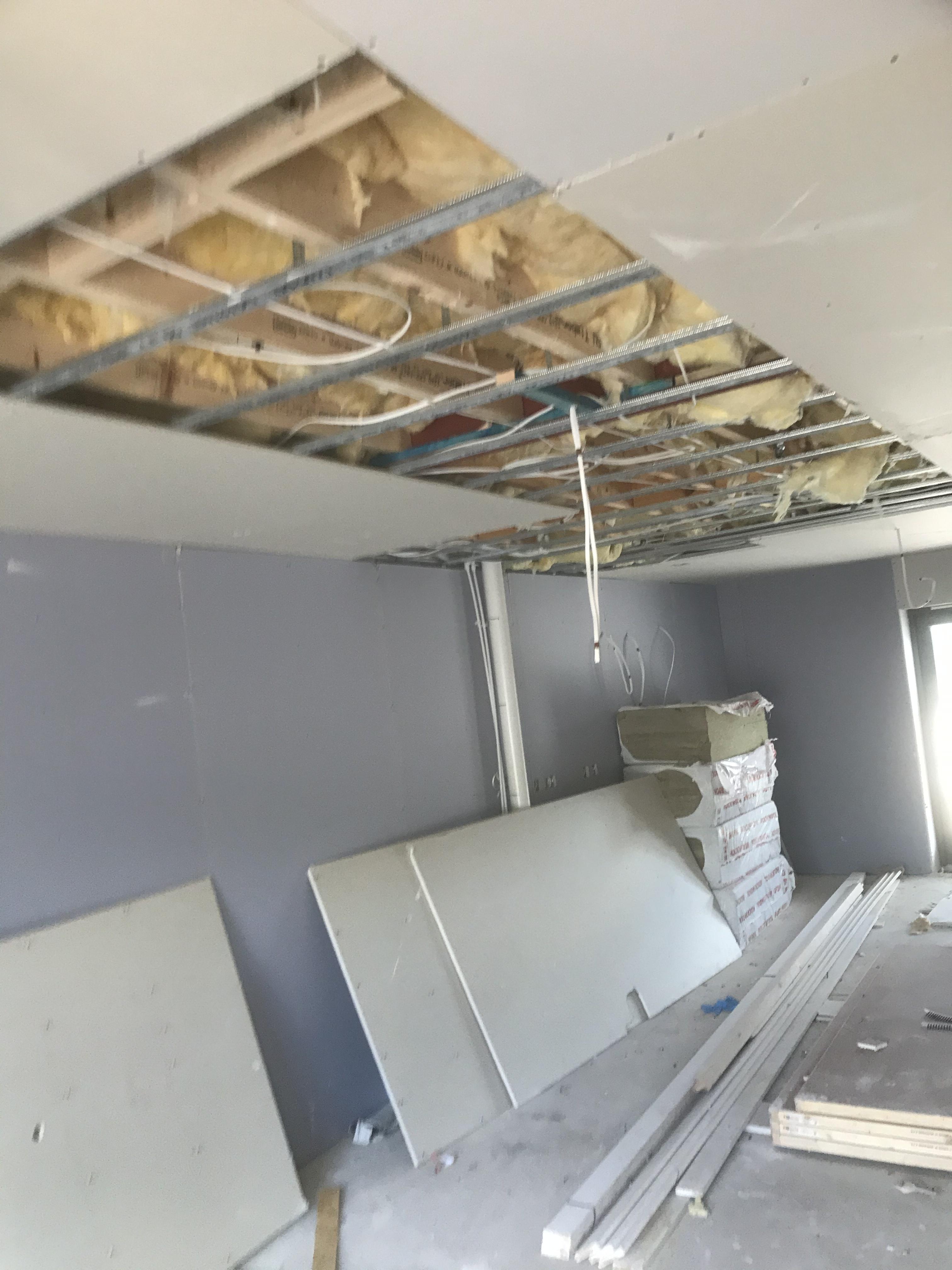

nod Posted June 21, 2020 Share Posted June 21, 2020 1 hour ago, ProDave said: Before every time for me. Means you can see from the screws where all the joists and noggins are, and you can be SURE once you have cut the hole you can reach the cable (and if there is a problem pop a board off and investigate. Then leave the cables coiled up just next to the hole so you can fish them out. If the spread grumbles, he will still get on and do it. Anything else, unless you are VERY careful and take LOTS of measurments, you risk drilling into a joist, or not finding a cable where you expect one. As a plasterer it pains me to say Before Much easier to skim without them cut But if you loose a wire or trap one when boarding its only five minutes to take a board down Pictures where taken two weeks ago After skimming one plot the electrician realized he had placed a row of Dow lights on a RSJ Expensive mistake Four other plots we where able to remove a few boards for him No real drama Link to comment Share on other sites More sharing options...
