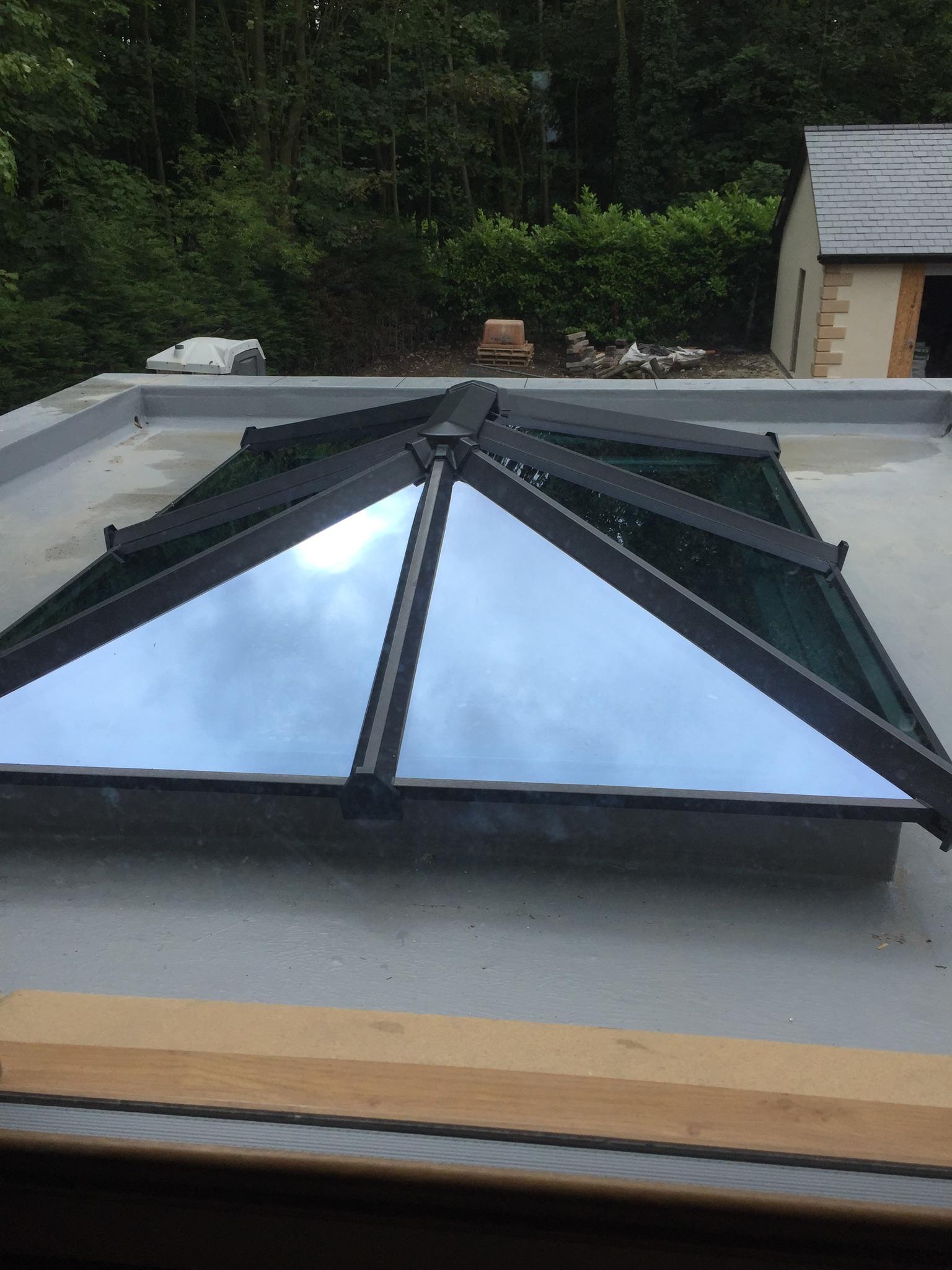

Tony K Posted June 15, 2020 Share Posted June 15, 2020 (edited) Hi All My selfbuild is a single storey, L-shaped, 100m2 flat roof bungalow with GRP roof finish. Quotes for the roofing are coming in unreasonably high when the roof construction is so straightforward I reckon I could build it myself. The question is though, how feasible is it to do GRP covering myself? I've looked at videos online which make it seem like something one could learn, but is it really? I will have about 8 or 9 small non-opening rooflights to fit. They will just sit above the gaps between the joists, but will need upstands in the GRP. Any experience of trying this as a DIY project? Edited June 15, 2020 by Tony K Link to comment Share on other sites More sharing options...

joe90 Posted June 15, 2020 Share Posted June 15, 2020 I taught myself how to do GRP using on line tutorials (several different ones). As @SteamyTea says everything has to be bone dry and very temperature dependant but it is do able, might be best to get some help in (many hands make light work). I have done quite a few flat roofs in GRP and not had any problems. Link to comment Share on other sites More sharing options...
andyscotland Posted June 15, 2020 Share Posted June 15, 2020 I did a 30-ish sqm L-shaped roof with 4 rooflights on upstands, having taught myself from online tutorials and advice here. The actual GRP wasn't a drama. However, the entire process took a lot longer than I expected - it takes a fair while to detail all the corners, upstands, etc both for the boarding out and then again for the GRP - and far longer than any likely spell of continuous dry weather in Edinburgh. So my boards got wet, and things went downhill from there... It might be possible to go faster with more hands, but I think when you've upstands etc to do there's a limit on how fast you can go even with help. Once I admitted weather-defeat and built a heath robinson tent over the entire roof and got it all dried again it worked OK and I'm very pleased with the end result. So, if you can get the weather for it, or you follow @SteamyTea advice to laminate the boards inside first, or you build a tent from the get-go, then it's a great product and it's very easy to DIY. But there is scope for a lot of drama and stress if you time it wrong / take longer than you think you will. 1 Link to comment Share on other sites More sharing options...

nod Posted June 15, 2020 Share Posted June 15, 2020 I had no experience either while ours was only 20 m2 I had upstand around the perimeter and the lantern As Joe has already pointed out Everything must be dry Semi skilled at best 2 Link to comment Share on other sites More sharing options...
