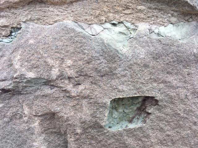

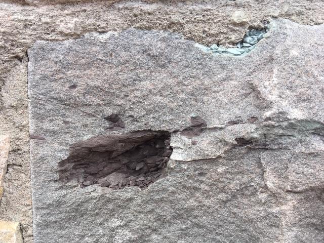

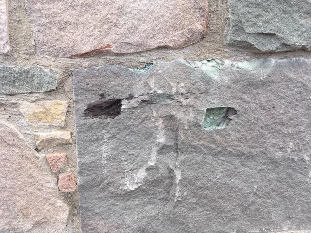

Redoctober Posted June 9, 2020 Posted June 9, 2020 (edited) Hi all. Within my external wall, I have one particular stone that is showing signs of erosion - see images. Is this something to be concerned about or do I have too much time on my hands???? Edited June 9, 2020 by Redoctober to create a gap between photos.
Reiver Posted June 9, 2020 Posted June 9, 2020 Interesting (from a geological point of view) - roughly whereabouts are you in the Borders? If in doubt I would whack some mortar in there to prevent any frost damage...... but I can't imagine surface damage on one stone is going to cause any problems for the house. 1

Redoctober Posted June 9, 2020 Author Posted June 9, 2020 Hi @Reiver we are in the Eastern side of the Borders and the stone concerned is either from Perthshire or Cumbria as the make up of the wall is a combination of Perthshire stone, Cumbrian stone and Borders Buff. @Russell griffiths funny, I did actually now the lawns today, all 600 as metres of it.??. Thanks for your thoughts anyway, much appreciated?
Reiver Posted June 9, 2020 Posted June 9, 2020 39 minutes ago, Redoctober said: Hi @Reiver we are in the Eastern side of the Borders and the stone concerned is either from Perthshire or Cumbria as the make up of the wall is a combination of Perthshire stone, Cumbrian stone and Borders Buff. @Russell griffiths funny, I did actually now the lawns today, all 600 as metres of it.??. Thanks for your thoughts anyway, much appreciated? Aaah, I thought it might be from Cumbria because of the blue-ish colour, it'd be from the Borrowdale volcanic group. With such rock being formed from a random series of massively violent eruptions (the likes of which we don't see these days thankfully) small local imperfections/interruptions are not uncommon; my pals who work in the quarries here are always cursing them as they spoil a nice run of stone that would otherwise make a huge kitchen worktop they could sell to some WAG for her kitchen for £££££. I'm sure the vast majority of other bits of similar stone in your build will be fine. 1 1
Cpd Posted June 10, 2020 Posted June 10, 2020 As previously mentioned clean it out and pop a bit of mortar in there as good practice to prevent front damage. 1
