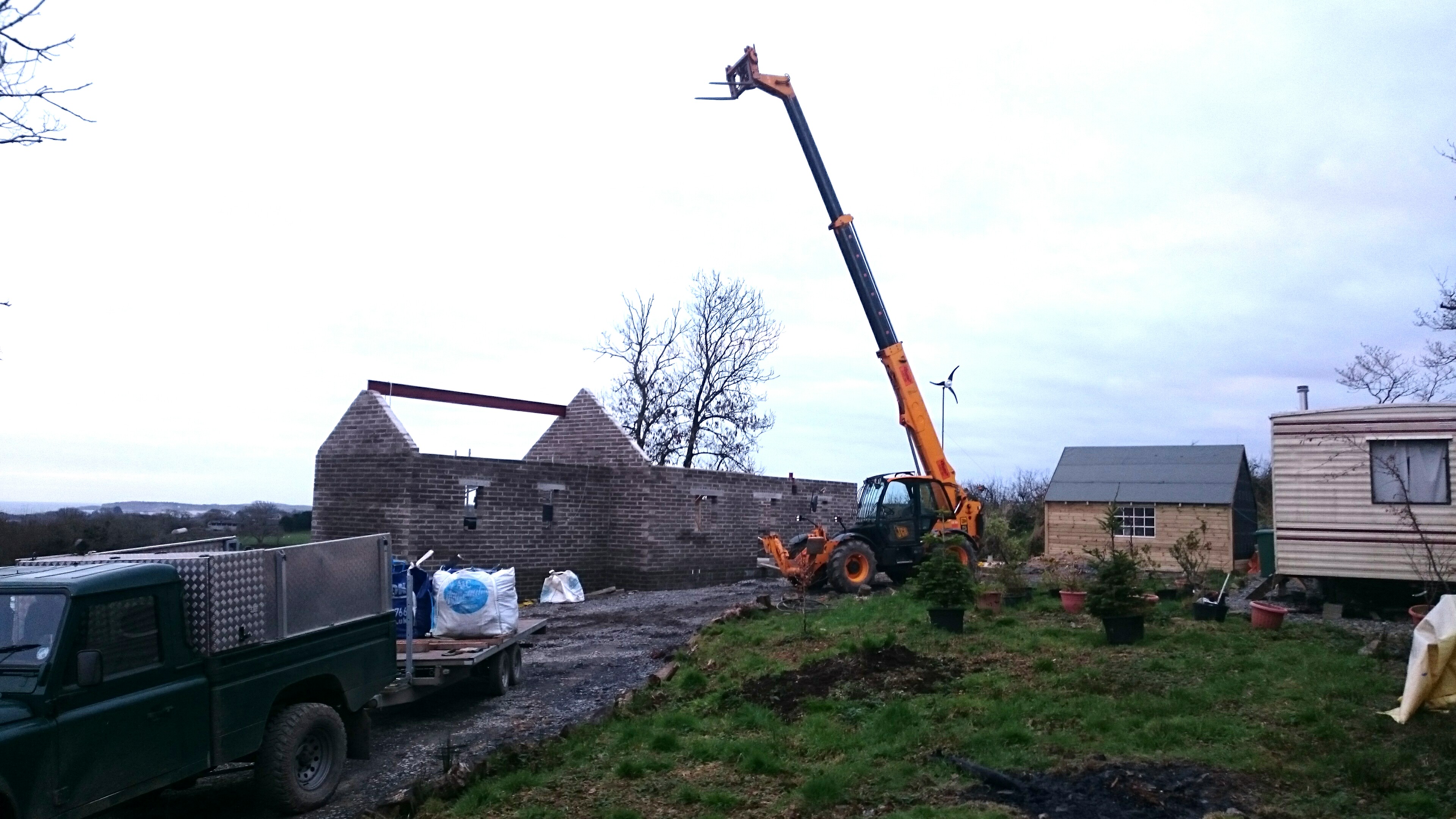

MarkH Posted December 14, 2016 Share Posted December 14, 2016 I've got two 6m steel I-beams to serve as the lintel above a sliding glass door, one to support a mezzanine and one more to serve as the ridge beam in part of our build. We're rust-proofing at the mo and I've got to weld some roof timber related stuff on the mezzanine beam but after that they'll be going onto the walls. We have substantial walls - 215mm dense concrete block laid on flat - so no padstones required. I've a couple of things I'd appreciate advice on though: Is it usual to just sit beams on blocks or should I put a slip-plane of some kind (like some dpc) between the steel and the block? On similar lines I've got about six courses of blocks to lay on top of the window lintel-beams - again, slip-plane required? DPC? Thanks anyone who can point me at the right way! Link to comment Share on other sites More sharing options...

MarkH Posted January 9, 2017 Author Share Posted January 9, 2017 I-Beams in, no drama. It was a lot of fun. We hired a telehandler with a 10m arm. I went to our local hire place and asked if they had "a thing for lifting stuff over a five meter wide house". The guy took us round to the yard, jumped in the machine and extended the arm, I said "that'll do" and next morning they left the beast at the end of our lane. I like that in the age of the hi-vis vest you can hire a large machine like that without going on a course or having a certificate, or wearing a hi-vis vest. Link to comment Share on other sites More sharing options...
