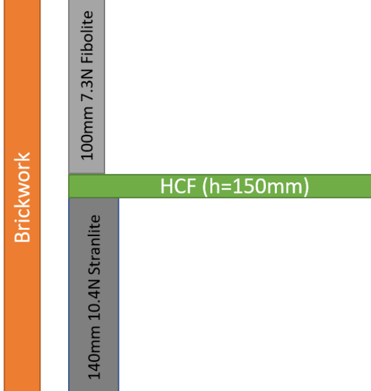

MortarThePoint Posted June 25, 2020 Author Share Posted June 25, 2020 I'm ordering the blocks (ouch) and made a decision I thought I'd gauge people's thoughts on [over-analysing hat on again]. I decided to stick with a single 7.3N block type, rather than using 7.3N Fibolite for the inner leaf of exterior walls and 7.3N Stranlite for the load bearing partitions. So Fibolites for both wall types. I saw the pros and cons as: Pro's to using Fibolite internally: single block type for brickies order simplicity Con's cost (51.4m2 @ £1.52/m2 difference --> £78.18) acoustics? lower thermal mass (950 vs 1350) Bit worried about the acoustic side of it. Does anyone have any experience of how well Fibolite blocks damp sound? Link to comment Share on other sites More sharing options...

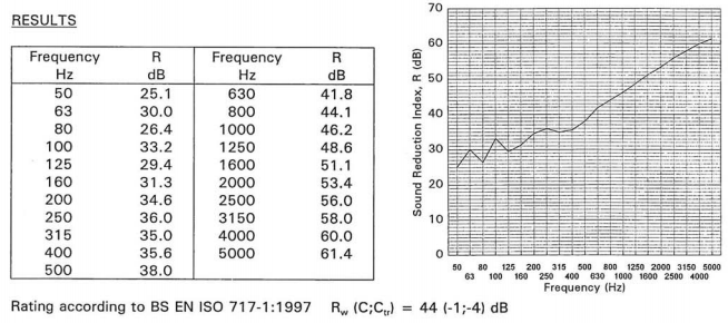

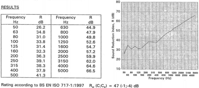

MortarThePoint Posted June 25, 2020 Author Share Posted June 25, 2020 (edited) Fibolites seem to have 3dB less attenuation than Stranlites. I think that means the transmitted sound energy is double in the case of Fibolite. I don't know what a stud wall looks like in terms of sound attenuation though for comparison. Fibolite 100mm (850 kg/m3) : https://www.plasmor.co.uk/uploads/files/Technical_Library/Technical_Data_&_Reports/Acoustic Test Certificates/100mm_Fibolite_-_Plastered.pdf Stranlite 100mm (1400 kg/m3) : https://www.plasmor.co.uk/uploads/files/Technical_Library/Technical_Data_&_Reports/Acoustic Test Certificates/100mm_Stranlite_-_Plastered.pdf Edited June 25, 2020 by MortarThePoint Link to comment Share on other sites More sharing options...

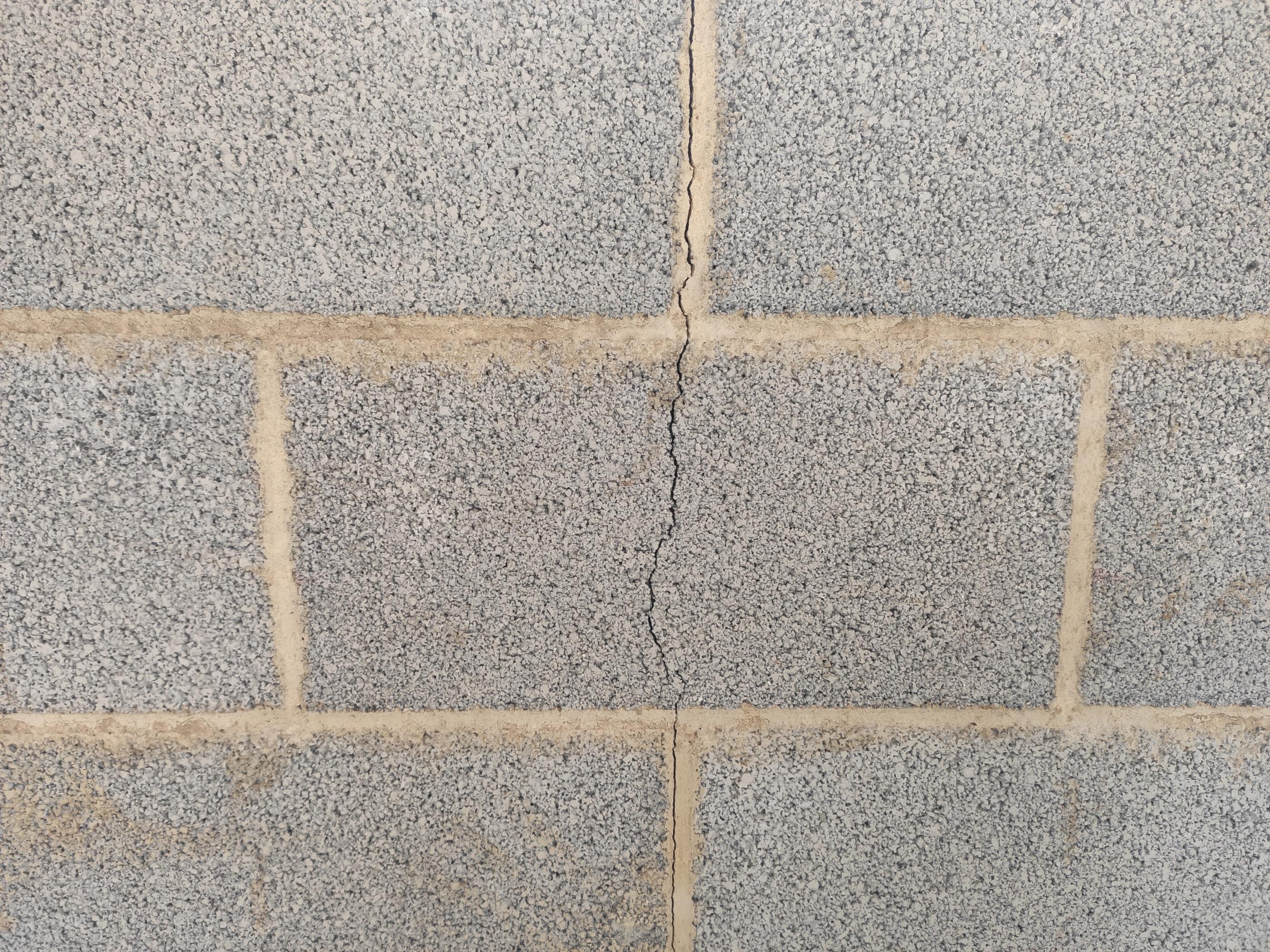

MortarThePoint Posted May 17, 2021 Author Share Posted May 17, 2021 For reference, I have had some cracking of blocks under 1.8m wide windows (near middle of window). Hopefully this is just shrinkage, but I thought I would share it on this thread as it was one of the Fibolite considerations. I suspect if we had used a layer of bed joint reinforcement in the bed just under the window this wouldn't have happened, but ultimately the shrinkage has to be accommodated somewhere and arguably under a window is the best place (?). This photo shows the worst of it (so far, but 6 months after being laid). Link to comment Share on other sites More sharing options...
epsilonGreedy Posted May 17, 2021 Share Posted May 17, 2021 1 hour ago, MortarThePoint said: For reference, I have had some cracking of blocks under 1.8m wide windows (near middle of window). Hopefully this is just shrinkage Is this on the first floor above wooden joists embedded within the blockwork?? Link to comment Share on other sites More sharing options...
MortarThePoint Posted May 17, 2021 Author Share Posted May 17, 2021 (edited) 23 minutes ago, epsilonGreedy said: Is this on the first floor above wooden joists embedded within the blockwork?? It's on the first floor but above concrete (HCF) floor planks that rest on the inner leaf. Edited May 17, 2021 by MortarThePoint Link to comment Share on other sites More sharing options...
