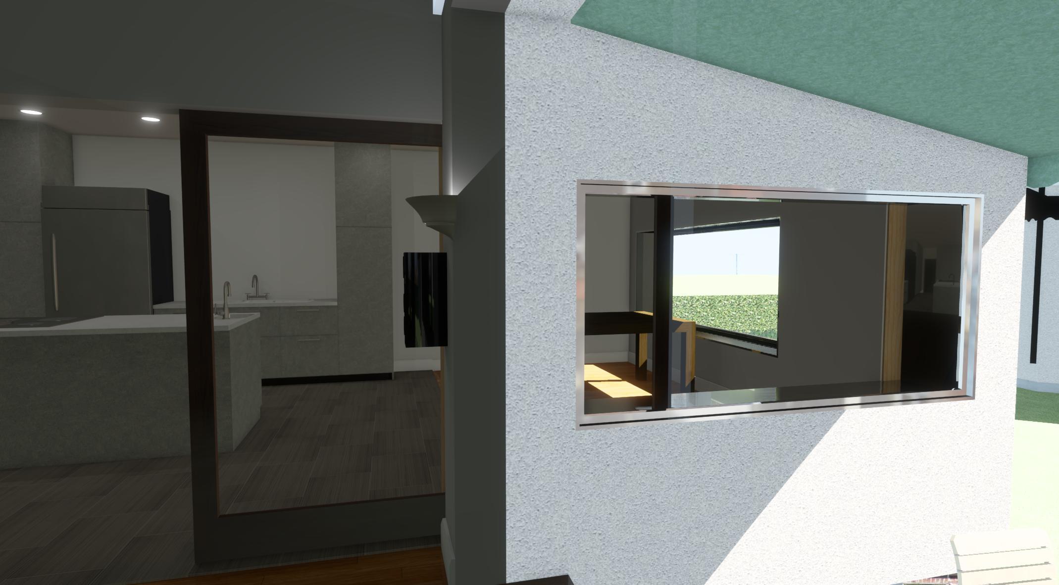

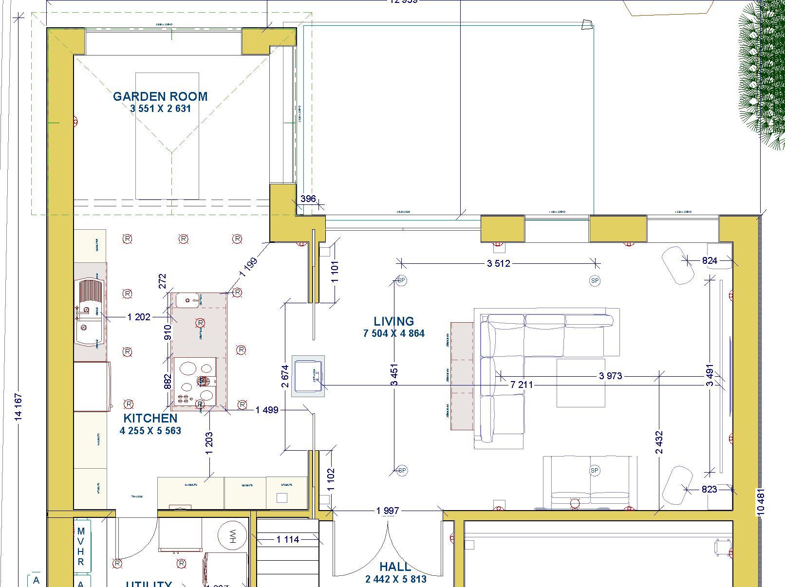

puntloos Posted May 29, 2020 Posted May 29, 2020 Pocket doors are great for certain situations, in particular if they are intended to be "mostly open" - which is the case for my kitchen. Reason for it being there in the first place is to close off any smells and perhaps reduce the view of mess if we are in the livingroom. My question: How deeply can you hide pocket doors into walls? (and should you?) See below: In particular: - In the top, the PD is entering into the external wall.. How deep, if at all, can you do this - At the bottom, the PD is entering into the stair side wall. I realise that would block putting any (other) doors in there, but are there other downsides? Any other suggestions? Other types of doors? (of course we've debated bifolds but they store a lot of stuff in the way of walking paths..
puntloos Posted May 29, 2020 Author Posted May 29, 2020 Of course even if theoretically I can insert it into a external wall it will punch through a window... But indeed more realistically it would mean the wall -window would have to be smaller..

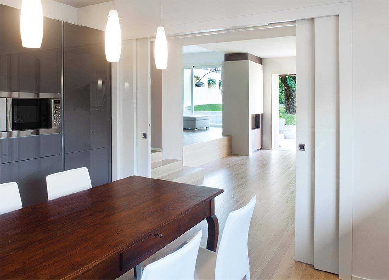

Dan F Posted May 29, 2020 Posted May 29, 2020 Look at the door specs, this will tell you how big the frame is given a door size (assuming you use this approach rather than do something custom). e.g. https://www.eclisse.co.uk/content/tech_specs/Tech Specs 2018/ECL_Syntesis Flush Single_UK_18.pdf
Pocster Posted May 29, 2020 Posted May 29, 2020 3 hours ago, Dan Feist said: Look at the door specs, this will tell you how big the frame is given a door size (assuming you use this approach rather than do something custom). e.g. https://www.eclisse.co.uk/content/tech_specs/Tech Specs 2018/ECL_Syntesis Flush Single_UK_18.pdf I installed an Eclisse . It was a mare with 10 different instructions! . But the quality overall was really good . Our glass pocket door weighed 45kg so was a bit of a dog on my own .
puntloos Posted May 30, 2020 Author Posted May 30, 2020 So far I've used my arch program's "default pocket door' mode, which simply moves a door into and out of the wall. And my current design roughly fits a 2m50 gap without doing strange things to external walls. But - it seems like there's such a thing as telescopic pocket doors! You learn something every day. Given that I have about 4.8m worth of wall, am I reading this spec sheet correctly, that I can indeed fit 3.1m worth of passage? Not bad... I do like @Jilly's door suggestion (open for more suggestions) but indeed the problem with a single pivot to me seems that to achieve even a 3m gap I'd need 1.5m worth of distance. Not insane but it feels a bit limiting where you can not really move behind the door.. 1
