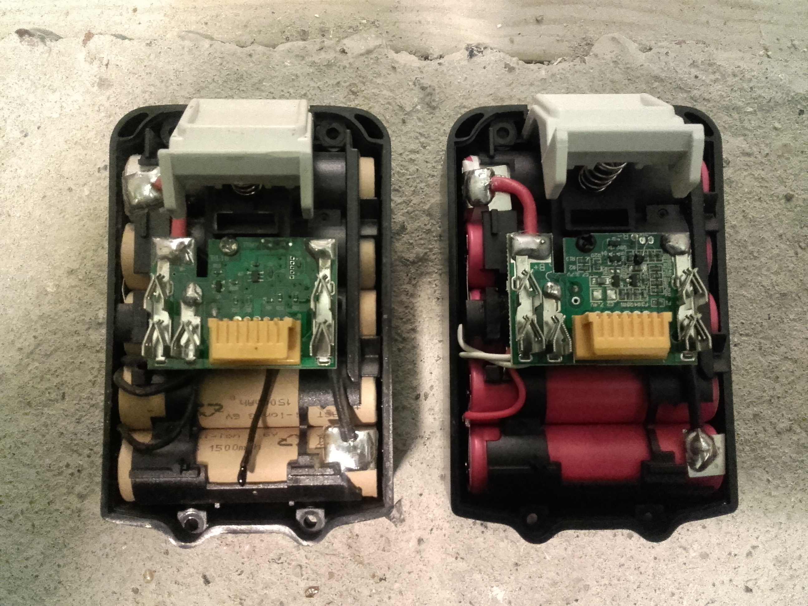

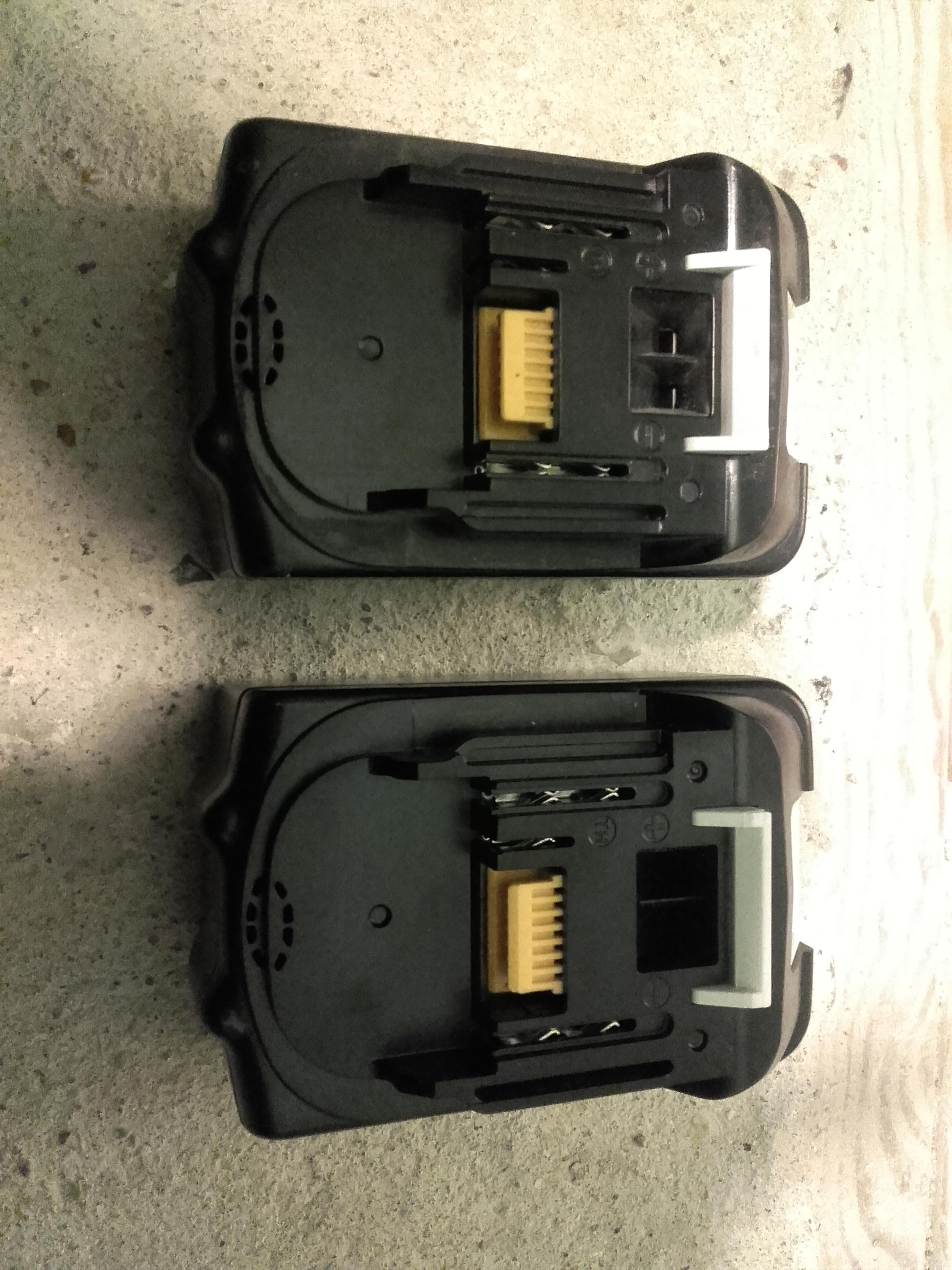

Onoff Posted December 9, 2016 Share Posted December 9, 2016 (edited) This just out if interest: Bought a BL1830 clone a while back at random on eBay. Can't fault it the. Charges, doesn't get hot and lasts. Decided to get another for a freebie BHP452 I've just been given (needed a £2 forward / reverse lever). As you do I thought I'd compare the guts side by side. Externally the case looks identical. Looks a bit different inside though. The old clone's on the left and the new one on the right: EDIT: Should have added that the latest clone on the right ( with the red cells) is from here: http://m.ebay.co.uk/sch/m.html?isRefine=true&_odkw=makita+18v&_ssn=lycfeng&_sop=15&hash=item25ad3101dd&item=161819460061&_osacat=0&_from=R40&_trksid=p2046732.m570.l1313.TR12.TRC2.A0.H0.Xmakita+18v+battery.TRS0&_nkw=makita+18v+battery&_sacat=0&_trksid=p2046732.m570.l1313.TR12.TRC2.A0.H0.Xmakita 18v battery.TRS0&_mwBanner=1 Bought on recommendation from a member here who rated them. Not used in anger yet so time will tell! It does look well made though with an attention to detail etc. I must compare to the inside of a genuine Makita BL1830. I've no doubt voided any warranty but for £22.99 I'm not overly bothered. I'll openly admit though that with these clones I NEVER leave them charging unattended. Edited December 10, 2016 by Onoff 2 Link to comment Share on other sites More sharing options...
