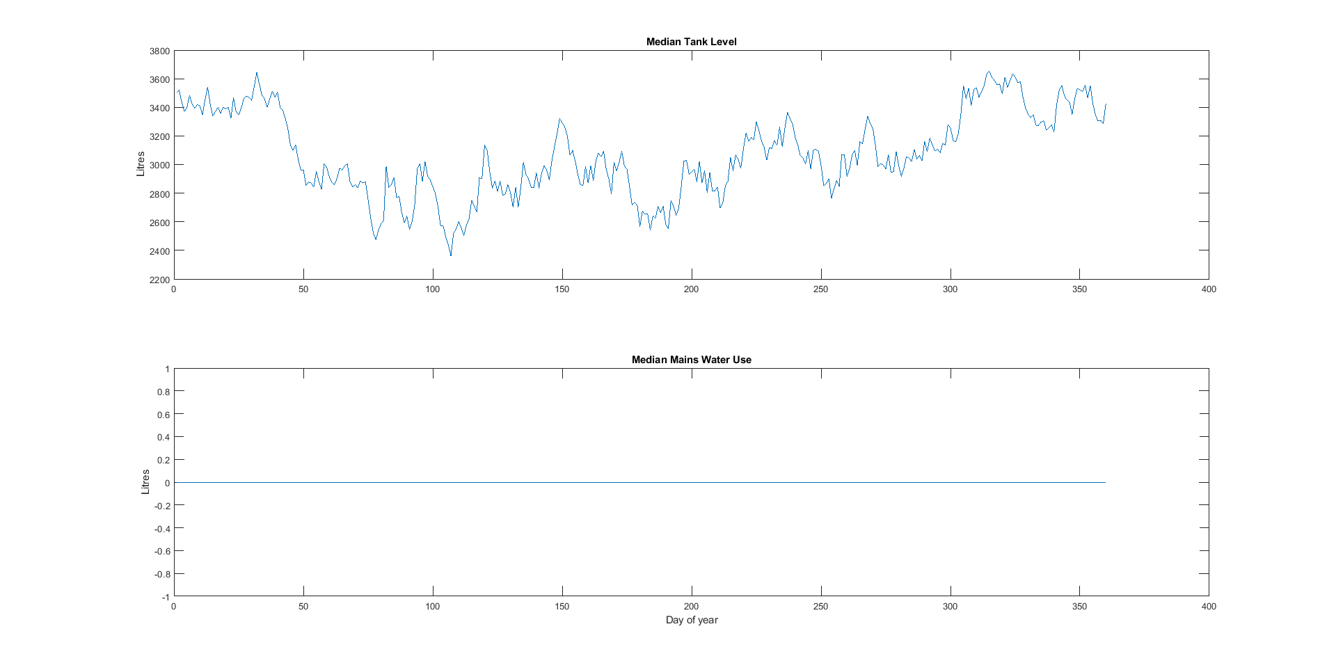

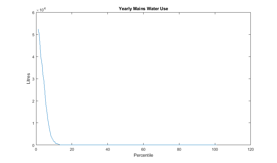

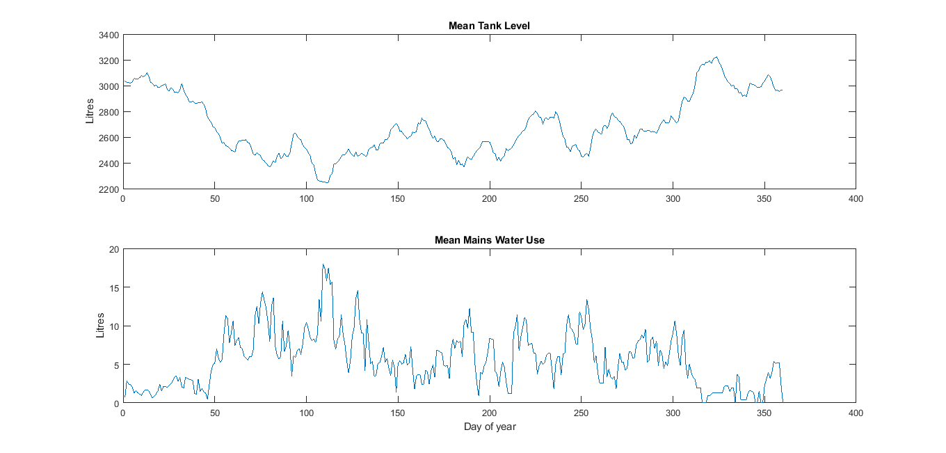

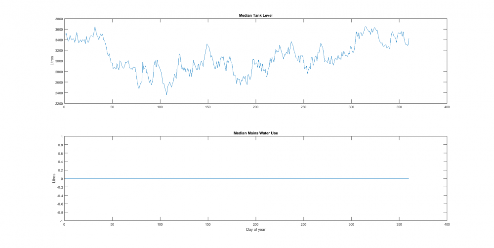

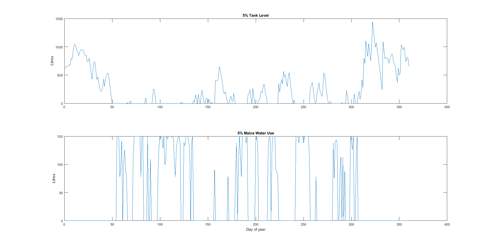

dnb Posted May 26, 2020 Author Share Posted May 26, 2020 I promised some mathematical modelling. Not the clothes kind. I'm much better at the former. Here are some charts and things. It turns out that modelling rainfall is almost as difficult as modelling sea clutter as seen by radar. I ended up with a uniform distribution for deciding if it would rain on a particular day, and then a gamma distribution to determine how much rain there would be. It sort of worked but plan B - getting real world daily rain data for my area for the past 89 years - seemed a considerably better option when it appeared! I wrote a quick and dirty Matlab script to read in the rainfall data, then in a loop (couldn't be bothered to vectorise) of 1000 runs select a year at random and run through each day to work out how much rain my roof and a 4000 litre tank could capture less a fraction for efficiency of capture, followed by "using" 150 litres of water that day (no idea if that's the right amount, but it seems sane for the moment). Anything that drained the tank counted as mains usage. This gave me the following charts, averaged over the 1000 runs: The rainwater tank ranges from zero to full for most days at some point over the 1000 runs, but there are more zeros in the spring than in winter - hence the higher average mains usage. Means are pretty useless statistics though when outliers are involved (i.e. full and empty tanks) so let's look at the median. This clearly says the expectation is that mains water will not be used (on average) and that 4000 litres is sufficient storage for using 150 litres per day (again on average). So let's look at the 95% "worst case" level, since average is wrong half the time... In this case, the system only provides 30% of the water we need. But 95% of the time, it will do a lot better. Let's now look at how much better by plotting the mains use percentile for each year. It shows that the system usually provides sufficient water to sustain near zero mains use provided the assumptions on water use of 150 litres per day are sound. All ready for you lot to throw rocks at the charts now ? Link to comment Share on other sites More sharing options...
