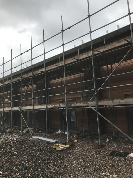

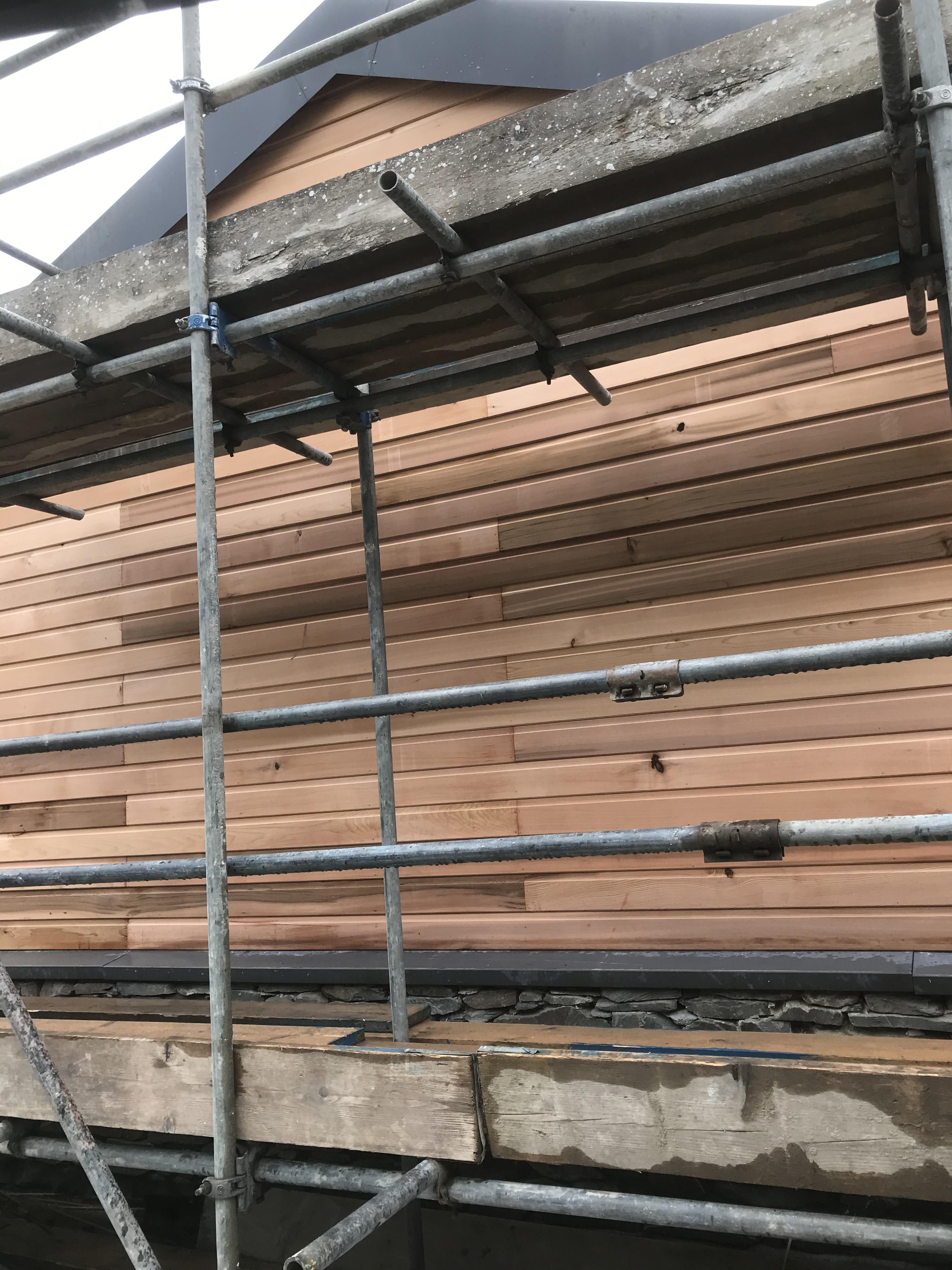

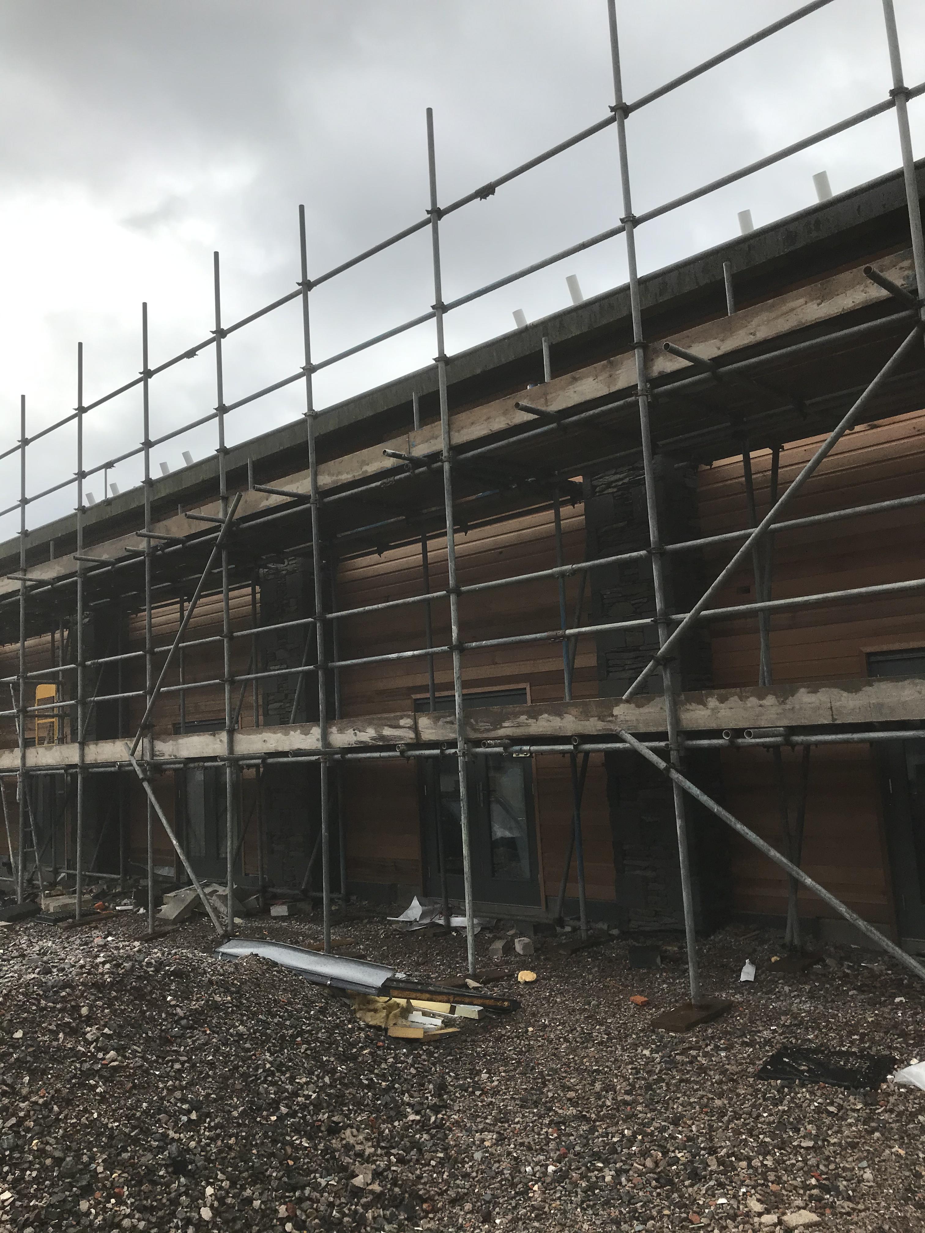

All the Batons that are used are pressure treated Just the same as the ones on your roof
The membrane and cladding or render Baird will keep them dry as a bone
The building pictured Had been built and stood empty since 2008 crash The  guys that cladded originally had battened  out and boarded directly without a membrane So all had to be stripped off
Even the batons  that where in perfect condition
