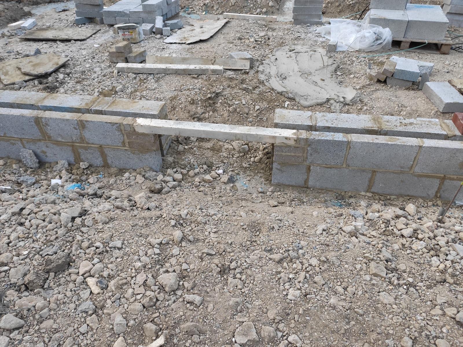

MortarThePoint Posted May 19, 2020 Posted May 19, 2020 I've a run of subfloor blockwork that is specified as 190mm 10.4N blocks. The drainage pipes pass through this wall and I wanted to make sure the lintels are strong enough and have the correct bearing. They've only fitted the one in the outer leaf in the photo below but are looking to use 2 of the same type of lintel bearing directly on to the Stranlite 10.4N blocks for the inner leaf. I should have measured the span but I would guess it is 1000mm. Looking at the Structual Engineering calculations there looks to be about 6000 kg per metre length of that inner leaf so that seems like a lot of load to put on those lintels and the 150mm bearing at each end. On paper the pressure would be 60kN/(2 * 150mm * 200mm) = 1N/mm2 which is obviously much less than the blocks 10.4N/mm2 spec but perhaps that's missing something.
PeterW Posted May 19, 2020 Posted May 19, 2020 Either is fine but personally would have used a 215 concrete naylor on flat like the blocks and just carried through 1
MortarThePoint Posted May 19, 2020 Author Posted May 19, 2020 52 minutes ago, PeterW said: Either is fine but personally would have used a 215 concrete naylor on flat like the blocks and just carried through But you'd be happy with it just bearing on the blockwork or coursing blocks?

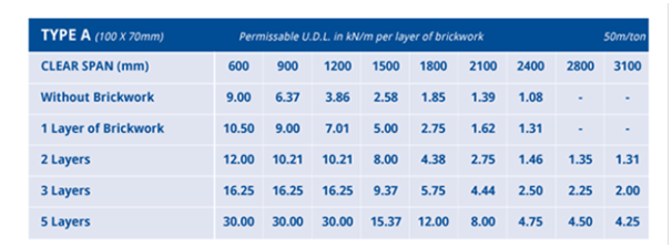

Carrerahill Posted May 19, 2020 Posted May 19, 2020 1 hour ago, MortarThePoint said: I've a run of subfloor blockwork that is specified as 190mm 10.4N blocks. The drainage pipes pass through this wall and I wanted to make sure the lintels are strong enough and have the correct bearing. They've only fitted the one in the outer leaf in the photo below but are looking to use 2 of the same type of lintel bearing directly on to the Stranlite 10.4N blocks for the inner leaf. I should have measured the span but I would guess it is 1000mm. Looking at the Structual Engineering calculations there looks to be about 6000 kg per metre length of that inner leaf so that seems like a lot of load to put on those lintels and the 150mm bearing at each end. On paper the pressure would be 60kN/(2 * 150mm * 200mm) = 1N/mm2 which is obviously much less than the blocks 10.4N/mm2 spec but perhaps that's missing something. What is that? Type A? 100x70? What is the clear span? about 800mm? Permissible load assuming at least 5 layers of brick would be around 3000Kg per meter...
Carrerahill Posted May 19, 2020 Posted May 19, 2020 1 hour ago, PeterW said: Either is fine but personally would have used a 215 concrete naylor on flat like the blocks and just carried through I second this - that would have given @MortarThePoint more like the 6000Kg per meter he needs.
MortarThePoint Posted May 19, 2020 Author Posted May 19, 2020 (edited) Clear span is about 1000mm. On the 215 blockwork they are planning to use two lintels (side by side). I don't know what Type but they look to be 100x70 with a single metal bar about 6mm in diameter near the bottom edge. Edited May 19, 2020 by MortarThePoint

Carrerahill Posted May 19, 2020 Posted May 19, 2020 (edited) 58 minutes ago, MortarThePoint said: Clear span is about 1000mm. On the 215 blockwork they are planning to use two lintels (side by side). I don't know what Type but they look to be 100x70 with a single metal bar about 6mm in diameter near the bottom edge. That is even worse... The best a type A can achieve on a 600mm span with 5 courses is about 3000Kg... Who spec'ed the lintels? For the sake of £50 I think I'd pop those out, remove the coursing brick, (maybe use pieces of the old lintel as pad stones) and get a G8 in there, which on it's own without any other courses is just shy of 600Kg/m. If you have a few courses then this could drop to a type F or K9. All advice above is without having full facts and details, but at a basic level is accurate. Edited May 19, 2020 by Carrerahill
MortarThePoint Posted May 19, 2020 Author Posted May 19, 2020 (edited) 1 hour ago, bassanclan said: Are you having a block and beam floor? If so how many courses above the lintel to the beam and will a beam be resting on the middle of a lintel? It's not block and beam but a slab based flooring. It would be bearing directly on the lintel of the inner leaf and chances are only one of the two. Edited May 19, 2020 by MortarThePoint

MortarThePoint Posted June 28, 2020 Author Posted June 28, 2020 Thanks @Gus Potter, very informative. There is a door immediately above the floor slab that bears on the lintel. The load from that is 17kN/m but there's no scope for composite action. They did swap it to a P215 lintel. There is a helper pillar breaking the span into 2 spans, a 650mm span and a 300mm span. There's concrete packing underneath the lintel but of unknown quality and therefore unknown strength.
MortarThePoint Posted June 28, 2020 Author Posted June 28, 2020 I just looked and a P215 appears to have an unfactored UDL of 27kN/m, but would that be in the A frame scenario?
Gus Potter Posted June 28, 2020 Posted June 28, 2020 I think the Naylor P215 lintel is still only 65mm deep. I would run it by your Engineer just to be sure. It should just be a quick phone call. All the best.
MortarThePoint Posted June 28, 2020 Author Posted June 28, 2020 Just now, Gus Potter said: I think the Naylor P215 lintel is still only 65mm deep. I would run it by your Engineer just to be sure. It should just be a quick phone call. All the best. Yes it is only 65 deep. Thank you for the insight.
MortarThePoint Posted June 28, 2020 Author Posted June 28, 2020 5 minutes ago, Gus Potter said: I think the Naylor P215 lintel is still only 65mm deep. I would run it by your Engineer just to be sure. It should just be a quick phone call. All the best. Out of interest, do you know if the Naylor P215 is a composite lintel or not?
