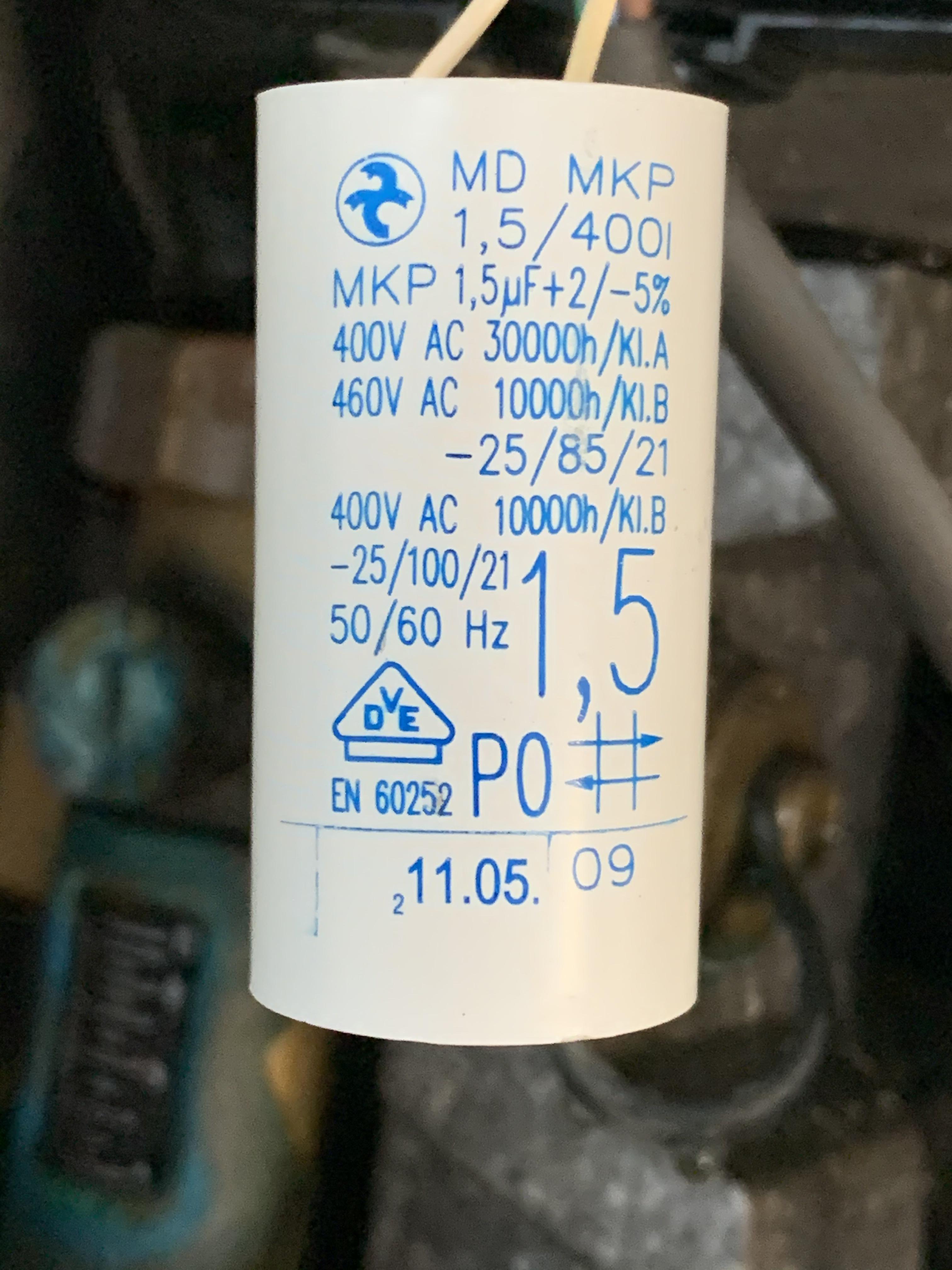

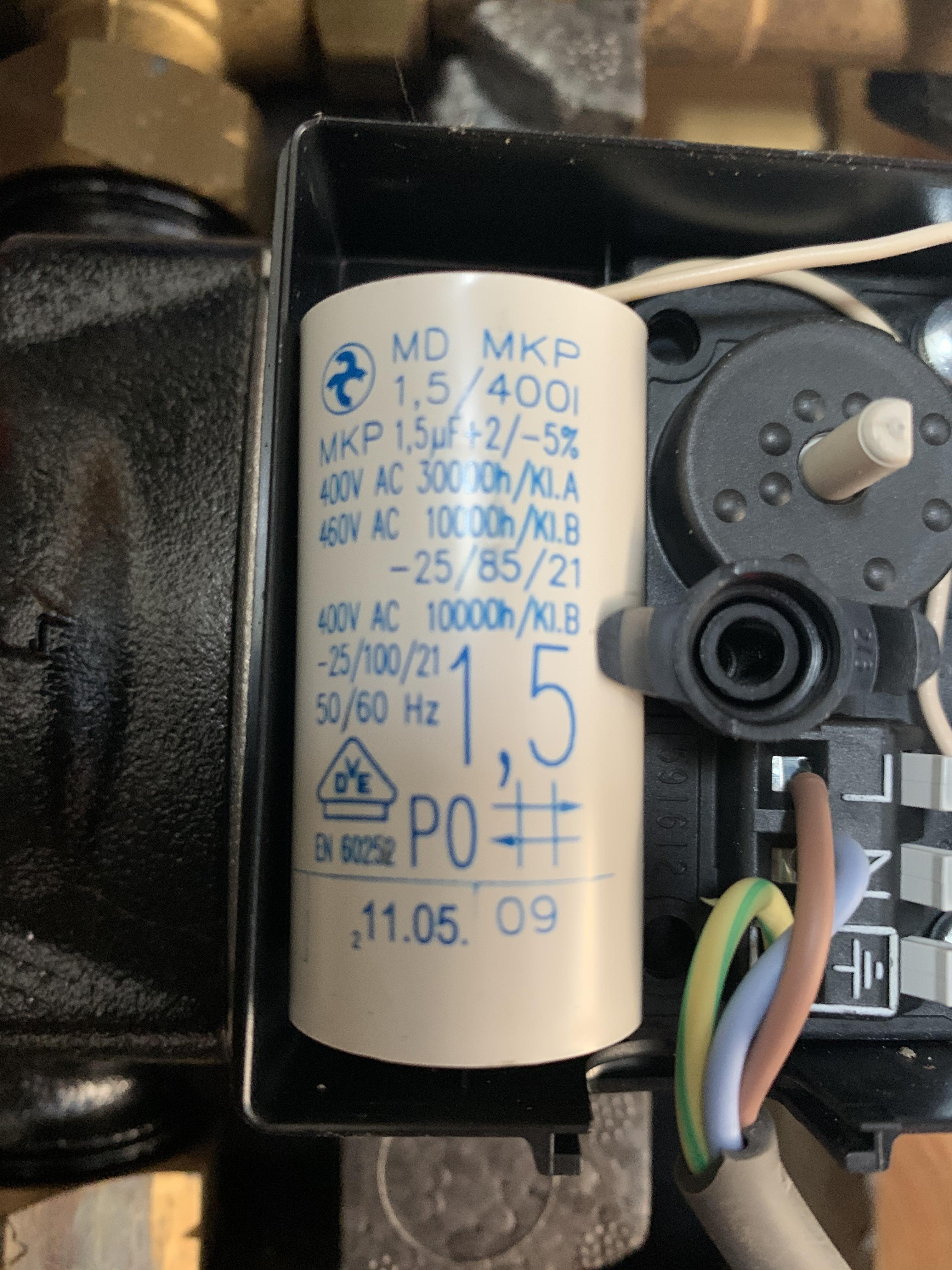

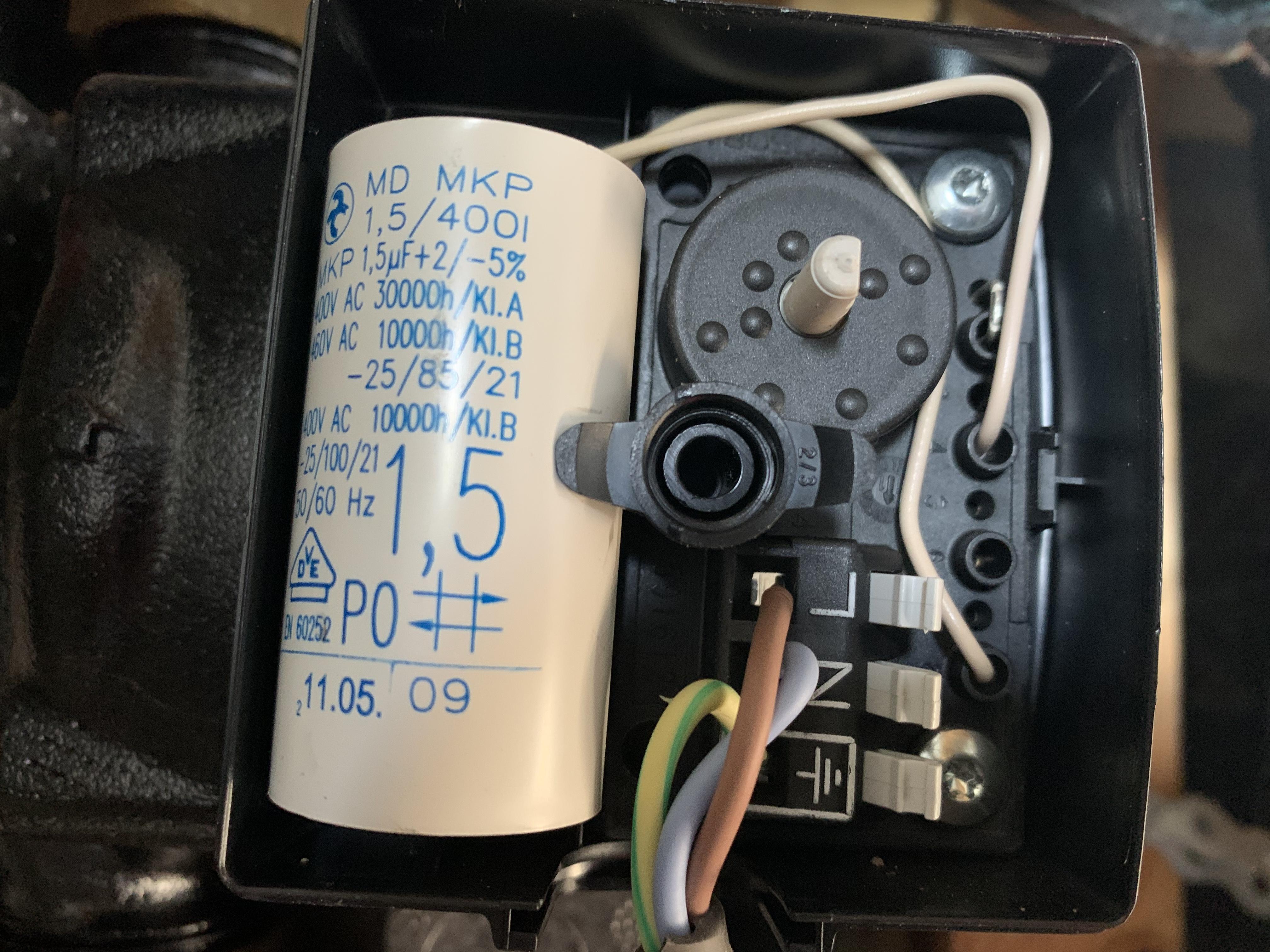

There is a start capacitor, probably inside the terminal box, a big cylinder with 2 wires emerging. That has probably failed.
Turn the power off and lift the lid off the terminal box and post a picture.
Is this the same thing?

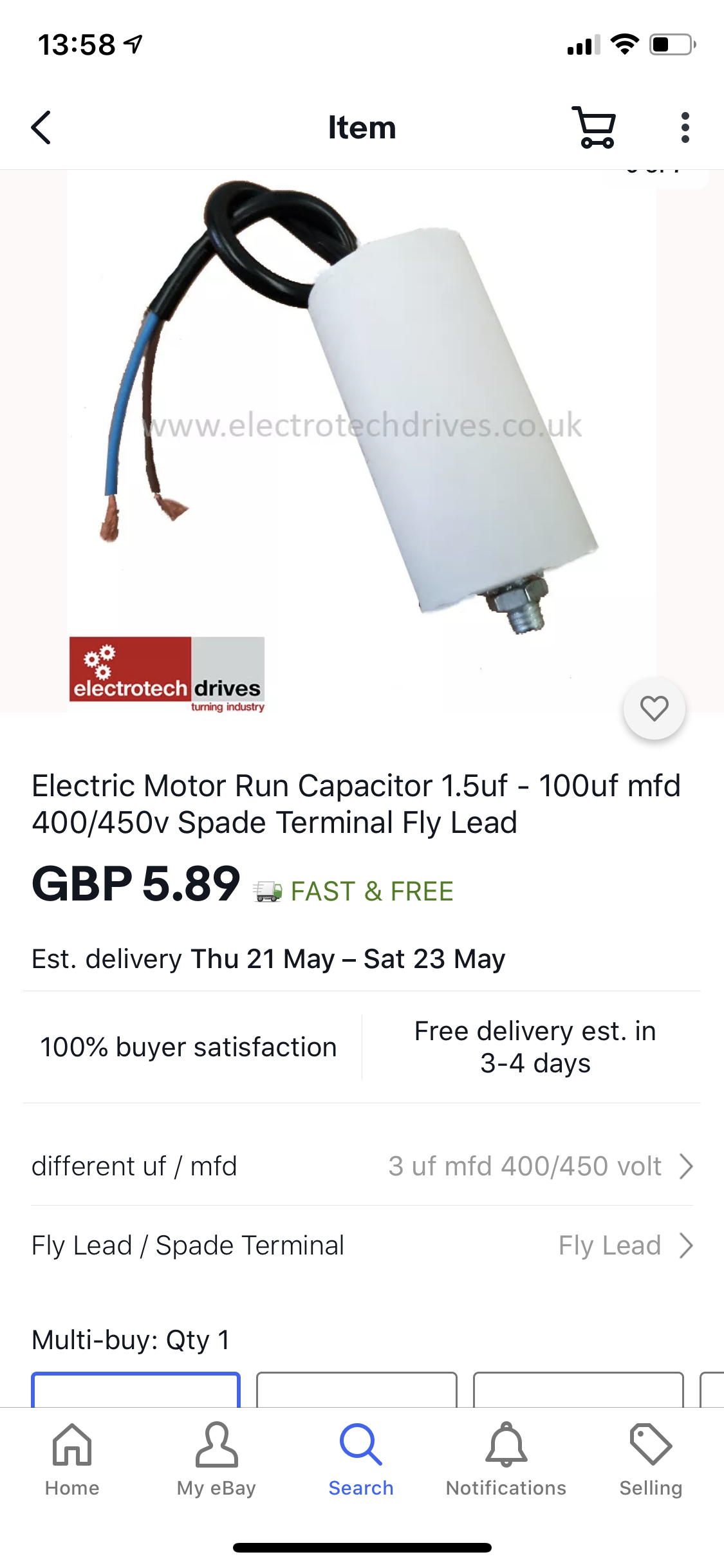

Found a better one (I think) on EBay
https://www.ebay.co.uk/itm/273634770355
That will do, but before you order it, check the dimensions against the one that is in there, to make sure it will fit into the space you have
P.S there is no absolute guarantee this is the fault, but if you are sure the impeller is free to rotate and the fact the armature seems intact is is quite likely.
Dimensions are close thanks
Any idea how to release the existing wires ?
with the power isolated push a pin/ straightened paperclip/whatever into the small hole beside the one the wire goes into.

The capacitor has just arrived and the pump works !
Might have saved me £300!
