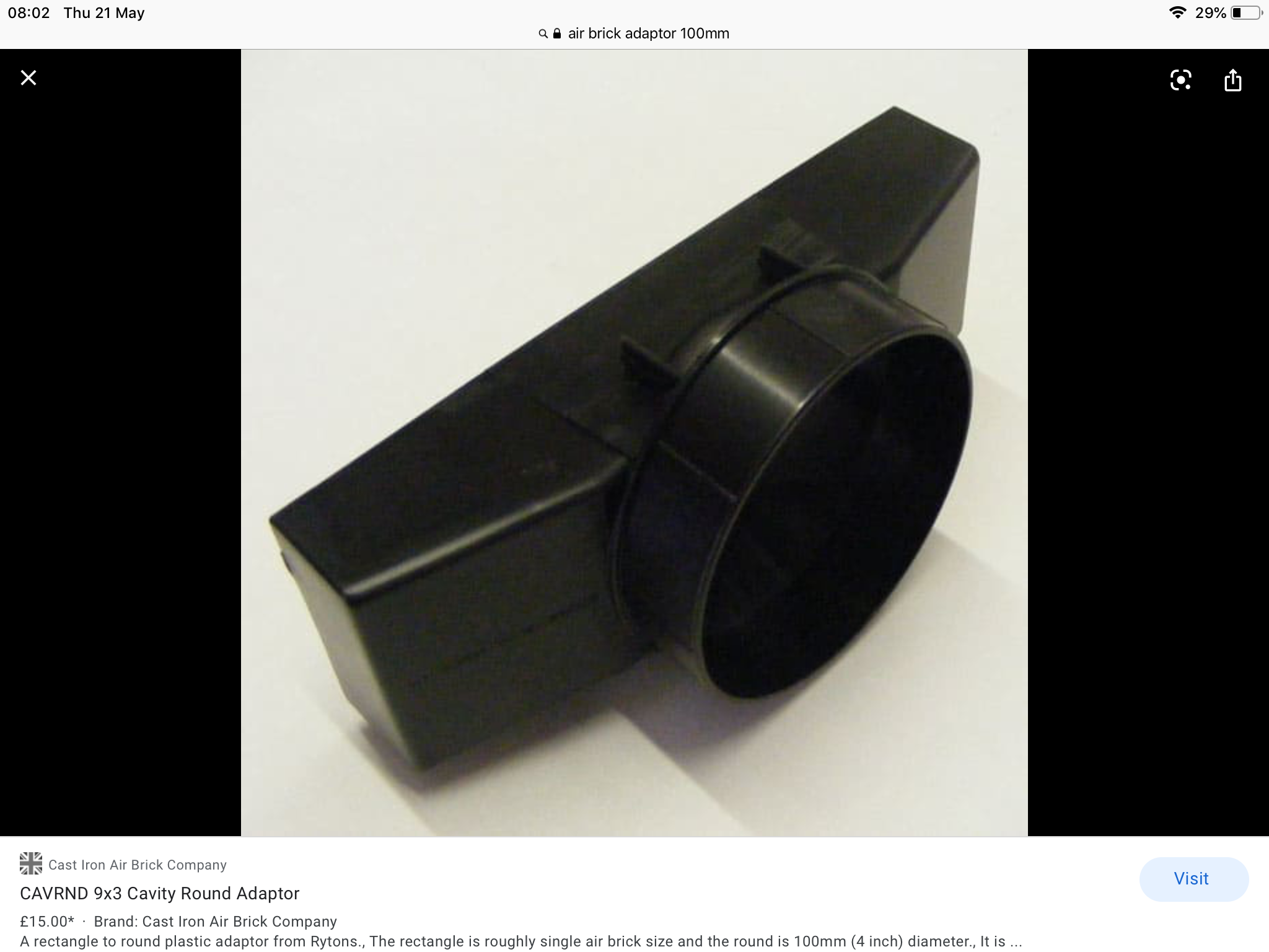

Russell griffiths Posted May 21, 2020 Posted May 21, 2020 (edited) 3 minutes ago, MortarThePoint said: Nice ideas. I think I'm trying to get them on bond and putting them in a 350 or 400mm slot to allow adjustment. Connect to a flexi pipe gives you the movement, I have used 3-4 as the periscope was just not doing what I wanted. Edited May 21, 2020 by Russell griffiths 1
MortarThePoint Posted May 21, 2020 Author Posted May 21, 2020 2 minutes ago, Russell griffiths said: Connect to a flexi pipe gives you the movement, I have used 3-4 as the periscope was just not doing what I wanted. Will be good to use if I mess up by bond calculations ? What ducting did you use with that?

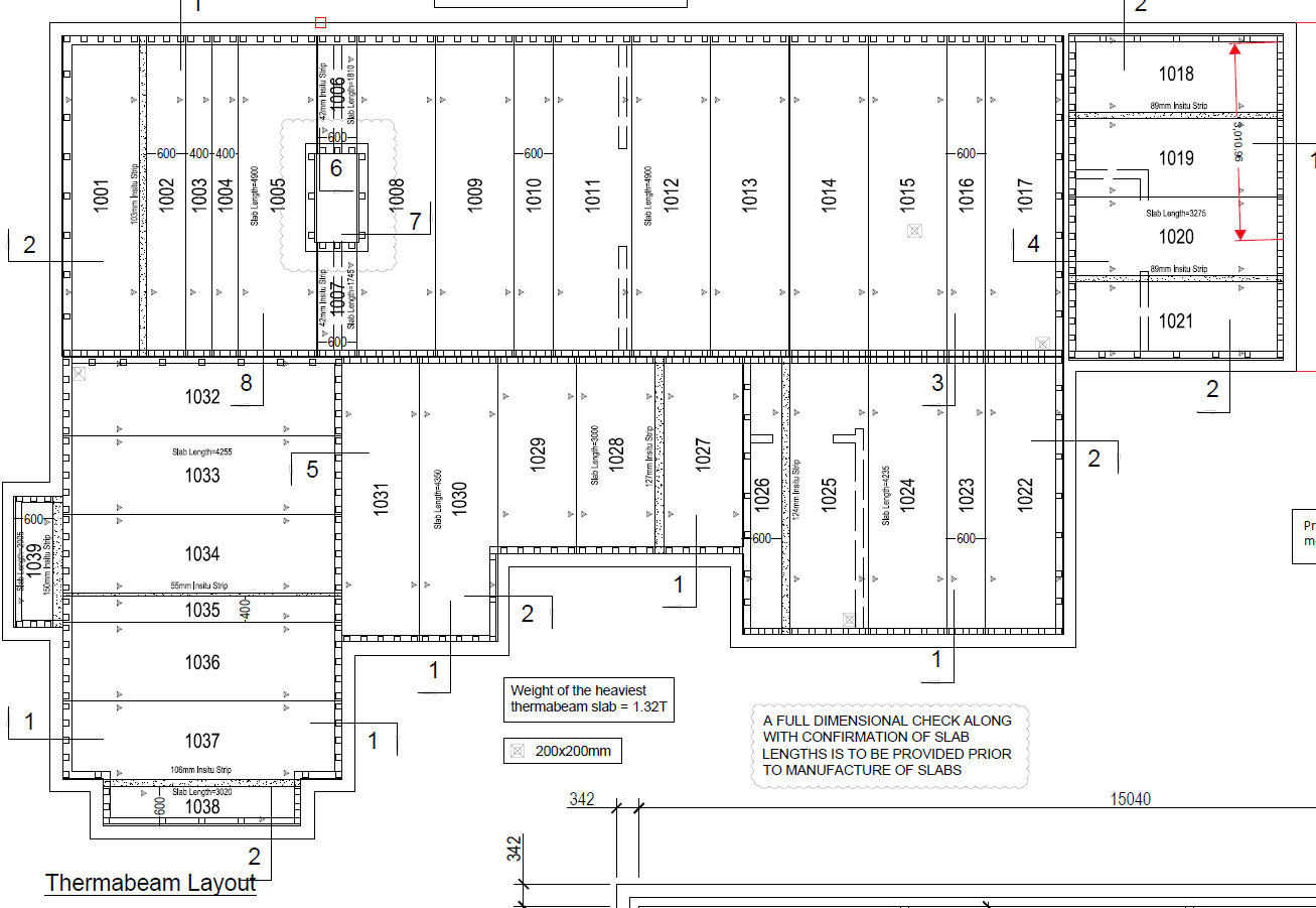

PeterW Posted May 21, 2020 Posted May 21, 2020 OK so what is the SEng/Floor designers detail for this..? It looks like you're trying to design where there should be standard detail or engineers details Why can't you put the vents in the sides where there is no point load from the floor slabs as I assume they are all the same orientation..?
MortarThePoint Posted May 21, 2020 Author Posted May 21, 2020 2 minutes ago, PeterW said: OK so what is the SEng/Floor designers detail for this..? It looks like you're trying to design where there should be standard detail or engineers details Why can't you put the vents in the sides where there is no point load from the floor slabs as I assume they are all the same orientation..? I have asked them for a detail for this a number of times over the last few months and only had words back "Support is required at bearing level above the opening for the vent." I take that to mean there must be a lintel. The sides have pillars to and whilst in theory you could plan them not to clash (as 600 c/c) that could easily go wrong and present a bigger problem that is only discovered late in the game when the slabs are being fitted (all in a day)
PeterW Posted May 21, 2020 Posted May 21, 2020 Sorry back to my point, why are you asking this not the structural engineer..?? Can you post your ground floor plans and indicate the direction of the floor slabs..?
MortarThePoint Posted May 21, 2020 Author Posted May 21, 2020 (edited) 13 minutes ago, PeterW said: Sorry back to my point, why are you asking this not the structural engineer..?? Can you post your ground floor plans and indicate the direction of the floor slabs..? Surely shouldn't need to bother the Structural Engineer for this as the lintels are only 600mm long? Edited May 21, 2020 by MortarThePoint
PeterW Posted May 21, 2020 Posted May 21, 2020 OK they aren't contact points - they are strengthening in the EPS. The BBA Cert states you should use opposing walls for ventilation 8.2 To help minimise the risk of condensation, the void space beneath the lowest point of the floor construction should be at least 150 mm high, with provision for adequate through-ventilation in the form of ventilation openings provided in two opposing external walls. The ventilation openings should be sized at not less than 1500 mm2·m ̄1 run of external wall or 500 mm2·m ̄2 of floor area, whichever is greater. Where pipes are used to carry ventilating air, these should be at least 100 mm diameter.
