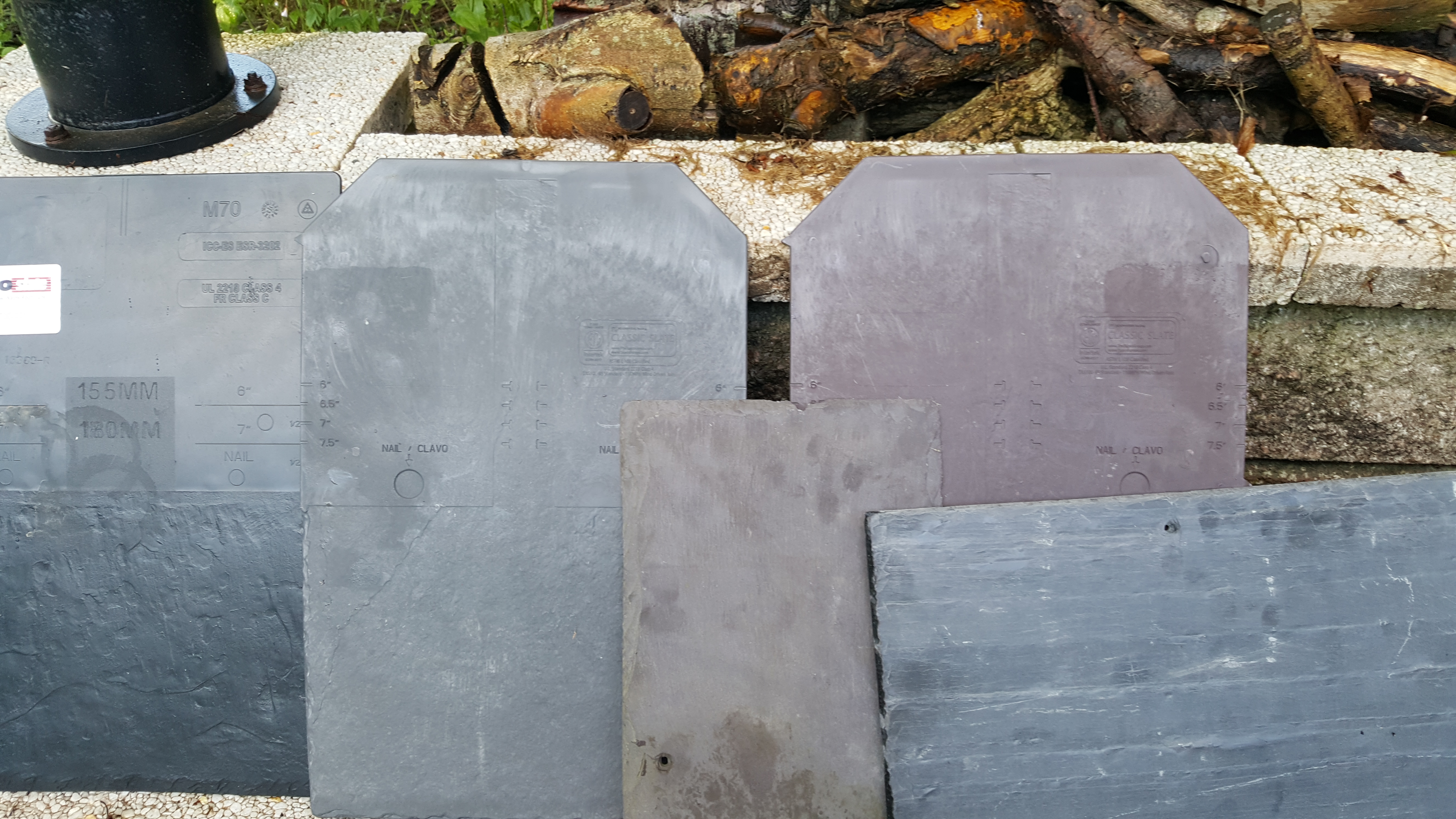

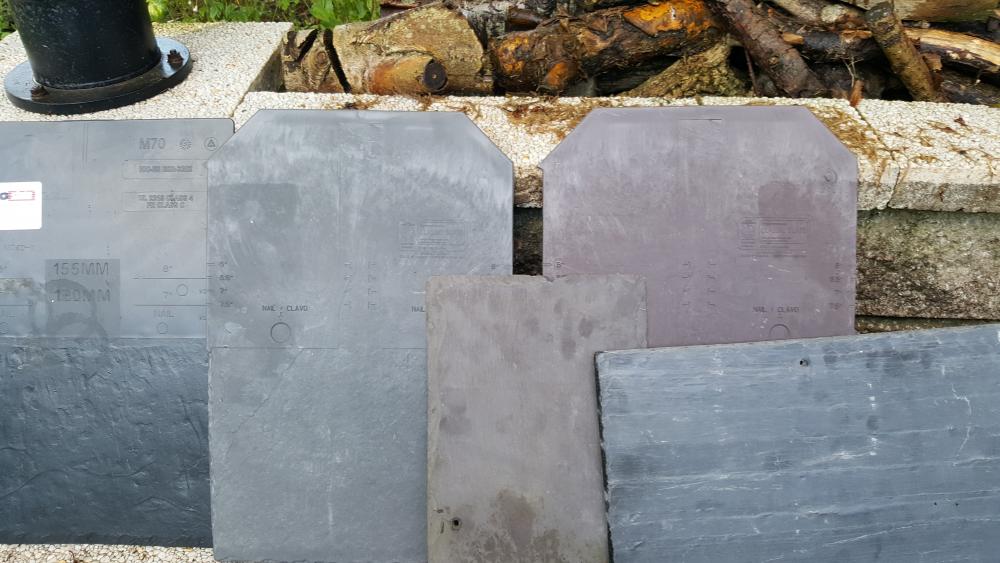

Just a update with the tapco samples. I am very impressed with them. I was sent a plum (close to Welsh) and a pewter (steel grey).  I have attached a photo with them alongside a Welsh slate, Spanish slate & ikoslate.
  • Like 1

I used the darker grey Tapco slates when I ran out of spare IkoSlates, and they are a very close match to the colour.  The main difference is that every Tapco slate is identical, whereas the Ikoslates have a different "riven" pattern on each slate (well, they have a few different "riven" patterns, but it looks like every slate is unique).
Whether this matters or not I'm not sure.  It's noticeable when you lay out a pack of IkoSlates that they look slightly different from each other, but against that the IkoSlates have a slight sheen to the surface, whereas the Tapcos are very matt looking.
One thing I have noticed is that the Tapcos attract more green algae.  The IkoSlates are self-cleaning in heavy rain, but the Tapcos do start to look a bit green and patchy.  That may be because I have the Tapcos and IkoSlates on the same small shed roof, that is very shaded, on the North side of the house, though.
