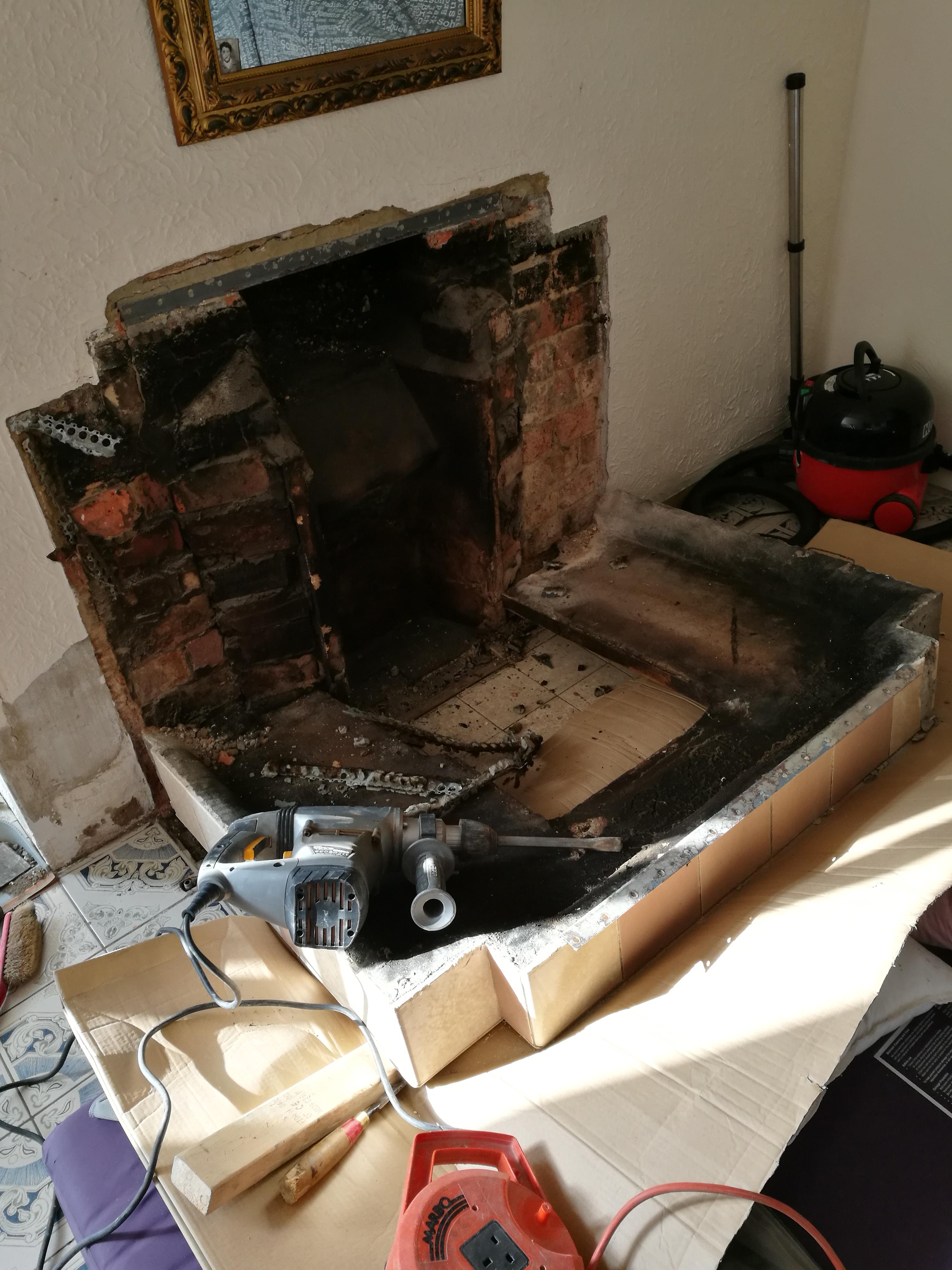

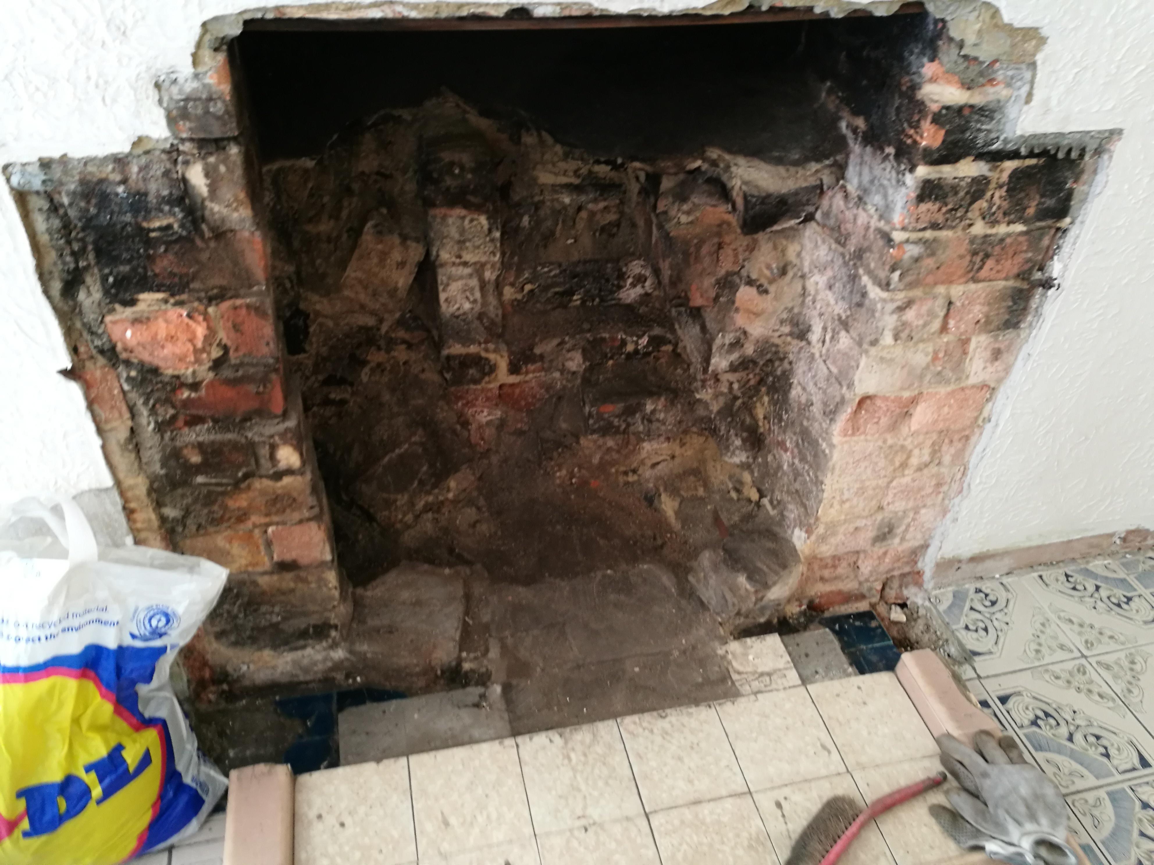

Joe68 Posted May 11, 2020 Share Posted May 11, 2020 (edited) Hi all, I've removed a 1930s tiled fireplace surround and fireback i just want to block it. I've removed it all and had to remove the fire back and some side bricks, it had a 10mm metal thickness beam across the chimney how safe is this will it support chimney breast. Any advice much appreciated photos below Edited May 11, 2020 by Joe68 Spelling Link to comment Share on other sites More sharing options...

ProDave Posted May 11, 2020 Share Posted May 11, 2020 That flat bit of steel has been holding the bricks up for the last 90 years, so leave it there to continue doing so. Link to comment Share on other sites More sharing options...
tonyshouse Posted May 11, 2020 Share Posted May 11, 2020 Just brick it up cut back plaster 50 or 100mm replaster , traditional wisdom says to leave a hole 200x65 and fit an air vent, I no longer recommend this but open up a similar hole in the loft , if on outside wall fill the flue with pourable insulation eps, micafill etc insulate 600mm up chimney in the loft Link to comment Share on other sites More sharing options...
Joe68 Posted May 11, 2020 Author Share Posted May 11, 2020 OK thanks for replies i will brick it up and put a vent up there. Link to comment Share on other sites More sharing options...
