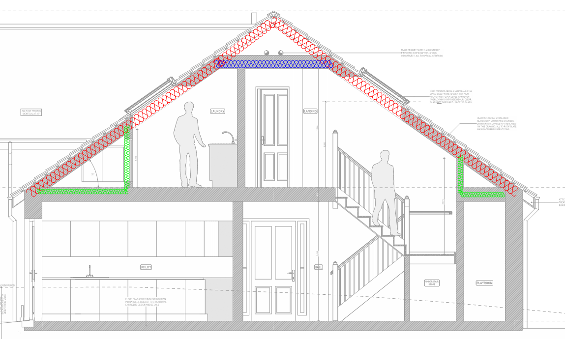

Nethermoor Posted May 8, 2020 Author Posted May 8, 2020 1 hour ago, ProDave said: The No 1 thing I would suggest is ditch the plan to use attic trusses. They are a devil of a problem to insulate properly without leaks, and in any event you have cupboards going into the eaves. @ProDave Oh dear...just paid my deposit on these to be able to get the full truss design for the structural engineer ? The plan was to keep the eaves and apex void within the insulated area as red line below. What bits are hard to insulate properly compared to a cut roof?...may as well get prepared!

Jeremy Harris Posted May 8, 2020 Posted May 8, 2020 6 minutes ago, Nethermoor said: @ProDave Oh dear...just paid my deposit on these to be able to get the full truss design for the structural engineer ? The plan was to keep the eaves and apex void within the insulated area as red line below. What bits are hard to insulate properly compared to a cut roof?...may as well get prepared! That's a shame, as we have a roof similar to the one @ProDave has described, with a ridge beam and rafters hung from it. Our's has 22mm OSB sarking outside, and just a VCL inside to hold the insulation in place, and the design gives the same sort of space as yours, but is very much easier to both insulate well and make airtight:
ProDave Posted May 8, 2020 Posted May 8, 2020 I have yet to find anyone that has done a trussed roof and insulated it well. You will be cutting a lot of insulation, and it is vital that at every junction of every truss you get the detail absolutely perfect. The danger, and what happens so so often, is you get gaps in the insulation, allowing cold roof air to get between the insulation and the plasterboard. Then you get the situation I encounter very often that on a windy day, you take an upstairs socket off the wall and a blast of cold air comes out of the socket box. that is letting cold air in in the winter, and warm air in the summer. I would say if you are doing it yourself and are prepared to spend the time to get the detail right then carry on. If you are employing a builder then I almost guarantee the detail will not be right.
Nethermoor Posted May 8, 2020 Author Posted May 8, 2020 Hmmm. I will be insulating the roof myself. Design is here https://sketchfab.com/3d-models/5608i-088a0c8b982c485d893e8bf55933449f Which bits do I need to watch out for? Had assumed it would be quite simple fitting Frametherm between the rafters...?
Jeremy Harris Posted May 8, 2020 Posted May 8, 2020 6 minutes ago, Nethermoor said: Hmmm. I will be insulating the roof myself. Design is here https://sketchfab.com/3d-models/5608i-088a0c8b982c485d893e8bf55933449f Which bits do I need to watch out for? Had assumed it would be quite simple fitting Frametherm between the rafters...? The tricky bit is sealing it up and getting it airtight. With a ridge beam hung rafter arrangement you have a completely free internal face that makes fitting and sealing the VCL very easy. With attic trusses the VCL has to be cut and taped very carefully around dozens of timber projections through the membrane, creating a lot of work to get right, and using up a lot of airtightness tape. Our roof just has a layer of VCL stretched from one end of the house to the other inside, fastened to the inner face of the rafters with 50 x 50 battens, with the only taping being the joins between the runs of VCL and to the membrane coming up from the walls. The plasterboard vaulted ceilings are just fastened to the 50 x 50 battens, with the void behind being used for wiring etc.
