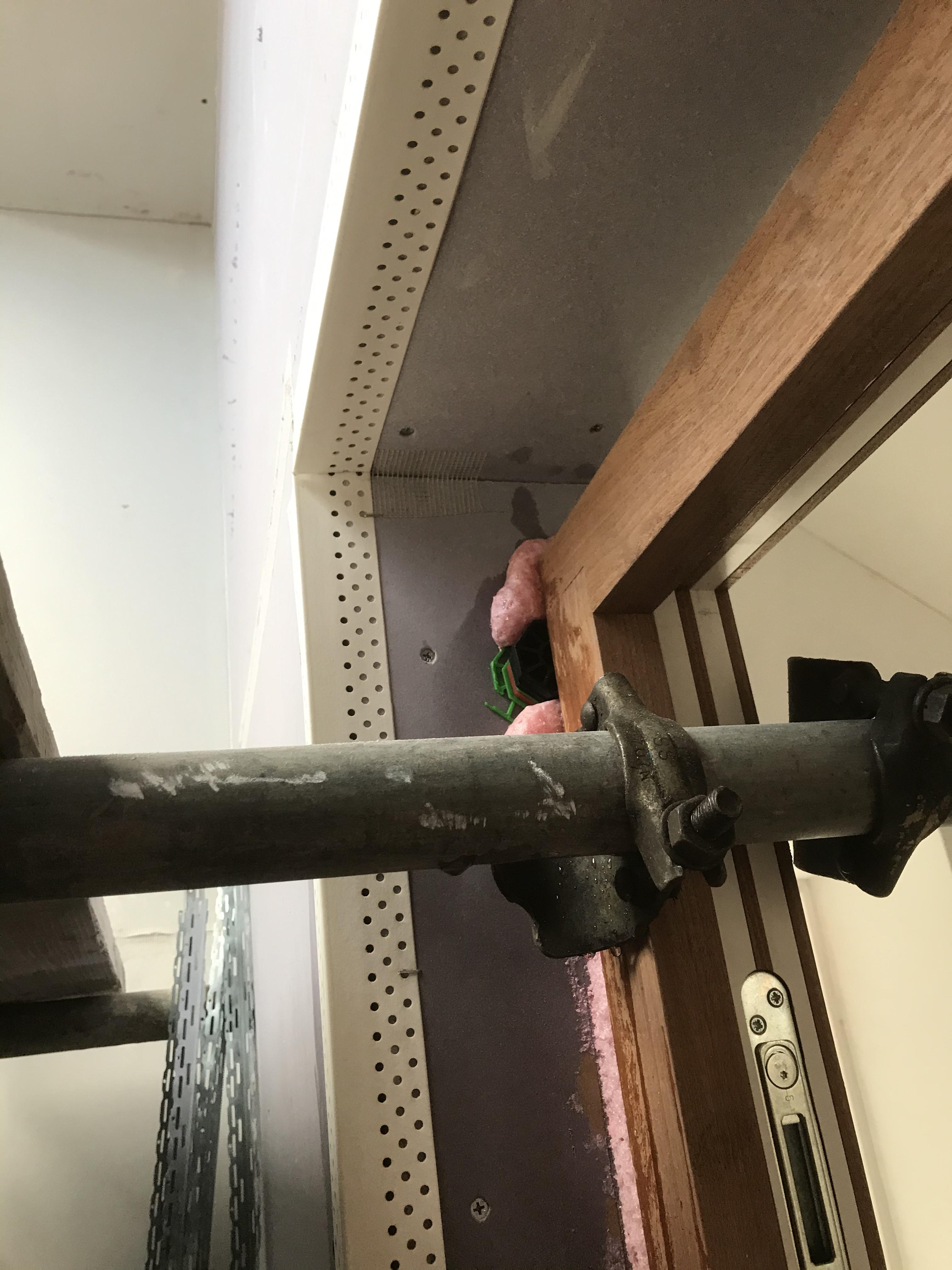

ToughButterCup Posted May 8, 2020 Share Posted May 8, 2020 Well Gary, gotta hand it to you. The only man IN THE WORLD who can put scaffolding through a pane of glass without breaking it. Link to comment Share on other sites More sharing options...
