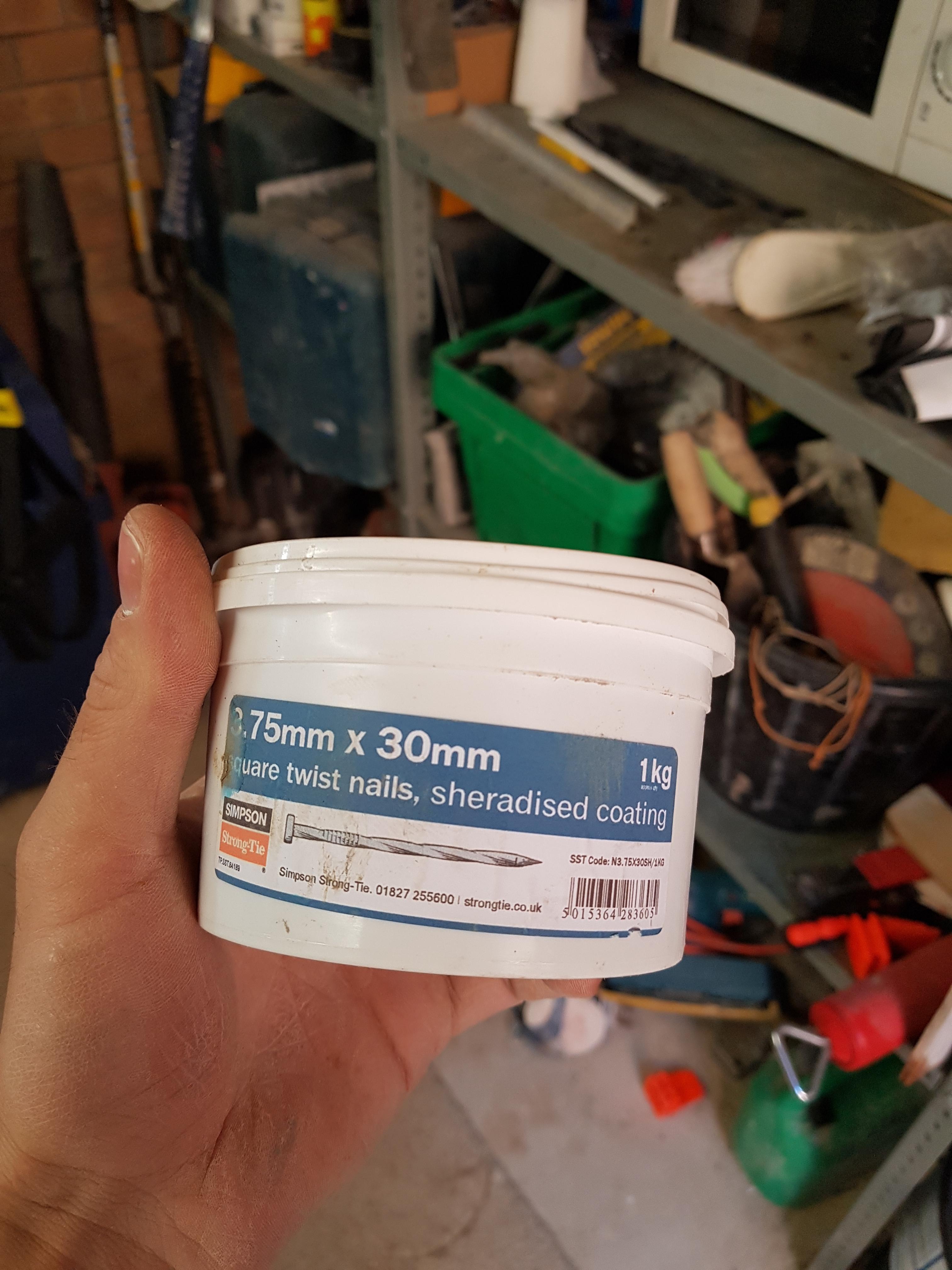

epsilonGreedy Posted May 6, 2020 Share Posted May 6, 2020 (edited) The trouble with 40-year timeserved experts is they have their own language for everyday things. I have to pick up two bags of nails for the z-clips that will be used for the perimeter noggins between my posi joists. The carpenter saids "clout" in one sentence and then "plasterboard" nails in the next sentence. Looking at the z-clips I reckon the pan heads would be better hence I should buy the clout nails on the Screwfix site, the "plasterboard" nails at Screwfix have tapered heads with the same profile as a counter sunk screw head. Which is preferred? Edited May 6, 2020 by epsilonGreedy Link to comment Share on other sites More sharing options...

Oz07 Posted May 6, 2020 Share Posted May 6, 2020 Always use square twist as that's what I get for any flooring hangers etc. You could get a bag of clouts and test him, if he goes to use these on any of your hangers bin him off. Link to comment Share on other sites More sharing options...
Russell griffiths Posted May 6, 2020 Share Posted May 6, 2020 Square twist nails, they are specified by the hanger company as the correct diameter for the load rating even though the z clips are not under a lot of load if you get the right nails and stick to them you won’t use the wrong ones when you have to put up a joist hanger. Link to comment Share on other sites More sharing options...

sean1933 Posted March 18, 2021 Share Posted March 18, 2021 I was just thinking about this same issue as about to fit my z-clips ... given twist nails have a fat head, wont they cause floorboards to ride on the nails and not sit flush on the joists? Clout heads usually a lot thinner...? Interested in first hand experiences. Link to comment Share on other sites More sharing options...
Hastings Posted June 3, 2021 Share Posted June 3, 2021 On 18/03/2021 at 11:24, sean1933 said: I was just thinking about this same issue as about to fit my z-clips ... given twist nails have a fat head, wont they cause floorboards to ride on the nails and not sit flush on the joists? Clout heads usually a lot thinner...? Interested in first hand experiences. I have just fitted noggins using Z-clips between metal-web joists around an entire upper floor deck, using square twist nails as specified by the engineer and by Simpson the manufacturer. The Z-clip metal is soft enough that the head of the nail, if hit hard enough, forms a depression in the Z-clip and the underlying softwood, so the nails don't stand proud. Link to comment Share on other sites More sharing options...
sean1933 Posted June 3, 2021 Share Posted June 3, 2021 13 hours ago, Hastings said: I have just fitted noggins using Z-clips between metal-web joists around an entire upper floor deck, using square twist nails as specified by the engineer and by Simpson the manufacturer. The Z-clip metal is soft enough that the head of the nail, if hit hard enough, forms a depression in the Z-clip and the underlying softwood, so the nails don't stand proud. Thanks for replying, I literally just finished laying my floor today and found exactly the same result... figured I didnt get a reply so would give it a go! ? Link to comment Share on other sites More sharing options...
