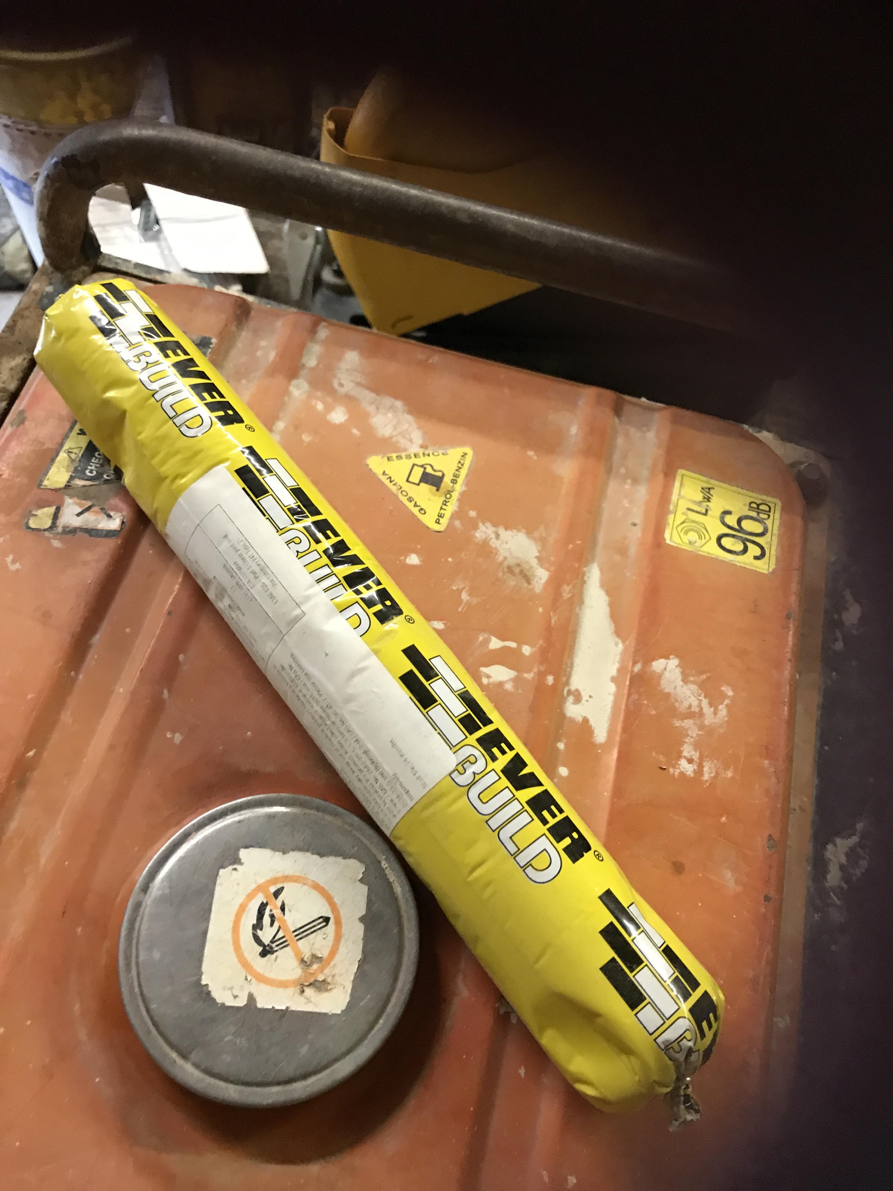

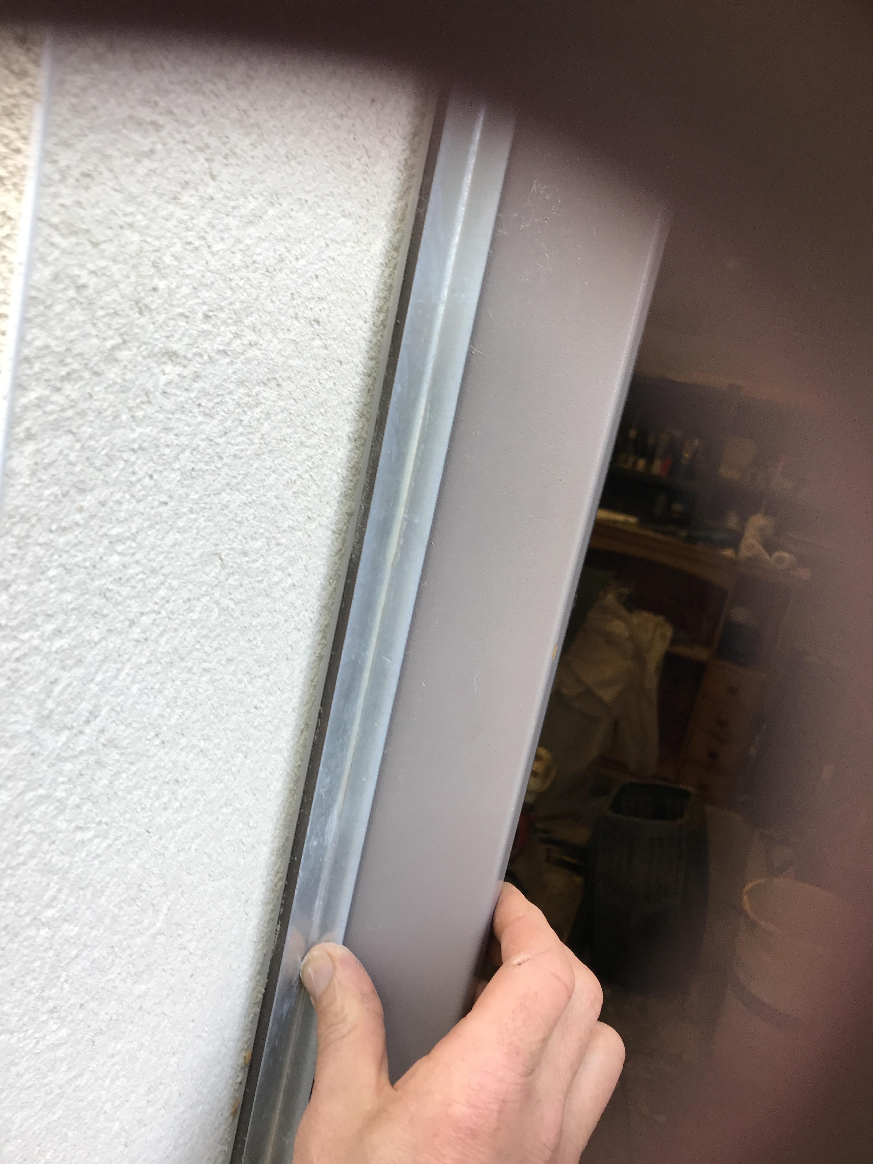

nod Posted May 3, 2020 Share Posted May 3, 2020 6 hours ago, tonyshouse said: Thermal board is just sheet insulation bonded to plasterboard I use sheet insulation then plasterboard. I was keen about air sealing too http://tonyshouse.readinguk.org/274-2/ All external edges should be sealed I know that most house bashers don’t bother but every commercial job I do has a band of gyprock sealant around the edges Even under floor track It really does help with air leakage Also around the window frames and the edge of the cavity closers we normally fix a 25 x 10 mil stainless angle to the frame 15 mil out and fill the edge This will help with cracking as dabbing directly onto cavity closers is a waste of to Prohibited on commercial and social housing Absolutely fine on mainstream spec houses Link to comment Share on other sites More sharing options...
