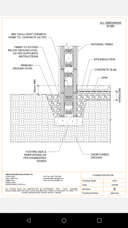

deuce22 Posted May 2, 2020 Share Posted May 2, 2020 Hi. I have had the bricklayer bring the blocks out of ground and we are now a couple of courses below DPC. He is going to revert from laying flat to a cavity like you normally would with block work, leaving the cavity open 225mm. If I now start using ICF on top of this, then the cavity will just fill, when I start filling the ICF with concrete. What is the correct way to construct the block work at DPC if I will be using ICF. Thanks. Link to comment Share on other sites More sharing options...
scottishjohn Posted May 2, 2020 Share Posted May 2, 2020 (edited) that detail should be on your drawings you still need a dpc --so no that wil need to be filled before dpc for the icf blocks to sit on what type of floor ? post up your plans ? Edited May 2, 2020 by scottishjohn Link to comment Share on other sites More sharing options...

Conor Posted May 3, 2020 Share Posted May 3, 2020 Normally you start the ICF one course below DPC level on top of your footings. You'd then use water proofer in your concrete for the below ground block and first course of ICF. This acts as your dpc. If your Brockie has no experience of using ICF, you're probably much better teaching yourself online and doing that part of the work. It's not at all like block laying. 1 Link to comment Share on other sites More sharing options...
scottishjohn Posted May 3, 2020 Share Posted May 3, 2020 (edited) you have a wall bracing system -for when you pour? that is not an option it is a must with poly block systems and as for the dpc what @Conor says is one way --again look at your detailed plans for this detail It would not be my choice of how to do it all depends on type of floor -is it a slab or supended Edited May 3, 2020 by scottishjohn Link to comment Share on other sites More sharing options...

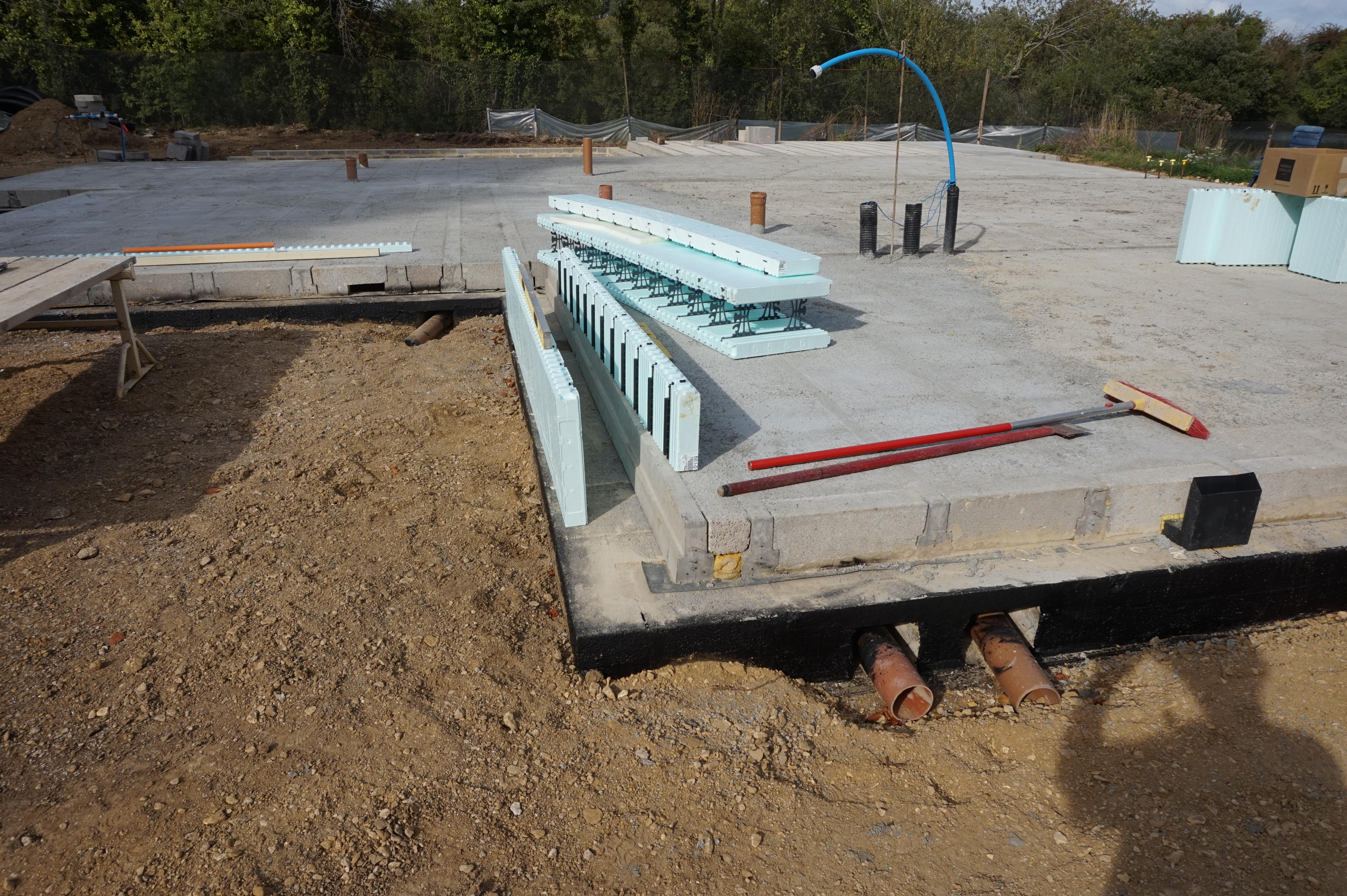

deuce22 Posted May 5, 2020 Author Share Posted May 5, 2020 On 03/05/2020 at 09:08, Conor said: Normally you start the ICF one course below DPC level on top of your footings. You'd then use water proofer in your concrete for the below ground block and first course of ICF. This acts as your dpc. If your Brockie has no experience of using ICF, you're probably much better teaching yourself online and doing that part of the work. It's not at all like block laying. I wish I knew this a couple of weeks ago. The bricky has been a pain, not very helpful and really bad mouthing ICF. I can see this being more straight forward if using a raft, but more complicated with strip foundations. I have come up to floor level with a block flat. I've been told to just lay the DPM up the inside wall and render as far down as I can, below floor level. There will be thermal bridging at that point, but it is a garage and the BCO isn't that concerned. My only concern is getting any damp. Do you think this will be good enough? Thanks. Link to comment Share on other sites More sharing options...
Russell griffiths Posted May 5, 2020 Share Posted May 5, 2020 You really need to sort out your details or this could turn into a bit of a drama if your icf is below ground level on the outside but above ffl on the inside then you will need an external waterproof layer or you will get moisture on the inside. I thought you are going to use the of walls of the garage to support the earth bank, in which case you will need to provide a method of keeping water out and the structure stood up right you need some cross section drawings showing finished ground level outside as well as finished floor level inside, only then can you sort a method to prevent water penetration. Link to comment Share on other sites More sharing options...
deuce22 Posted May 5, 2020 Author Share Posted May 5, 2020 I agree that this is slightly awkward and it's due to me changing my mind on the construction method. I will make sure that I have decided on what I will be doing for the house and have all drawings done way before. Regarding the retaining wall, I will discuss this with the SE beforehand, but have spoken with Jackon and they have suggested to use a waterproof concrete for the height that I need and then just fix DPM to the outside as well. I don't really understand what this means "if your icf is below ground level on the outside but above ffl on the inside". Can you explain it? Thanks. Link to comment Share on other sites More sharing options...
