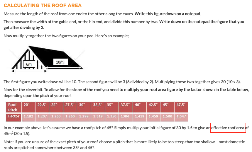

Russdl Posted April 30, 2020 Author Share Posted April 30, 2020 @Mr Punter Exactly. Using the following calculation: Length of Roof x (Width of Gable/2) x 1.419 (for our 40° roof pitch) I get 100m2 so I recon I need 2m3 of soakaway, not 6.8M3, but before I have a word with Building Control about this and explain that I think the Architect has got it wildly wrong I want to make sure I'm not missing anything. Link to comment Share on other sites More sharing options...

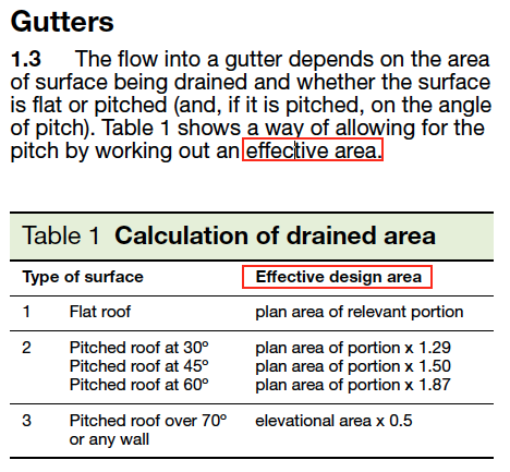

Russdl Posted May 1, 2020 Author Share Posted May 1, 2020 The first stumbling block in the Regs is the phrase 'Effective Design Area' I can't find a definition of it anywhere What is the 'effective design area'? Drainagepipe.co.uk clearly define it (aimed squarely at the innumerate) and it's what I'm using to convince myself that I only need 2m3 of soakaway. Does anyone know any different? Link to comment Share on other sites More sharing options...

Temp Posted May 1, 2020 Share Posted May 1, 2020 17 minutes ago, Russdl said: The first stumbling block in the Regs is the phrase 'Effective Design Area' I can't find a definition of it anywhere What is the 'effective design area'? Drainagepipe.co.uk clearly define it (aimed squarely at the innumerate) and it's what I'm using to convince myself that I only need 2m3 of soakaway. Does anyone know any different? I think that's telling you how to calculate the effective collecting area. Lets say your house had a footprint/plan area of 1000sqm and a weird roof that was half flat and half had a 45 degree pitch the effective area would be 500 + (500*1.5) = 500+750 = 1250sqm. Link to comment Share on other sites More sharing options...
Russdl Posted May 1, 2020 Author Share Posted May 1, 2020 @Temp Surely that can't be right though can it, to have an effective roof area that is 25% bigger than the actual roof area. That extract from the drainage pipe website that I posted above would give an effective roof area of 750m2 for a conventional 45° roof of 1000m2 plan, so only 75% of the footprint. Link to comment Share on other sites More sharing options...
