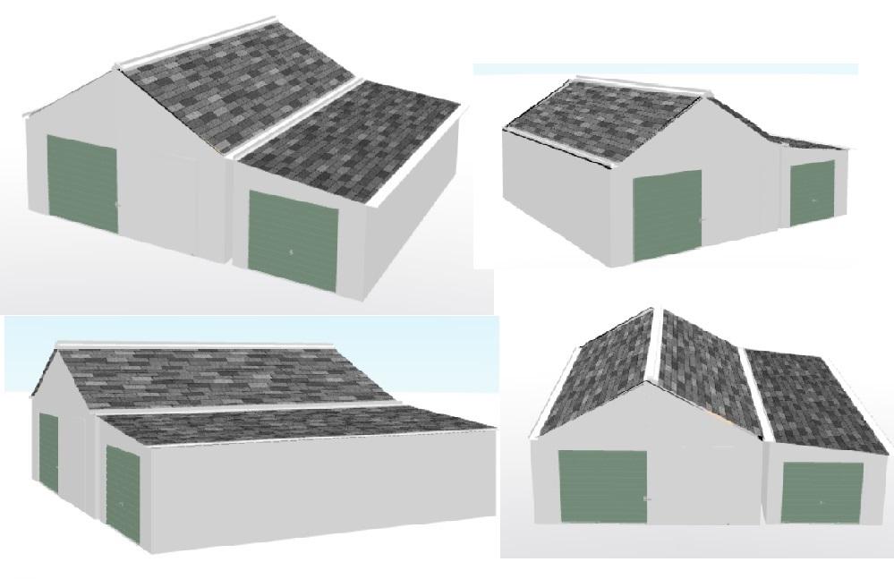

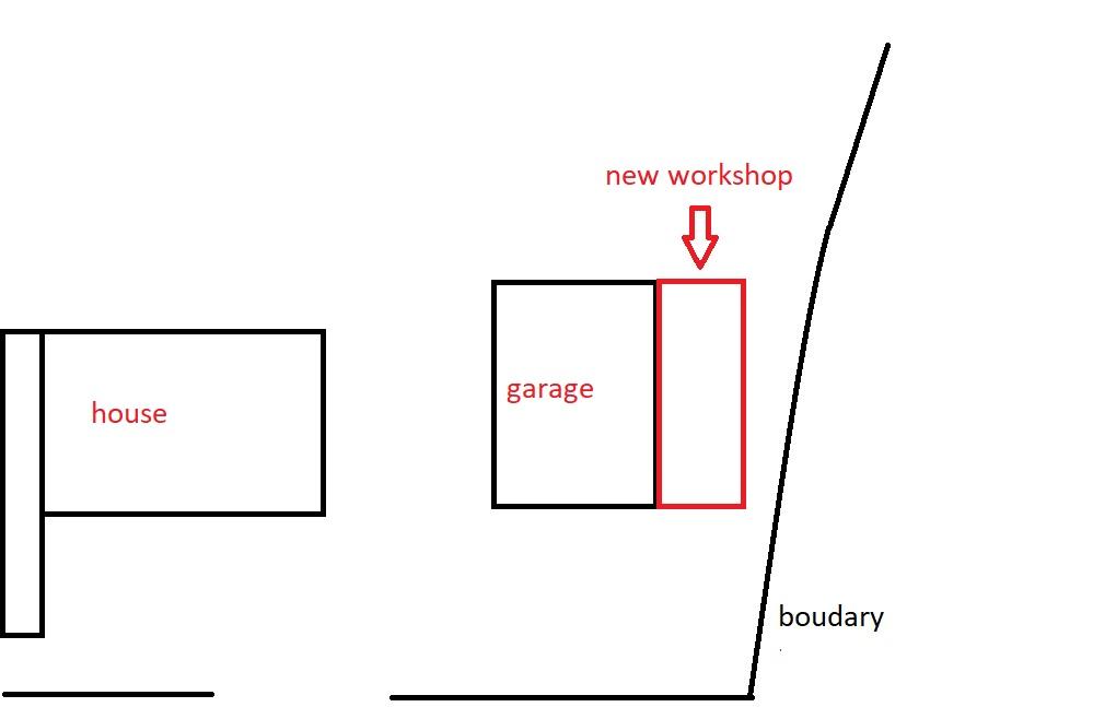

starbuckhouse Posted April 28, 2020 Posted April 28, 2020 I have a 9m x 6m detached garage that is 7 m away from the side of my house. I would like to build a wooden shed/workshop along one side of the garage, (furthest from the house) I would like it to be 9m x 3m, concrete floor and timber sides with roofing sheets. it will be attached to the garage wall but a separate building with its own access. The new workshop will be just over 2 m from the property boundary. 2.4m at the highest point and approx. 2m at the eves. Do I need planning or building regs to do this? thanks for any info offered
Jeremy Harris Posted April 28, 2020 Posted April 28, 2020 Welcome. Whether or not you need planning consent depends on a few factors. Does your house still have Permitted Development rights? Most will, but sometimes these are either removed as a planning condition, or are restricted because of the house being somewhere like a Conservation Area, AONB, National Park, etc. Assuming that you do have PD rights, then the Planning Portal has a pretty good guide on how to determine whether or not planning consent may be needed: https://www.planningportal.co.uk/info/200125/do_you_need_permission Whether you need Building Regulations approval depends on the area of the building, and the use to which it's being put. Again, the Planning Portal has some useful guidance: https://www.planningportal.co.uk/info/200130/common_projects/43/outbuildings/2 1

DevilDamo Posted April 29, 2020 Posted April 29, 2020 11 hours ago, starbuckhouse said: The garage has been there about 4 years, house is a few hundred years old. Having looked at the info on the planning portal, I couldn't find clear advice on outbuildings attached to other outbuildings. My local council planning dept are not approachable, last time I asked for advice for a different project they just said to put in a pre application, which I did then a while later they said I would need to submit planning application to find out for sure, and that was just for a porch. This is why the Planning Portal isn't the best thing for you because it doesn't go into detail for these kind of situations. In my opinion and if you were to attach a building to an existing outbuilding, the buildings 'together' would need to comply with the PD rules... if you were looking to go down that route. In that respect, the building as a whole would need to have eaves no higher than 2.5m and an overall height that does not exceed 3m. For a dual pitched roof, the overall height is increased to 4m but I do not think the LPA would consider the resulting design as a dual pitched/gable roof. You mentioned the overall height of the extended part would be 2.4m so does that imply the overall height of the existing Garage may exceed 3m? In terms of Building Regulations, they may also look at it as an outbuilding. Under their guidance, any outbuilding that exceeds 30sq.m in (internal) floor area require a BR application. If you were to physically separate the workshop from the Garage, I think you could get that through PD as well as being exempt from BR's. That is why on another forum, I mentioned to you about providing a gap of approx. 300mm. I know this isn't ideal as it means more excavation and another new wall but if you are wanting exemption, then this may be the only way to go. A 300mm gap isn't great for access and could provide an area for bits and pieces to gather but there'd be no harm in sealing off the gap at the head in order to help prevent this. Just out of interest, what are your reasons in wanting to try and avoid seeking Planning and Building Regulation approvals? I can't see any issue why you wouldn't secure approvals anyway.
starbuckhouse Posted April 29, 2020 Author Posted April 29, 2020 (edited) 4 hours ago, DevilDamo said: This is why the Planning Portal isn't the best thing for you because it doesn't go into detail for these kind of situations. In my opinion and if you were to attach a building to an existing outbuilding, the buildings 'together' would need to comply with the PD rules... if you were looking to go down that route. In that respect, the building as a whole would need to have eaves no higher than 2.5m and an overall height that does not exceed 3m. For a dual pitched roof, the overall height is increased to 4m but I do not think the LPA would consider the resulting design as a dual pitched/gable roof. You mentioned the overall height of the extended part would be 2.4m so does that imply the overall height of the existing Garage may exceed 3m? In terms of Building Regulations, they may also look at it as an outbuilding. Under their guidance, any outbuilding that exceeds 30sq.m in (internal) floor area require a BR application. If you were to physically separate the workshop from the Garage, I think you could get that through PD as well as being exempt from BR's. That is why on another forum, I mentioned to you about providing a gap of approx. 300mm. I know this isn't ideal as it means more excavation and another new wall but if you are wanting exemption, then this may be the only way to go. A 300mm gap isn't great for access and could provide an area for bits and pieces to gather but there'd be no harm in sealing off the gap at the head in order to help prevent this. Just out of interest, what are your reasons in wanting to try and avoid seeking Planning and Building Regulation approvals? I can't see any issue why you wouldn't secure approvals anyway. thanks for the advice, reason is mainly to avoid costs and time. Edited April 29, 2020 by starbuckhouse 1

DevilDamo Posted April 29, 2020 Posted April 29, 2020 @joe90 My theory is if you are joining onto an existing outbuilding, then the resulting outbuilding, i.e. existing and new would have to comply with the PD rules. This is where in this case the OP may have to check the existing garage in addition to the workshop extension complies with the heights, etc... With the workshop having a lean-to roof design and the garage having a gable roof, I don’t think you could argue the outbuilding would have a dual pitched/gable roof. This is why I think the overall height of the resulting outbuilding is limited to 3m, i.e. any other roof.
joe90 Posted April 29, 2020 Posted April 29, 2020 (edited) 9 hours ago, DevilDamo said: The garage has been there about 4 years, house is a few hundred years old. so @starbuckhouse was the garage built with planning permission or PD.? 52 minutes ago, DevilDamo said: My theory is if you are joining onto an existing outbuilding, then the resulting outbuilding, i.e. existing and new would have to comply with the PD rules. hence my question above. If it was built under PD the addition is not taller or fails the PD rules in any other way as a whole. 52 minutes ago, DevilDamo said: My theory yes, theory, I personally know how disjointed and ambiguous planning rules are, it took a planning appeal on my part to prove my planning department were not interpreting the rules correctly which if written properly would not be ambiguous, which they are in many cases. Edited April 29, 2020 by joe90

starbuckhouse Posted April 30, 2020 Author Posted April 30, 2020 The original garage is 4m tall, it had Planning and BR on it when it was built.
joe90 Posted May 1, 2020 Posted May 1, 2020 10 hours ago, starbuckhouse said: The original garage is 4m tall, it had Planning and BR on it when it was built. so it’s only the additional lean to that’s PD.
DevilDamo Posted May 1, 2020 Posted May 1, 2020 @joe90 I'm trying to think how or why it would make any difference if the garage did or did not have full Planning? If the garage was attached to the dwellinghouse, then Class A would apply but the fact it's detached, Class E applies irrespective of its Planning history... or am I reading this wrong? This is why I was under the impression for any building that is to be physically attached to an outbuilding, the PD rules for Class E would apply to the resulting building(s). With the garage having a maximum height of 4m, this would be ok providing the LPA agree the resulting building(s) have a dual pitched/gable roof because if not, the overall height is limited to 3m. In terms of Building Regulations and again, if they too treat the building(s) as outbuildings then as the resulting internal footprint would exceed 30sq.m, then BR's would apply!?! Because this is not that clear and the online guidance doesn't go into detail for such individual cases, I feel the only option is for the OP to submit an application... trying with a CoL first. If this is refused, then the OP would have to submit a HH application, which would result in application fees totalling £309.00. Or the OP just proceeds with the submission of a HH application for £206.00 and get it approved... which I can't see initially why they wouldn't do anything but.
joe90 Posted May 1, 2020 Posted May 1, 2020 On 29/04/2020 at 21:22, Roger440 said: Class E – Buildings etc. (outbuildings) This allows for an outbuilding to be erected within a residential curtilage as long as it is sited behind the principal (often the front) elevation, does not cover more than 50% of the curtilage and is not more than 3m in height (4m for a dual-pitched roof; 2.5m where within 2m of a boundary). this garage is not PD, the lean to workshop is (class E above applies) no where does or state the “outbuilding must be stand alone “. 7 minutes ago, DevilDamo said: Class E applies irrespective of its Planning history.. No, the garage has planning permission, the lean too (if it were me) would be built under PD. If the garage were PD then the planners might take into account the whole building now being PD but It still would fit all regs. Its @starbuckhouse call but as far as I can see his case to build under PD is very clear. Frankly, as others have said elsewhere the planners will tell you to apply as it’s Income. I have been through this loop many times. 2
Jeremy Harris Posted May 1, 2020 Posted May 1, 2020 I agree, if something like a garage has been built with PP, then any addition to it that's within the PD rules could be built under PD. There's no rule about grossing up the areas of an existing building with PP and that of an extension to it under PD, AFAIK. I went through this some years ago with a detached garage that had been built without PP, where I applied for a certificate of lawfulness, which was granted, then built an extension to the garage under PD, which was fine, as the certificate of lawfulness was considered to have the same standing as if the garage had been built with PP. In this case I only discovered that the garage had been built without consent when I sought advice about whether the extension to it came within the PD rules, it was the planners who advised as to the course of action to take to regularise things (before the days when they were chasing every bit of income they could). 2
