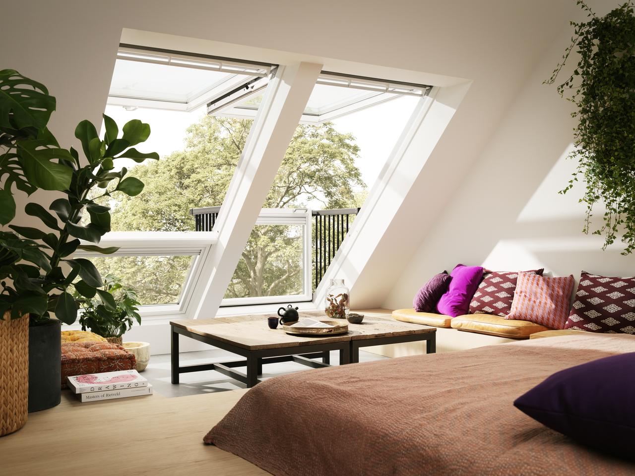

Does anyone have experience with Velux Cabrio windows [video]?
- Are they actually nice, or is it a gimmick you'll never actually use?
- Is the glass above you annoying?
- Does it feel scary?
- Do neighbours (or planning permission teams) complain about them? (privacy?)
- Any downsides when you are NOT using them in cabrio mode?
- Easy to clean?
etc etc
Was  expensive when we looked at it.
We fitted three big top hung velux windows.
I'm 6'3 and I can just stand outside when the window is open, but this might depend on the pitch of the roof and where the roof windows are placed.
I originally wanted a balcony, but this was a lot cheaper, ultimately I just wanted to enjoy the view whilst feeling outside.

So 'standard' ones, not with the balcony effect? I'm trying to figure out in my head what the difference in experience is. I think.. effectively you are not standing further outside your house, it just feels a bit safer?
Good  point, I'm 6'4 - so indeed the top of the window needs to be pretty strategically placed then..

Here is how they look inside. Need to consider fire safety when positioning as they can act as a escape window as well.
We considered them for our rooms in roof.
Quite expensive and IIRC not available in the triple glazed near passive spec (prob quite leaky from an airtightness perspective also).
Anyway, planners explicitly outlawed them in the approval conditions for privacy reasons.
We went with a very large top hung Velux in each room (SK10) and are very happy with it.

Outlawed.. interesting part for me is that I see almost no difference between where you would stand between standard top-hung and cabrio. I assume with cabrio you can stand maybe 30-40cm forward but I wouldn't consider this meaningful enough to outlaw?

Yep, I think the planner's issue was overlooking, as there's no means to enforce privacy to the sides.
Our rear bedroom balconies had to have full height opaque glass to each side that faced neighbours.
These balconies can be installed under PD providing they comply with the PD guidelines. So in most cases, they have nothing to do with Planning or potential neighbourly concerns.
Only if installed to new habitable rooms at first floor level.
