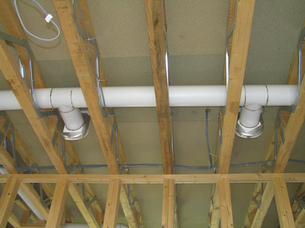

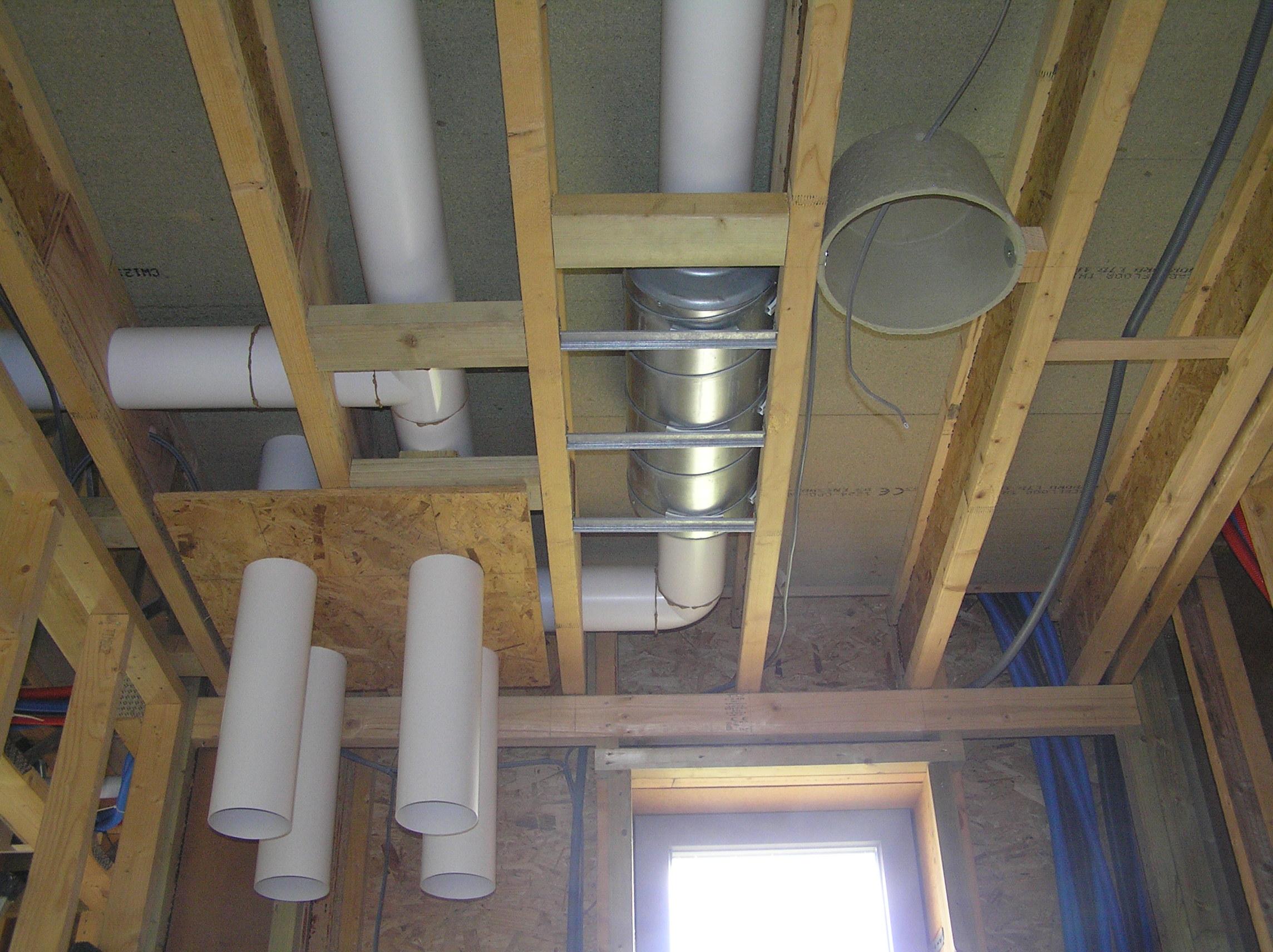

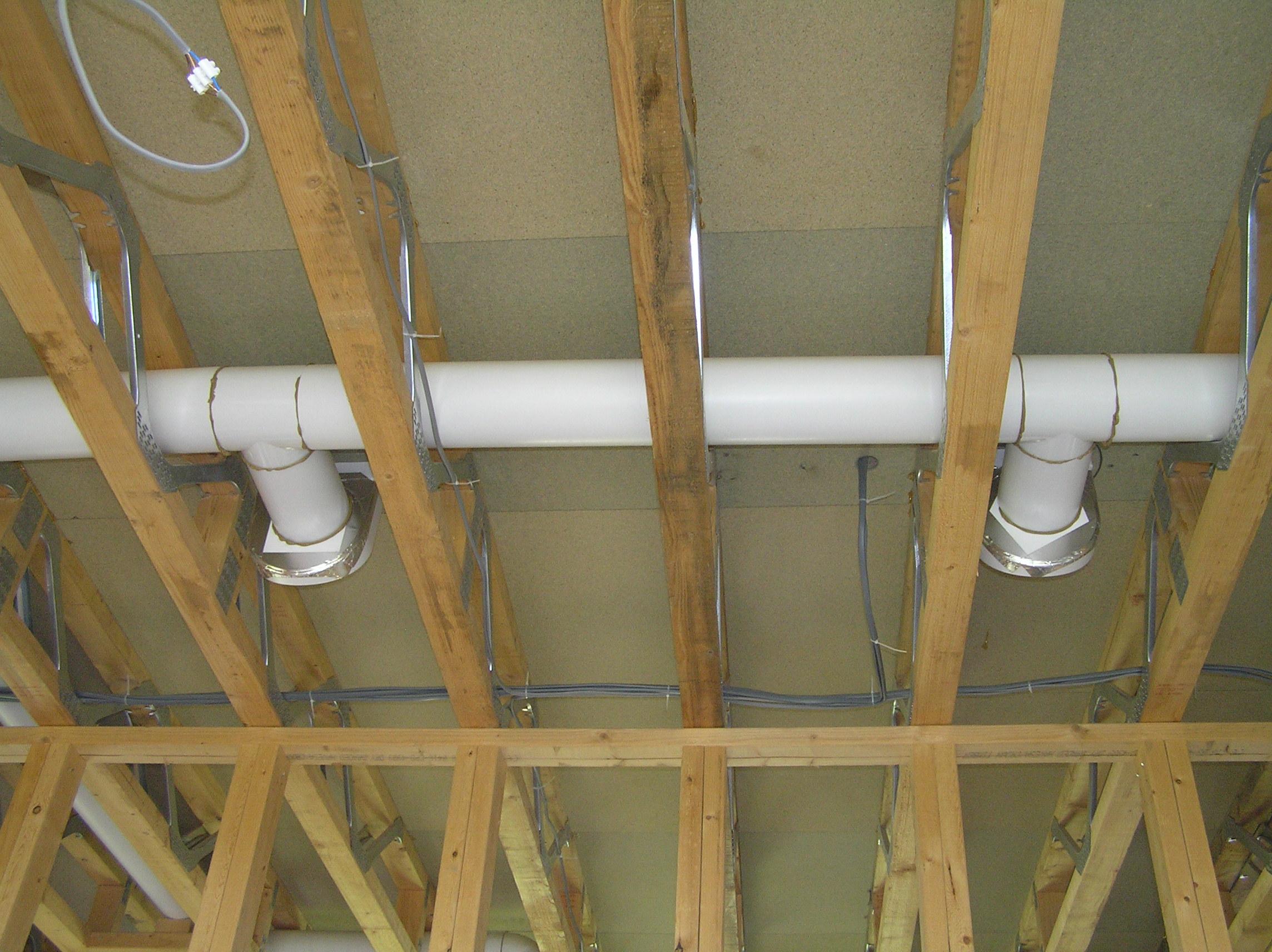

Gone West Posted April 14, 2020 Share Posted April 14, 2020 @Mr PC We designed our MVHR system ourselves and used a branched layout with plastic ducting. It was straightforward and has worked well. It doesn't require space for manifolds but does need space for straight runs of ducting so works well with metal web joists. Link to comment Share on other sites More sharing options...

gc100 Posted May 11, 2020 Share Posted May 11, 2020 On 14/04/2020 at 09:00, PeterStarck said: @Mr PC We designed our MVHR system ourselves and used a branched layout with plastic ducting. It was straightforward and has worked well. It doesn't require space for manifolds but does need space for straight runs of ducting so works well with metal web joists. It looks like you don't have any sound attenuators - won't you get cross talk from room to room? I'm looking at this now, and due to space and length of my build a branch layout would be better, however my gut is telling me a radial would be more easy and less prone to noise. @Stones comment about noise is surprising though 1 Link to comment Share on other sites More sharing options...
Gone West Posted May 11, 2020 Share Posted May 11, 2020 6 hours ago, gc100 said: It looks like you don't have any sound attenuators - won't you get cross talk from room to room? The only attenuator we have is on the supply side as shown in the first picture. There is a very small amount of fan noise on the extract side if you are near an extract vent. I didn't think it was worth fitting an attenuator on the extract side but if I was doing it again I probably would fit one. We haven't experienced any cross talk from room to room. 1 Link to comment Share on other sites More sharing options...
