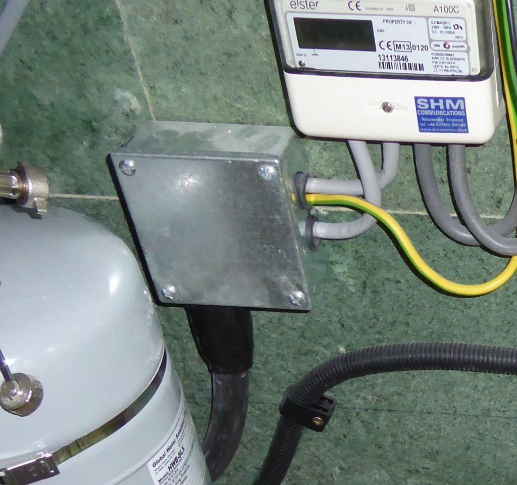

Jeremy Harris Posted April 8, 2020 Share Posted April 8, 2020 8 hours ago, DaveSpils said: @Jeremy Harris could I ask a favour of you please? Do you have a picture/example of an adaptable box with a Henley block (or similar) showing one incoming SWA and 2 outgoing SWAs? I have searched for one and cannot find any. Does the Henley block get fixed inside the box or is it loose? Is there another solution to this? thanks Dave I don't have a photo to hand, but I've done it in the past and it's easy enough. just fit glands in the box for the SWA and fix a couple of Henleys and an earth block inside, screwed through the back to the base board. Needs one of the larger adaptable boxes so there's enough room, but easy enough to do. I always tend to use piranha nuts on SWA glands now, as they are a lot easier than faffing around with brass banjos. 1 Link to comment Share on other sites More sharing options...
Jeremy Harris Posted April 8, 2020 Share Posted April 8, 2020 Just found this photo showing a bit of 25mm² SWA terminating in a small 4 x 4 adaptable box, with tails fed out to the CU. There's no Henleys inside, just an earth block to terminate the armour and cable CPC and allow a 10mm² CPC to be fed out to the CU, along with the sleeved live cores from the SWA. Worth noting that there's a slot cut between the two grommets where the tails come out, to break the magnetic circuit that would otherwise be formed by the steel of the box. The meter in this photo is a private one, not the suppliers. Link to comment Share on other sites More sharing options...
DaveSpils Posted April 8, 2020 Author Share Posted April 8, 2020 Thanks for the picture. I understand that at Barn 2 would look similar to this as the SWA is terminated. I just cannot envisage what it would look like inside the adaptable box for where I have a Henley Block. Is there a fixing for a Henley Block inside the adaptable box? Sorry to labour the point. Here is what I think is needed: I just looked at the Piranha nuts too - much easier. Link to comment Share on other sites More sharing options...
Jeremy Harris Posted April 8, 2020 Share Posted April 8, 2020 Best to use 3 core SWA if exporting the PE, IMHO. That way there's a high degree of integrity in the connection, as it's not reliant on the galvanised steel wires always providing a very low impedance connection. If the installations are going to be wired with earth electrodes, as TT, then the CPC from the CU in that diagram would go to the earth electrode and the armour CPC would be isolated from the installation. Inside the box (would need to be a reasonably big one) you'd just have two Henleys (one for line, one for neutral) plus an earth block. The earth block needs enough ways to accept the various CPCs, so for the set up above it would need 5 ways. If really stuck for space you could use a double decker Henley, but personally I'm not a great fan of them, and much prefer to keep the line and neutral terminations separate. 1 Link to comment Share on other sites More sharing options...
