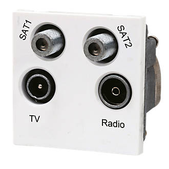

Tony K Posted April 1, 2020 Share Posted April 1, 2020 (edited) Hi I am drawing up the plan for lighting, switches and sockets for the new build at the moment. Two separate questions.. 1. What do I need to require of the electrician in terns of meeting Part R of the Building Regs (i.e. the requirement that I must provide physical infrastructure to allow high speed electronic communication networks - or 'the internet' as it is more commonly known)? 2. Do I need a coax cable socket connected to a TV aerial and/or satellite dish in this day and age? My instinct is that such things must be out of date and unnecessary by now, replaced by wi-fi based TV. However, recently something has gone wrong with the coax / aerial in our existing house, and the BT TV box (which remains connected to the wi-fi) can only allow me access to apps rather than the full channel list, making me think the humble aerial remains essential... Thanks! Edited April 1, 2020 by Tony K Link to comment Share on other sites More sharing options...

ProDave Posted April 1, 2020 Share Posted April 1, 2020 41 minutes ago, Oz07 said: Why 3 separate coax @ProDave? Provision for 1 terestrial feed and 2 satellite feeds e.g. for a sky or freesat box. Link to comment Share on other sites More sharing options...
MrMagic Posted April 1, 2020 Share Posted April 1, 2020 (edited) Look at quadplexers - 2x sat + terrestrial + FM/DAB all down a 'shotgun' pair of coax (i.e. 1 cable) I've run this + 2xcat5e to each "point" in a room. The main living space 1+2 and office all have this + quad cat5e. HTH. R. Edited April 1, 2020 by MrMagic Link to comment Share on other sites More sharing options...

ProDave Posted April 2, 2020 Share Posted April 2, 2020 I don't like those quadplexers. they won't work for instance with the wideband LNB's now used for Sky Q for example. No substitute for extra cables. Link to comment Share on other sites More sharing options...
MrMagic Posted April 2, 2020 Share Posted April 2, 2020 1 hour ago, ProDave said: I don't like those quadplexers. they won't work for instance with the wideband LNB's now used for Sky Q for example. No substitute for extra cables. As soon as I posted that I thought, Sky-Q, doh! Not a Sly household here, just simple freesat. At the very least tho, you have the cable in the wall and can switch out the equipment on each end. Link to comment Share on other sites More sharing options...
