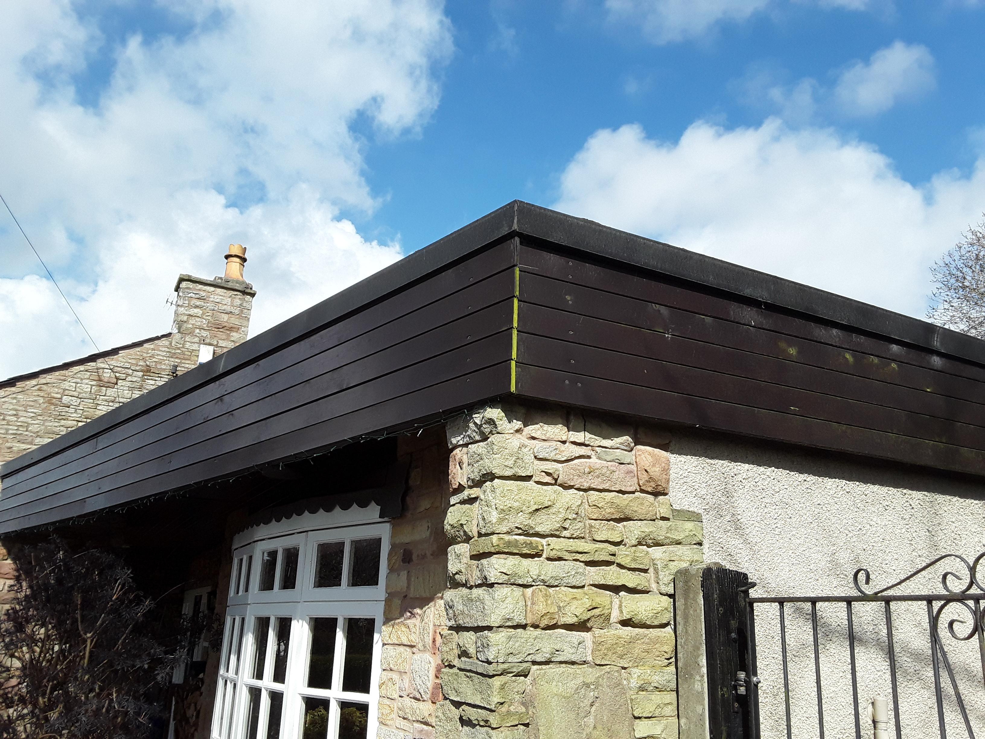

I used Sadolin Classic stain on cladding that covers parts of our extension. The cladding was replaced in 2012 and I had to re-coat the west-facing part last year. The south-facing section, which is shaded by a large beech, still looks OK, but could now do with a clean as it's starting to go green!
So about 5 years between coats then? Thats about the same for barn paint I think.

Don't know how good this picture will be, but the cladding on the right side hasn't been recoated since it (the wood) was replaced 8 years ago. Had to recoat the left (west-facing) section last year, after seven years.

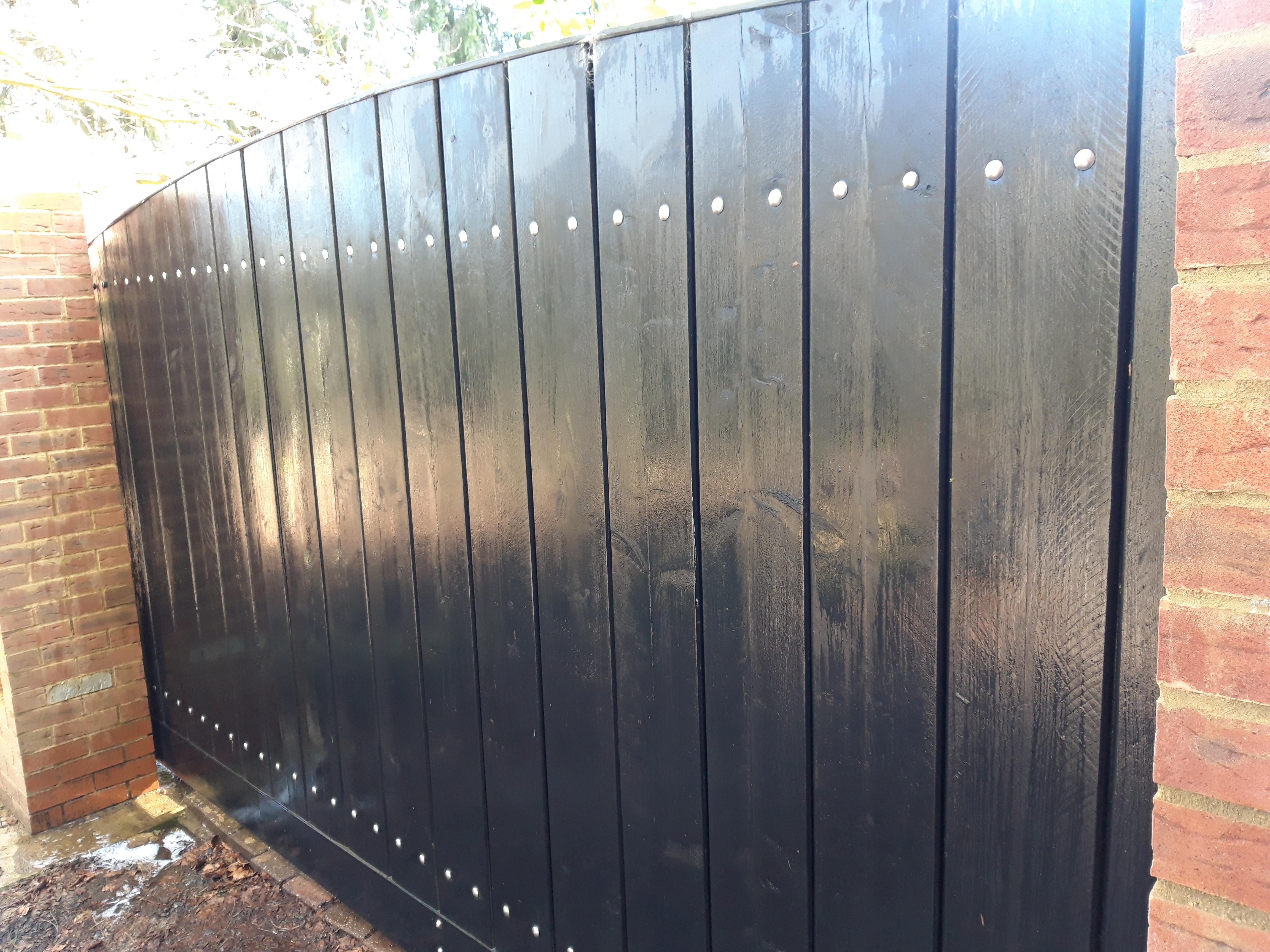

Bedec satin black barn paint on my gate 6 years now. 3 coats on new, reject scaffold boards. Even the 1st coat covered like magic.
Then:
SAM_8559
SAM_8560
Just now (after a wash for the photoshoot, bird sh!t really shows up on black ?):
Before Bedec I was a Sadolin man. Always thought it took too long to dry. With Bedec you can get 3 coats on in a day and it's water based.

@Onoff is there a thread for your gate? Is it a slider? What did it cost you?
It is a slider. No thread per se on here. It's just a frame I drew up and paid to have fab'd up and galvanised by my long term fabricator.
I'd do it different next time as the upturned channel is a magnet for leaves and beech nuts.
Think it was around £250. Sliding gate kit came from Easy Gates another £500. Posts were freebie scrap. Rails from Barrier Components in Thurrock. Never really tallied the cost. Here's a Flickr link, only 346 photos to wade through! ?

On my recommendation a mate used Bedec Barn Paint on his previously painted fence and gate. He wasn't impressed as despite keying the surface it didn't seem to take. We tried it here too on a previously wood stained / pu varnished door. It covered OK but seems easy to scuff and chip.
On new or previously untreated wood though it's brilliant imho.
