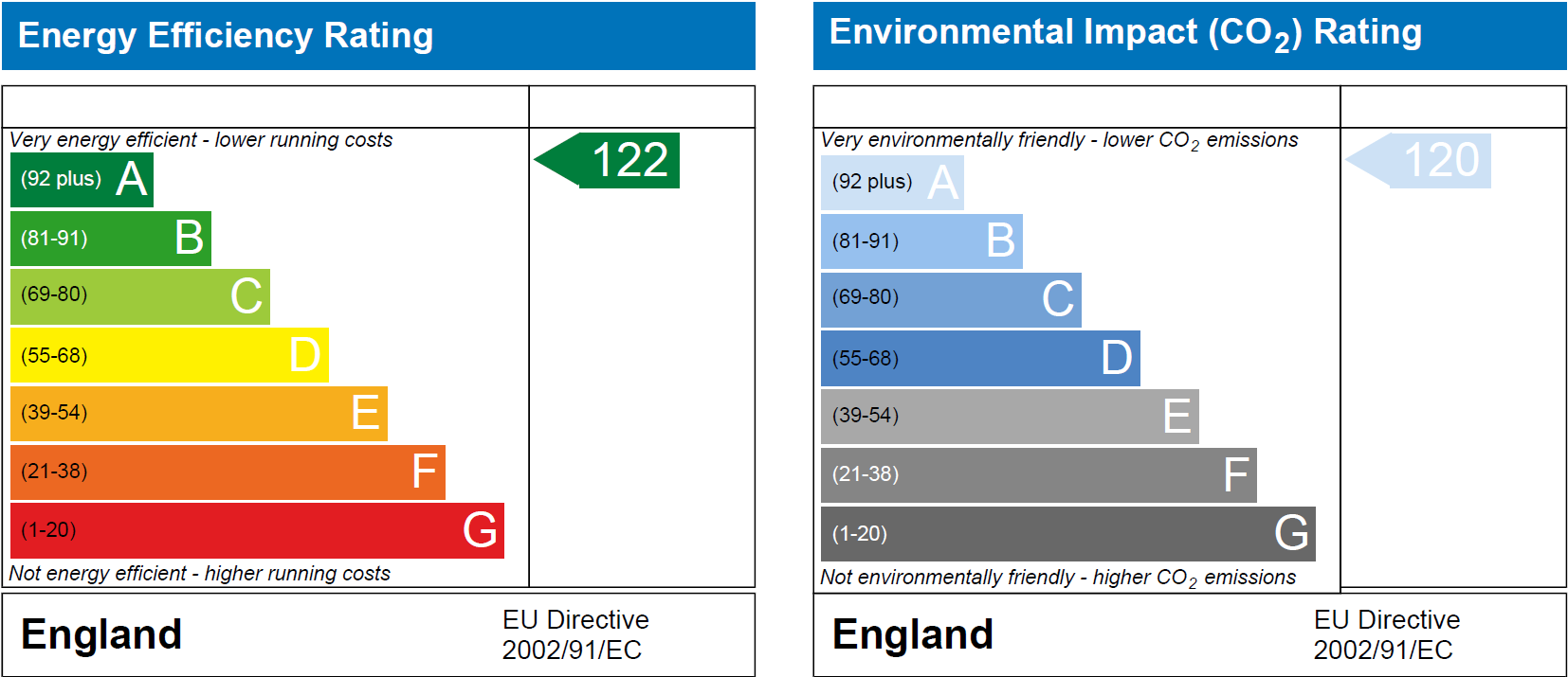

I now have my As Designed SAP grades ready for building control submission:
Even better than my calculations and this is from the official SAP assessor!
I am sure something will change (reduce the PV on the roof for example) but it is a good starting point.
