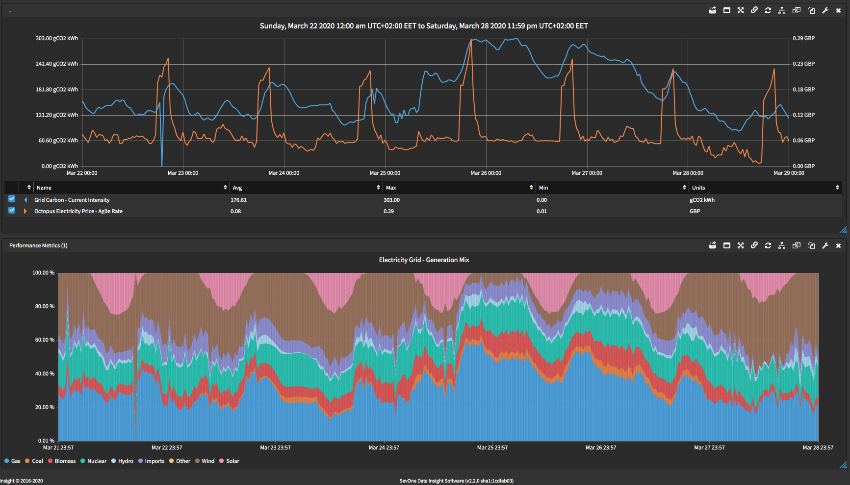

MrMagic Posted March 31, 2020 Posted March 31, 2020 Heres a very basic attempt at Agile Cost Vs Grid Carbon Vs Grid Generation Mix. It looks like demand 'swing' is probably the biggest cost contributor. (Ignore the TZ in the top graph, need to update my code to handle BST)
